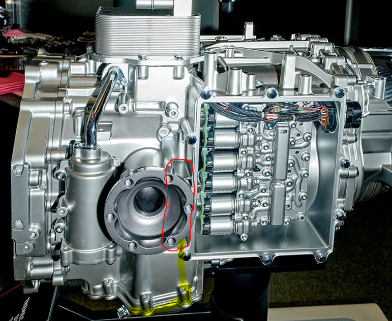

Could be from someone that spilled oil when filling engine oil too, was the oil more on the driver side? From what I have seen, several owners that have had porosity issues had no residue on their garage floor, but the pan was covered in a light film. Presumably it is getting pulled out when driving, but others have had major amounts of oil and some on the ground under car as well.
No idea to know how much DCTF is left until pressures drop enough for a sensor / problem code to be thrown. There is a fill level check on the side where level can be checked as well as fluid filled, but this isn't easy to accomplish while on the road. Best to take it to a Chevy dealer.
This is the problem area that has previously been identified:
It's in the deep recessed area behind the output shaft on drivers side. The yellow highlighted areas are where you may have DCTF running down.
thx for the info! Hoping that it's old oil from a crummy oil change. I could definitely deal with that. Appointment on the 16th so I'll update soon.
