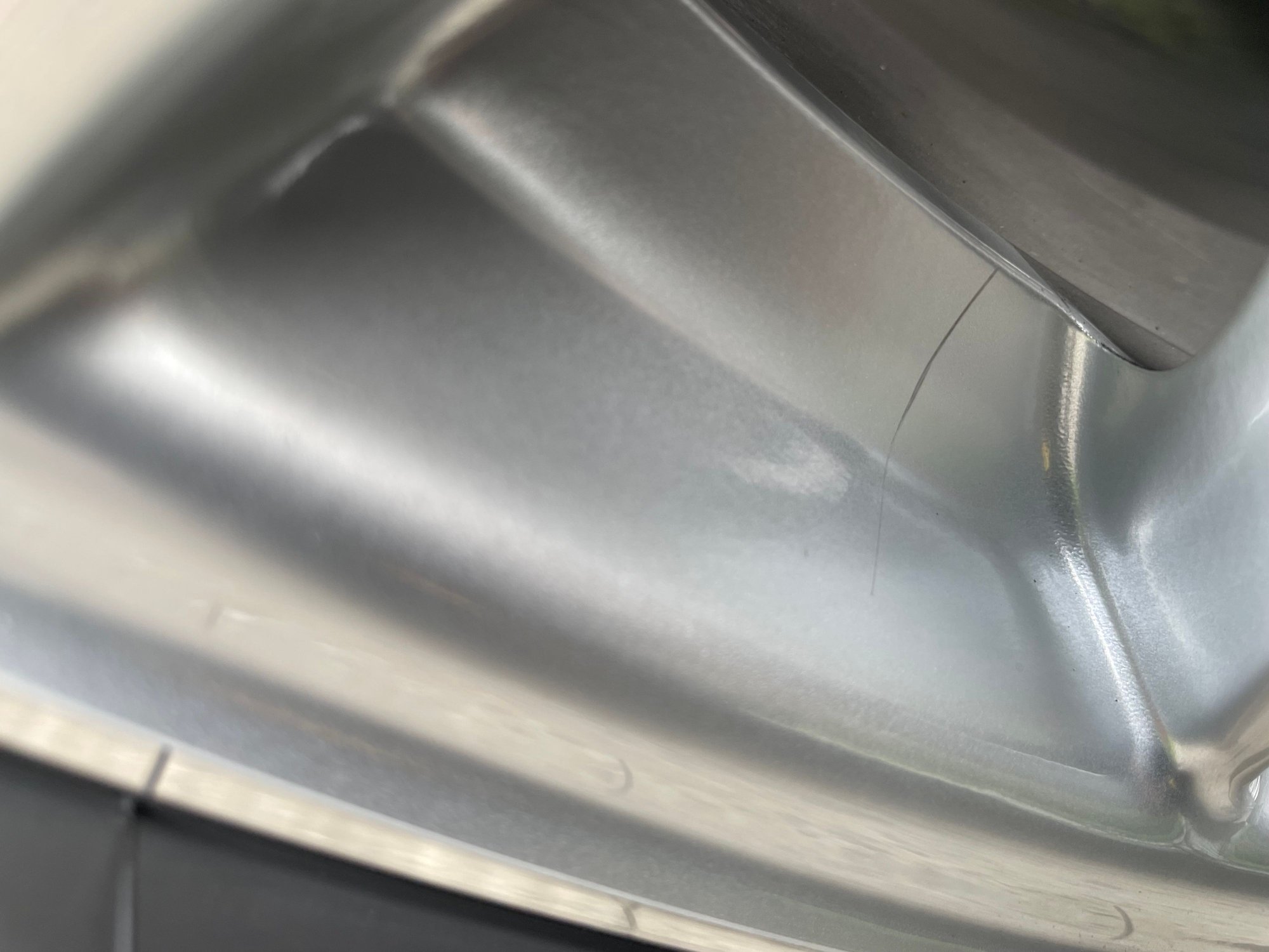

Apparently the Trident wheel cracking issue that has plagued 2020-2022 MY's has now been found on 2023 vehicles. Anyone else have this issue?

Just wondering.....are these forged wheels? I'd think cracking would be more prevalent with wheels that were just cast. But apparently forged aluminum aircraft parts are often X-rayed so I guess forged stuff can crack also.

I believe they are cast.

Can you tell how deep the "crack" is? It may just be a crack in the coating. And it's in a completely different part of the wheel than where the C7's are cracking.
So far still holding air, going to dealer on Monday.

Looking at the flat surface with a strong light where my yellow arrow is pointing, you should be able to see if it's through the aluminum.
And with soapy water on the crack to see if it's leaking air at all.

Thanks for the suggestions. The crack is still tight and doesn't allow me to see below the surface using a spotlight. The view from the top doesn't show a deep fissure through to the aluminum and the wheel is not leaking. Fingers are crossed.

Still, that’s unacceptable. One hard bump and it could be gone.
