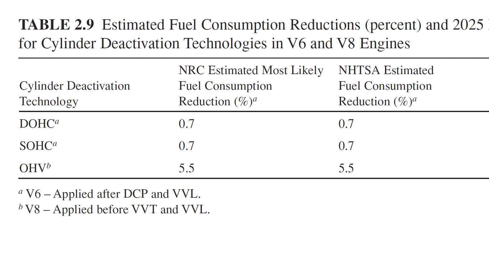

I would say 1 mpg is a good ballpark figure.
There is a very good paper called "Cost, Effectiveness, and Deployment of Fuel Economy Technologies for Light-Duty Vehicles (2015)" that can be downloaded for free as a guest at this link
https://nap.nationalacademies.org/ca...-duty-vehicles
The way I read it, the estimated saving in fuel consumption (not the fleet estimate, but the estimate for a vehicle) due to Cylinder Deactivation is between 5.5% and 7.5% for a large displacement OHV engine. However, as other technologies are introduced, such as Variable Valve Timing (which the LT2 has) and DOHC (which the LT6 has) the saving attributable to Cylinder Deactivation can become pretty small (like 0.7%) because the baseline efficiency of the engine has already been improved. Its a bit confusing because its showing V8 OHV and V6 with SOHC and DOHC. The article is long has more detailed information for the interested reader.
Here is the statement from that paper on which I base that ((you can see there is some variation in estimates noted):
"The fuel consumption reductions and direct manufacturing costs for cylinder deactivation estimated by NHTSA are shown in Table 2.9 and compared to the committee’s estimates. NHTSA estimated, and the committee agrees, that cylinder deactivation for OHV engines can provide up to a 5.5 percent reduction in fuel consumption, assuming that it is applied before VVT and VVL. However, for SOHC and DOHC engines, NHTSA assumed that cylinder deactivation would be applied after DCP and VVL, resulting in a less than 1 percent reduction in fuel consumption. In contrast to NHTSA’s estimates of up to 5.5 percent reduction in fuel consumption, the Department of Energy has estimated cylinder deactivation can increase efficiency by 7.5 percent
over VVT (DOE 2013)."

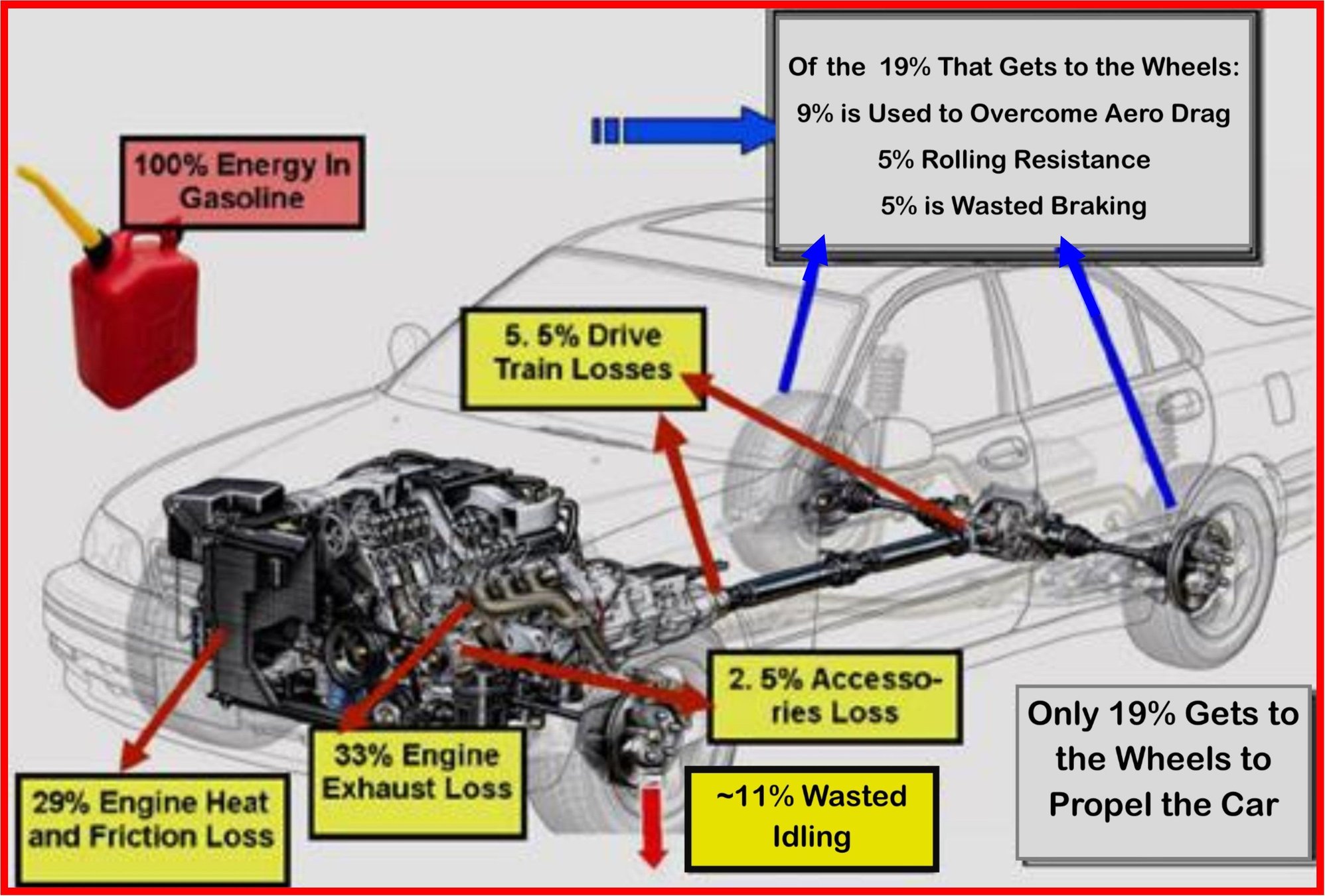

Yep, the ICE is very energy inefficient! About ~50% of the heat of combustion (~2500F temp) goes into the coolant and out the exhaust. Only firing 4 makes less waste! Losses don't reduce by half BUT less!
