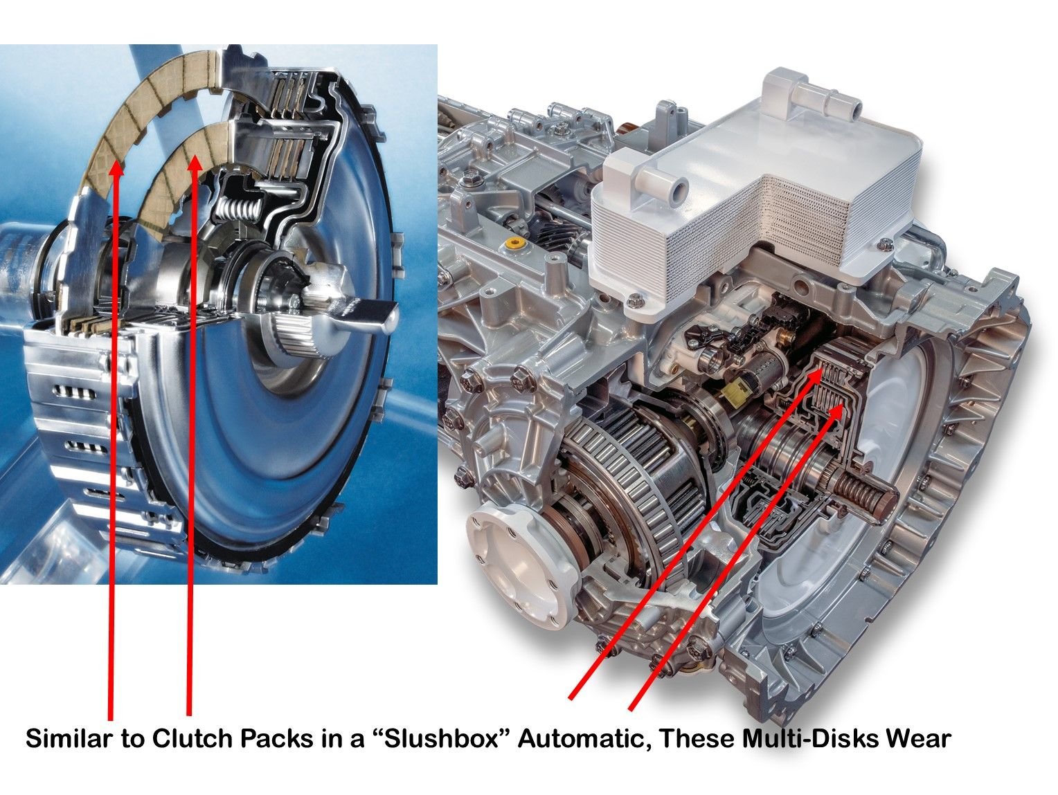

It's in 1st gear when stopped, you can tell by the display! However it's apparently at very low pressure IF you keep your foot firmly on the brake. Pressure increases with reduced brake pressure AND you can see the rpm increase. It does just what you would do with a standard shift.
I thought about the 1st gear clutch slipping when going very slow. It has to or like a standard shift the engine would stall below ~5 mph. So year one, with ~3000 miles I used the free DCT filter (that requires a flush) and engine oil change.
Just did my 3rd year all DCT fluid replaced and did a new DCT filter (with required flush) to meet the 7500 mile requirement. Since many folks reported DCT CELS early thought getting ride of early debris, especially from that 1st gear multidisc clutch was smart!
BTW, if you won't hit 7500 miles by year 2, foolish not to have it changed year one. GM says if you have it changed say year 2 with 6000 miles MUST change again at 7500 miles. Only +/- 500 miles allowed to deviate form 7500 mile required filter change. Would be silly to change at ~6000 miles to get the free new filter and again year 3 when you reach 7500 miles.
No issues with my DC in 3 years (looking for wood!)
