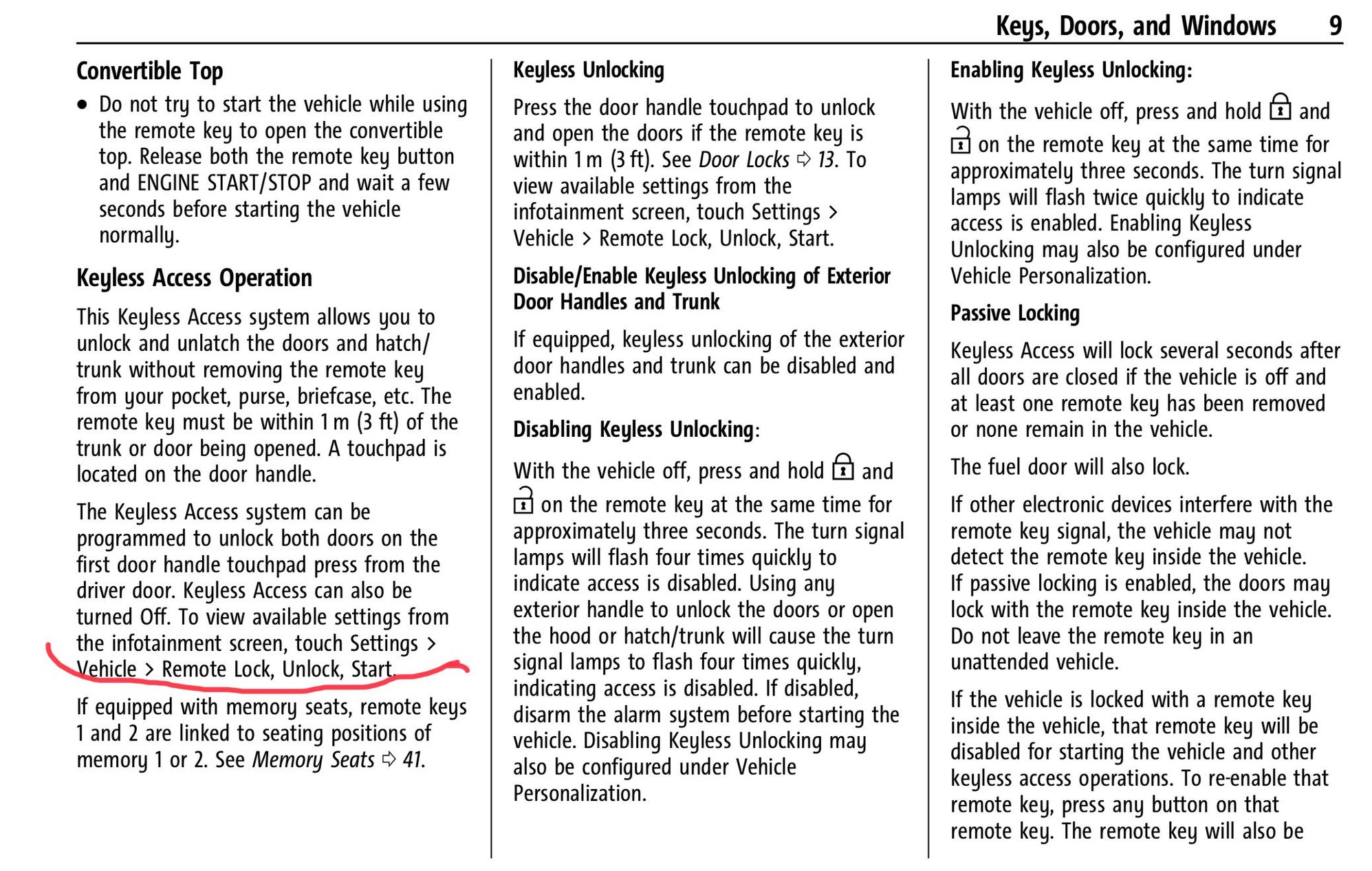

anyone know this? i must have read the owner's manual 5 times by now and can't figure out how to use the keyless entry system to lock the car. I am not talking about using the FOB or the door lock to arm / lock the car. any idea? thanks

Here:

thank you michael T for your response, i had already look in the infotainment section and found nothing. there is the screen shot that i see. thanks

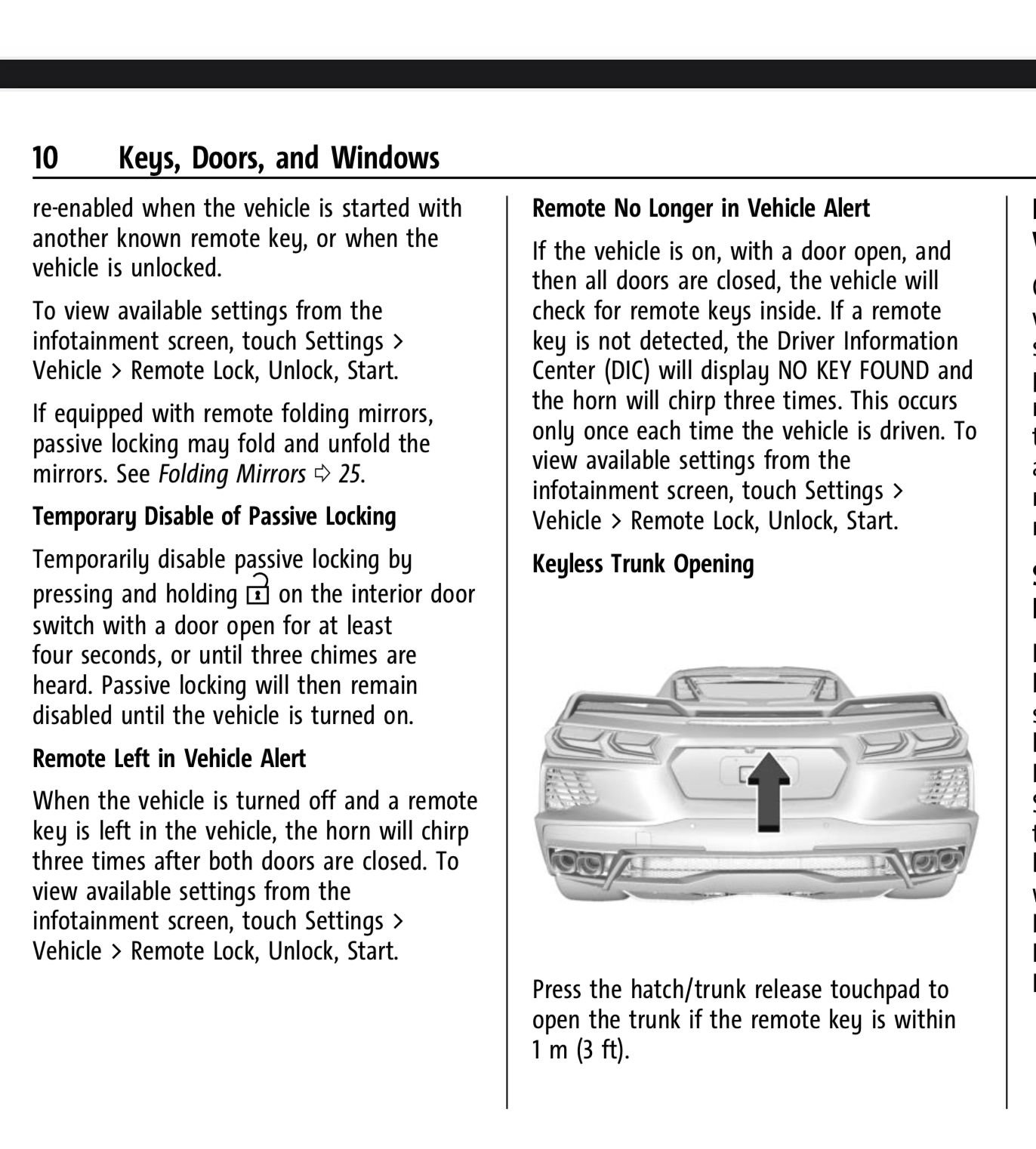

On page 25 of the 2023 Owners manual it says:
Remote Mirror Folding
If equipped with power folding mirrors and
the mirrors have not been folded with the
power folding mirror switch and the vehicle
is in P (Park), they may be automatically
folded/unfolded as follows:
1. If doors are locked by double pressing (lock symbol)
on the remote key, the mirrors may fold.
If doors are unlocked by double pressing
(unlock symbol) on the remote key, the mirrors may
unfold. See Remote Key Operation 0 7.
2. If doors are locked by pressing the door
handle button, the mirrors will fold.
If doors are unlocked by pressing the
driver door handle button, the mirrors
may unfold. See “Keyless Unlocking/
Locking from the Driver Door” in Remote
Key Operation 0 7.
So #2 says there is a door handle button? Maybe if auto locking is off the door button will lock the door?
JT
