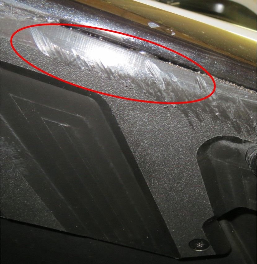

Reminded of the air dam on my C6 Z51. Scraped a lot. Evey 6 months I would sand off the roughness. Good as new (when viewed by ants the only ones as your wife notes will see it! ) No reason can't do the same with the standard Z51 splitter.
My experience with splitters in pics and plan for my E-Ray.

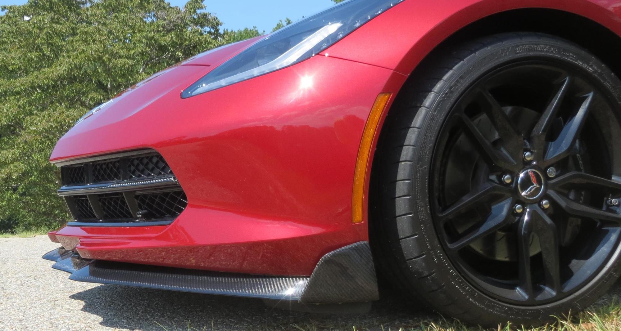

Added a carbon fiber outer layer splitter to my 2014 Z51 that matched the CF side skirts bought to stop rocks hitting rockers. Scraped the bottom. Can't fix CF!

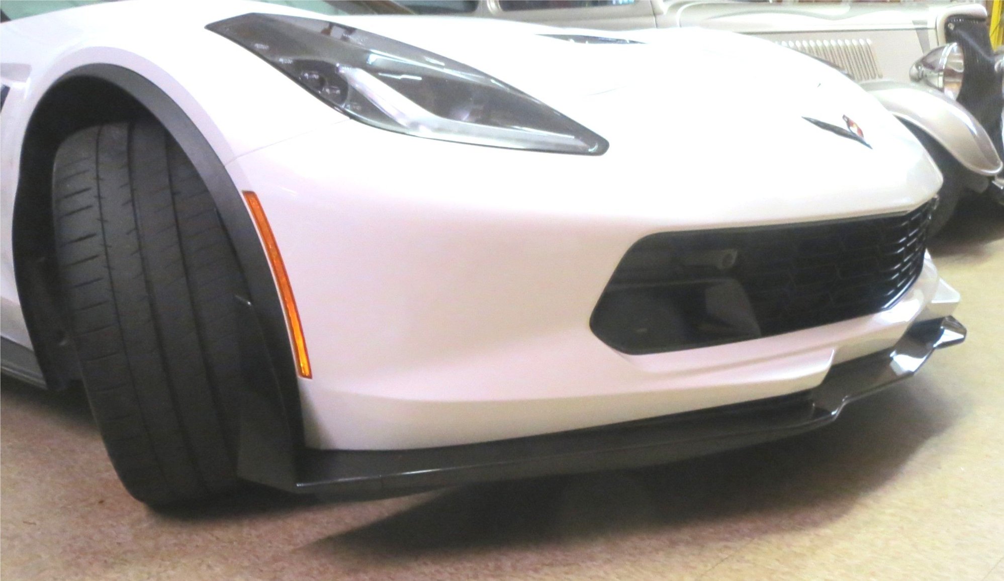

Wanted full length rockers for my 2017 Grand Sport. Bought the Stage 2 Aero Option that came with CF side skirts AND splitter bought mine for $4500 painted carbon flash. Visible CF was a $1000 more. Note I scraped the Stage 2 Winglets again a side curb so bought these Stage 3 made from ABS painted carbon flash that were 1/3 the price of the smaller but CF Stage 2.

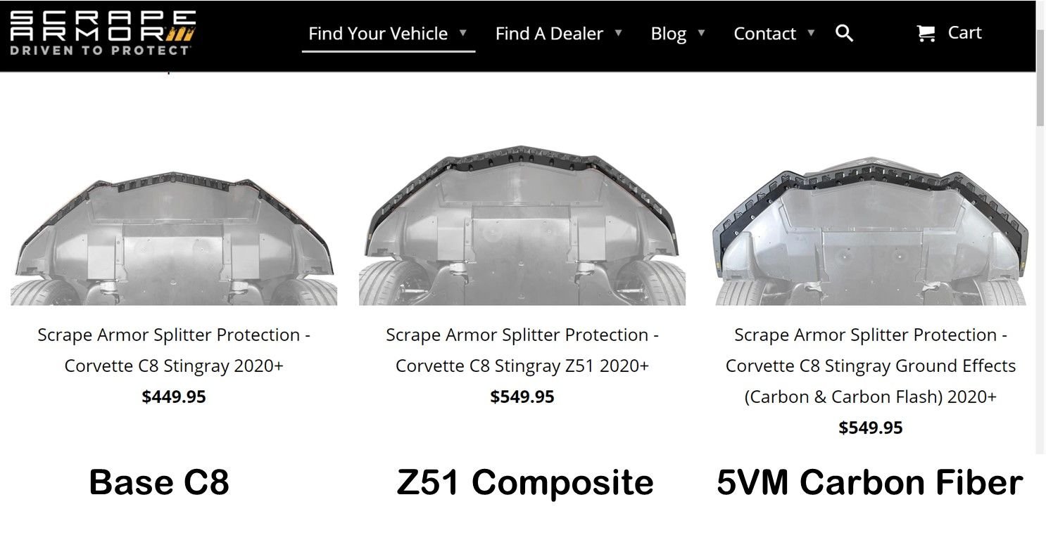

Did not want to replace a $2000 splitter so installed a Scrape Armor Splitter protector.
Worked. It scraped BUT not the carbon fiber which flexed and let the Teflon like Scrape Armor take the abuse.
They sell for the C8. May not be worth the price for the Z51 splitter BUT if you take the step I plan for the E-Ray AND don't have a lift may be worth the cost.

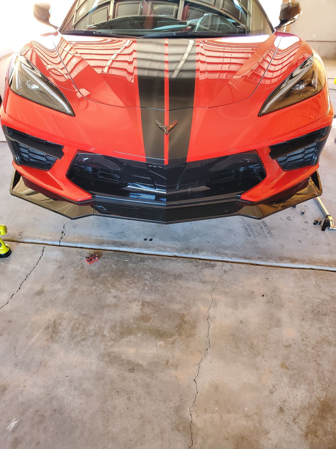

For the C8 bought the Lift Option, only ~$1500 in 2020. I had a 5VM aftermarket splitter and have side skirts. Would not drive in my rural area without side skits. Mostly no shoulders and pebbles on road edge often on the narrow two-lane pavement. Side Skirts stop rocker panel dings. Lift stops scrapes underneath BUT I have scraped on side winglets on concrete curbs parking in malls parking close to where they have trees etc! Now have put my Z51 splitter back on!

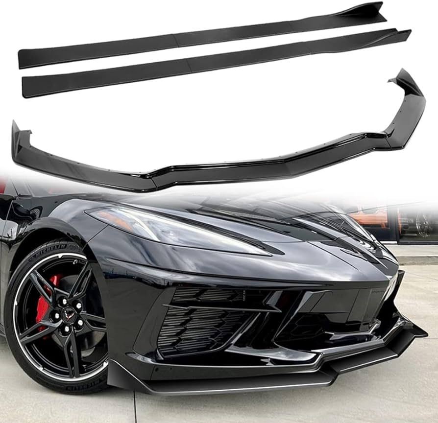

So for the E-Ray am getting the Lift (now $2500) and instead of fiberglass or CF, I'm going to buy an ABS splitter, painted carbon flash. It takes paint very well and they are available for the C8 Z06, which is the same as the E-Ray. About $200! ABS is more rugged (what LEGO Blocks are made from) than fiberglass and CF. Can be sanded and repainted carbon flash, or for $200 replaced. Something to consider.
