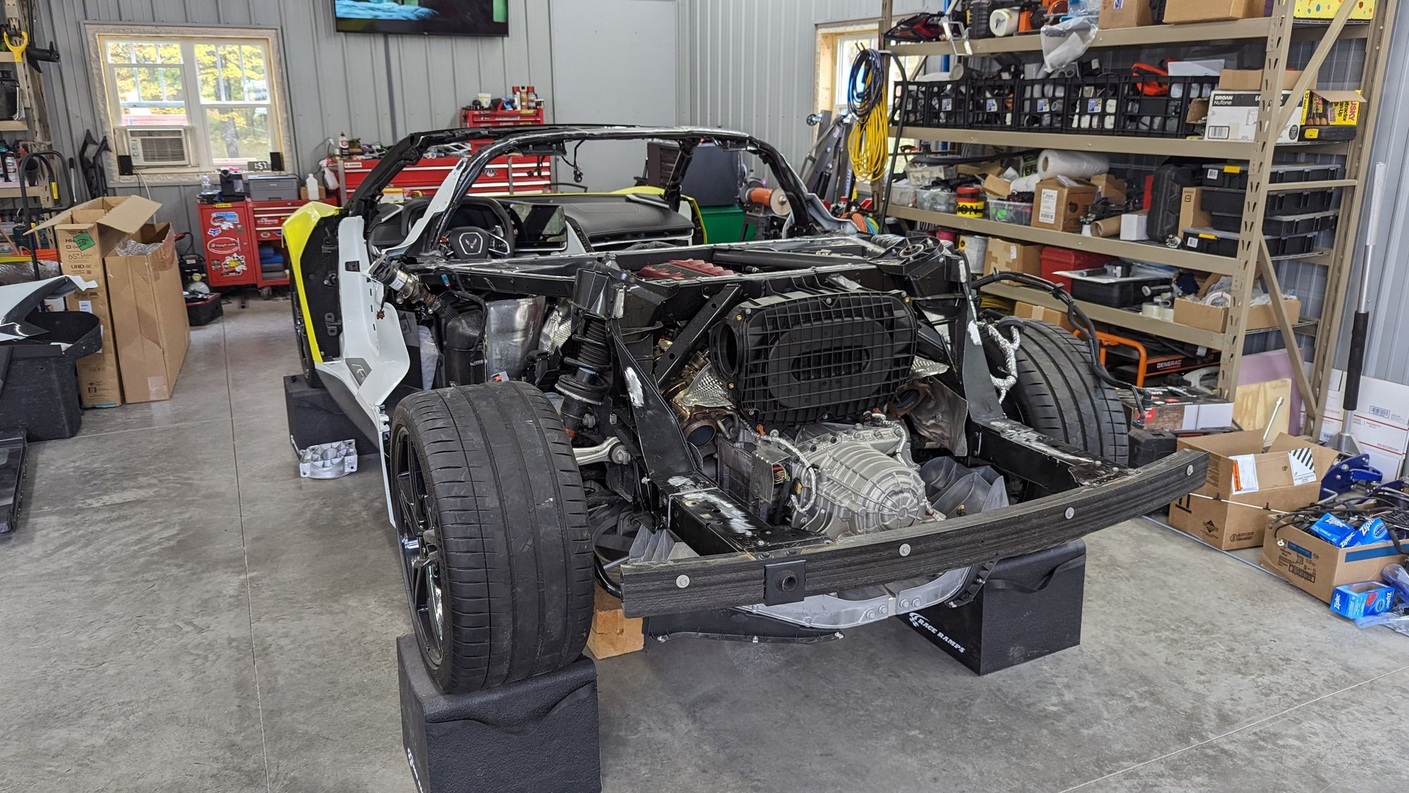

mortelec's Avatar
mortelec
Joined: Jul 2021
Posts: 694
Likes: 617
From: Crosslake, MN
What do do you want to know?

Originally Posted by mortelec
What do you want to know?
How to remove the fixed part of the roof on a coupe. There are 6 little hex head bolts across the back. How is the front attached. If it is like the C7 in the video, the seal is removed by pulling up, then the screws in the front are exposed.
That panel has to come off for access to the rear deck hinge bolts. That's what I am after. I have to remove the solid roof panel to get to the rear deck hinge bolts. It looks like you have been there, done that.
I am impressed with your skill. I cut my C5 in half at the firewall, and welded on new frame rails, then built a roll cage. That is but nothing like what you did. C5 are simple compared to C8.
