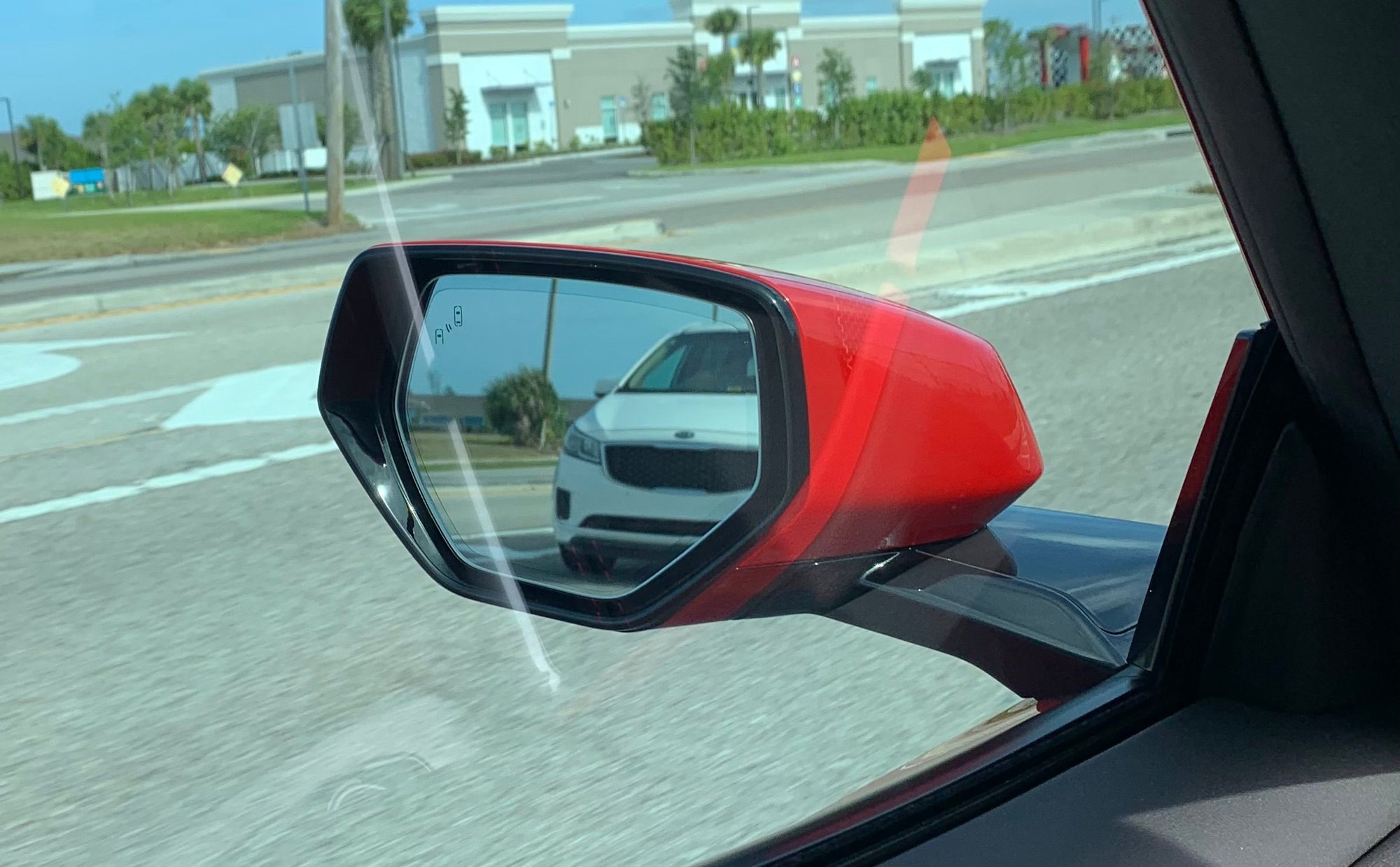

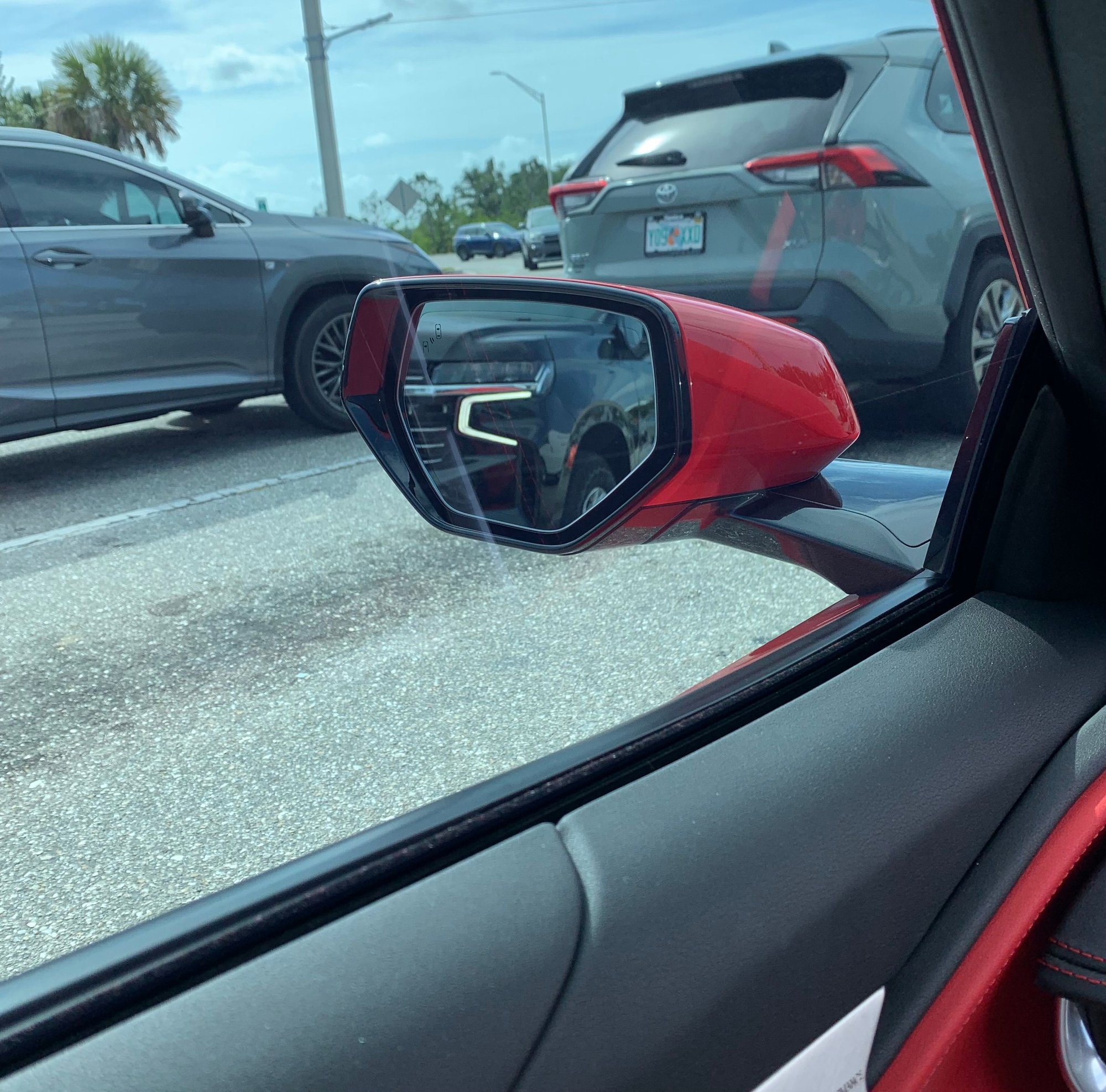

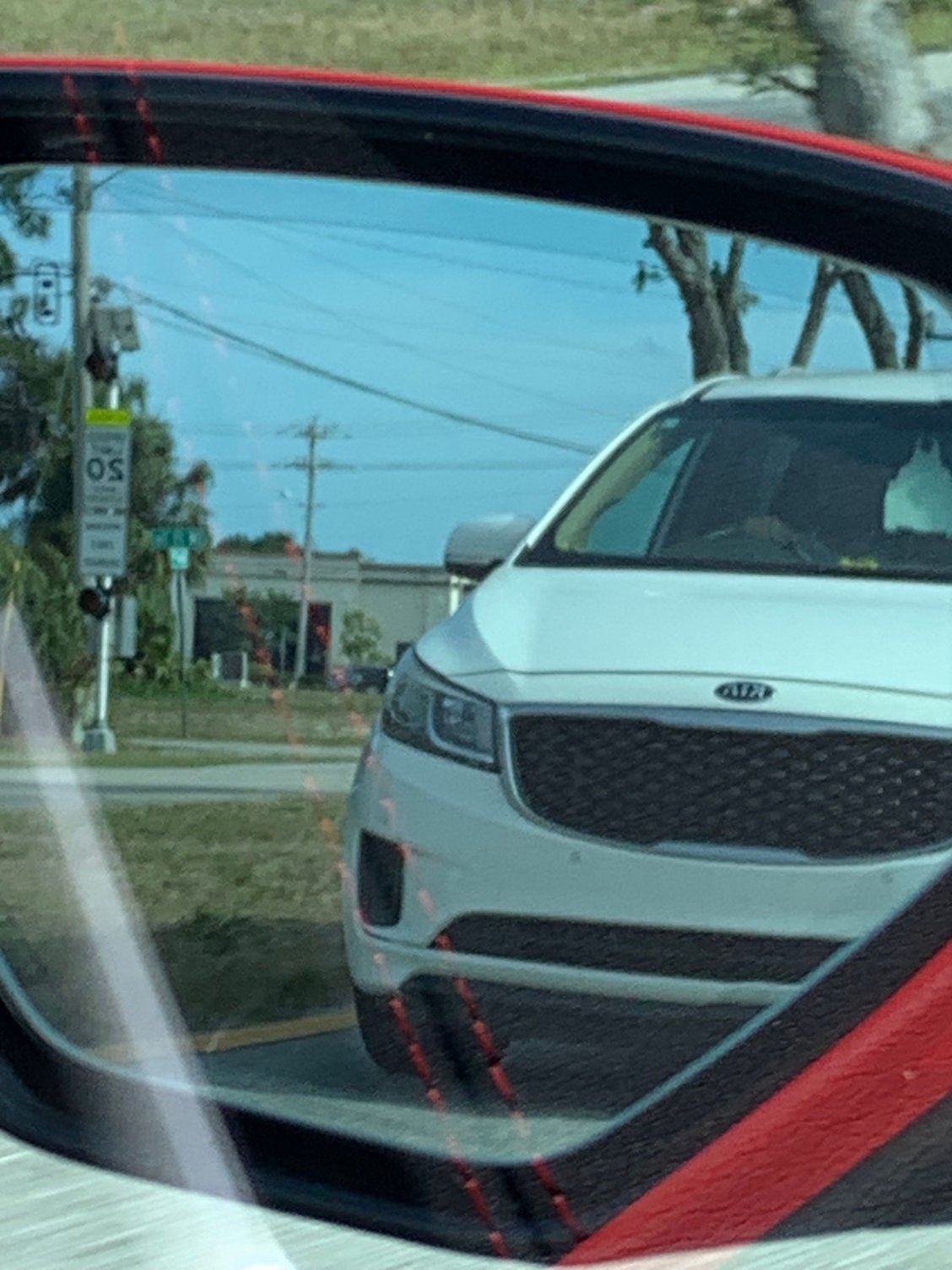

These are pictures of cars in my “blind spot”. Note the blind spot indicator is not lit up even as the car is clearly in my “blind spot” and doesn’t light up when the car is almost even with my bumper. Past that point it will light up but far too late!
It’s a good thing I have my mirrors adjusted correctly and have the Rear Camera Mirror together they eliminate my blind spots. And because of the Rear Camera Mirror I can see cars approaching a long distance away. Still, the indicators should pick up cars in one’s blind spot
Maybe I need to bring it in to have my sensors check because the manual say, “This zone starts at approximately the middle of the vehicle and goes back 16 ft in the other lanes!

I don't think there is anything wrong with your mirrors because I've found the same thing. You get the alert when the car is essentially beside you. Maybe those 16 feet are new born baby feet.

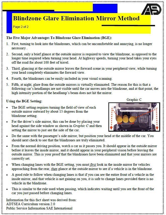

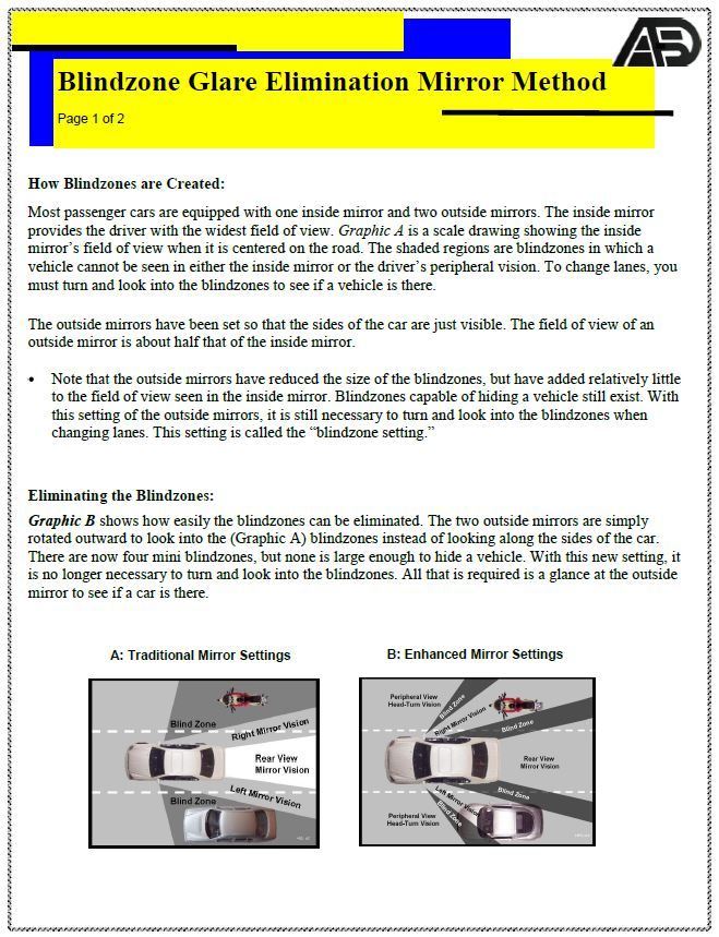

No need for convex mirrors if your mirrors are adjusted properly to begin with. Most people don't know how to properly adjust their mirrors. If you can see the side of your car while sitting normally in your drivers seat, they aren't adjusted properly (even though this seems to be how majority of people adjust them). You should be able to rely on your mirrors as it takes longer to physically turn your head to look over your shoulder.
Here's some info directly from NHTSA website:

If that is the intended activation point it is a hazard. No make that dangerous! The blind spot mirrors in our SUV flash on when a car is 6ft+ behind us.
