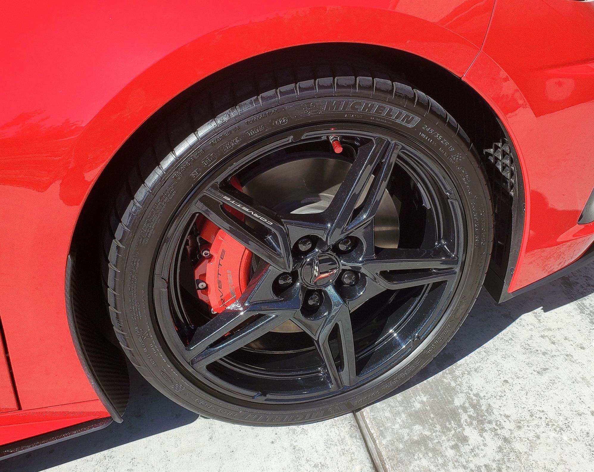

What size are the lug nuts? 19?
To Changing lug nuts
Old Jan 22, 2024 | 02:11 PM
tadda's Avatar
tadda
Veteran: Marine Corps
Joined: Apr 2018
Posts: 5,812
Likes: 8,303
From: Dove Mountain, AZ
22 mm
