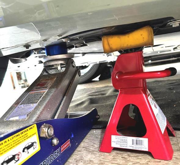

Big Lebowski showed how he lifted his C8 to remove the front calipers when replacing brake pads. He used the Jack at the round frame hole with Jack Stand at the oval lift slot. I used a similar approach when I removed my E-Ray rear tires. Actually, a bit of a reverse of what he did, Jack in oval lift slot and small base Jack Stand close to jack on frame.
Member Big Lebowski used this safe approach to remove front calipers charging to low dust pads.
Used similar approach to remove my rear E-Ray tires. Small base Jack Stand (with plastic pad) on frame close to Jack in oval lift slot. If I was going to change my own oil would use two jacks alternating lifting each side a few inches at a time, as I did my C7s. For the C8 put jack stands close to the jack but keep some tension on the jacks for more security and support.

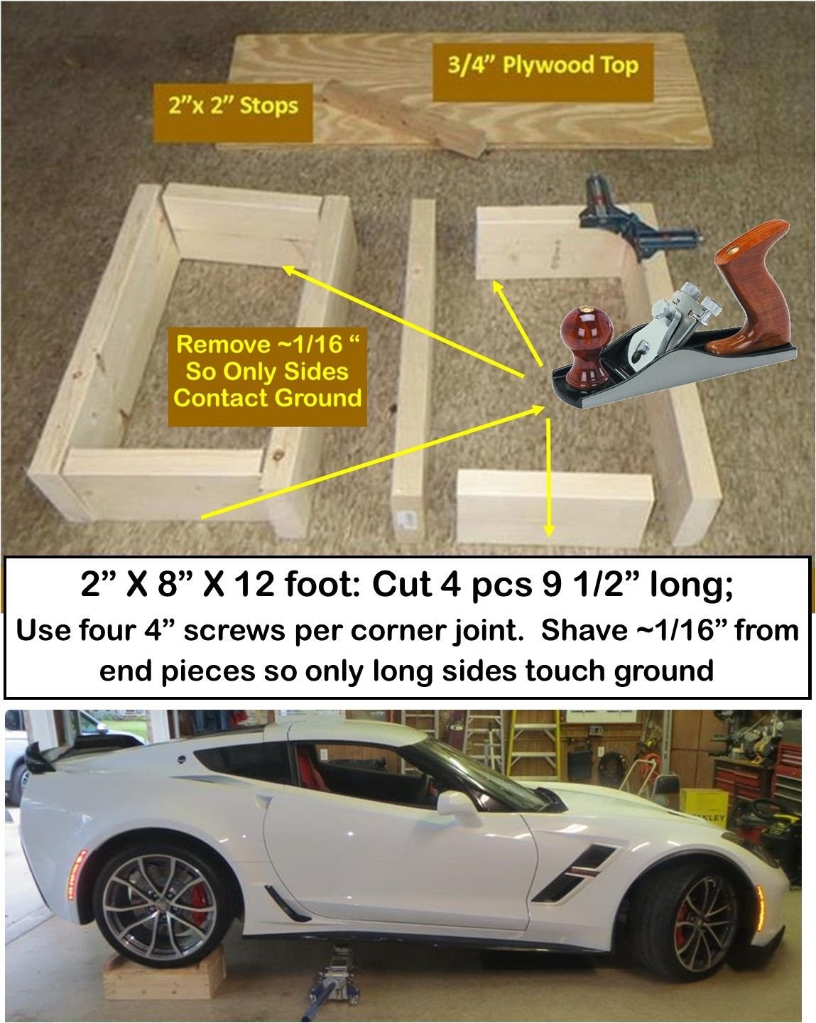

For 7 years with my C7s used 6-inch-high homemade wood stanchions in rear and jack stands on the front cross member to make the car level to change oil. Also used the stanchions to install side skirts, splitter etc.
For the C8 only need to lift the rear as drain plug is in the front of the engine. I would make 8-inch-high stanchions to get the required height.

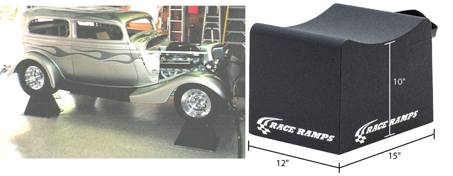

BTW I have 12-inch-high commercial stanchions I used when building my street rod but took a two step lift. Was worth it when I worked over a month under the car installing exhaust, trans cooler, wiring, fuel lines etc. BUT higher than needed for a C8 oil change. You can purchase plastic stanchions 10 inches high. For the C8 and now E-Ray, I found a great C8 Tech at a dealership that provides discounts on fluids and parts. I'll leave my oil changes to my 24-year-old street rod!

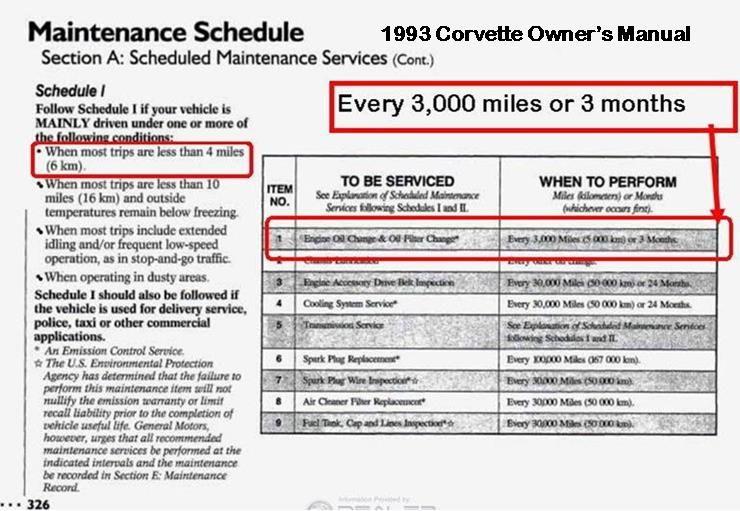

Hmm, nope GM recommends only ONE THING as when to change engine oil and filter, the OLM! NOT miles, NOT one year! Yep, miles and 12 months is what it said for my 1988 and 1993 Vettes before there was an OLM as those, AT BEST, were POOR INDICATORS but all we had.
The GM engineers who developed the OLM measured wear and other additive depletion and use that info in their complex, OLM algorithm. They monitor engine oil temps after cold starts. The OLM uses total engine revolutions, number of starts, miles etc.
IF IT JUST USED MILES AND KEPT TRACK OF CALENDER MONTHS (which some mistakenly think that is all it does: ) It would say as my 1993 Vette Owner's Manual before the OLM and why Jiffy Lub, some Dealers recommended with stickers they put on the inside upper corner of your windshield AS GM NOR JIFFY LUB OR DEALERs DON'T KNOW HOW YOU DRIVE:
So the OLM would say as my 1993 Vette Owner's Manual recommended (see Pic)
CHANGE OIL EVERY 3 MONTHS OR 3000 MILES, WHICHEVER OCCURS 1ST!
