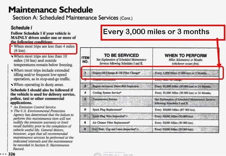

If you take the time to understand what the very sophisticated Oil Life Monitor (OLM) does you'd be way ahead of watching TikTok!
  • First, miles was a poor way to determine oil life! But that and time were all we had. Where they good highway miles or poor stop and go, many cold starts city miles? See Pic from my 1993 Vette BEFORE Vettes had OLM.
  • BTW recall in ~1955 my Uncle who was Service Manager at a large Chevy dealer told me that when my we were picking a car for my Dad from a large lot of 2-year-old fleet cars they just received.
  • Reviewing just one key item. The OLM monitors oil temp after cold starts. Lots of blowby for a few minutes after cold starts that has the rich fuel/air mixture passing the cold piston into the oil. The main product of combustion is Water. Yep, CxHx plus Oxygen in air combusting makes heat and water, H2O etc.
  • After a few minutes the ~2500F combustion temps heat the pistons and they expand reducing the piston to cylinder wall gap. Far less blowby.
  • If the oil gets hot enough long enough it will evaporate much of the water in the oil. With many mostly short trips the OLM will reduce the 12 months minimum change time.
  • That water forms things like sulfuric acid that eats metal with the car parked,
  • BTW my 1988 Vette like all 6 others stated you must change oil a minimum of every 12 months. Yep if you only drive~3000 miles/yr like myself must change in 12 months NOT that the oil is worn out it's for contamination.
  • The OLM is a complex algorithm, and miles is just one of the things it measures, total engine revolutions, used for airplane engines, stationary power is another. Lots of info on the subject and a very long post I could add but this is more than most can digest!
My 1993 Corvette notes if most drives are under 4 miles where the oil does not get hot enough long enough to evaporate much of the water of combustion that passed the cold rings, should change in 3000 miles OR 3 months whichever came first. Or if very cold outside trips shorter than 10 miles! The same with many stops as in stop and go traffic.
