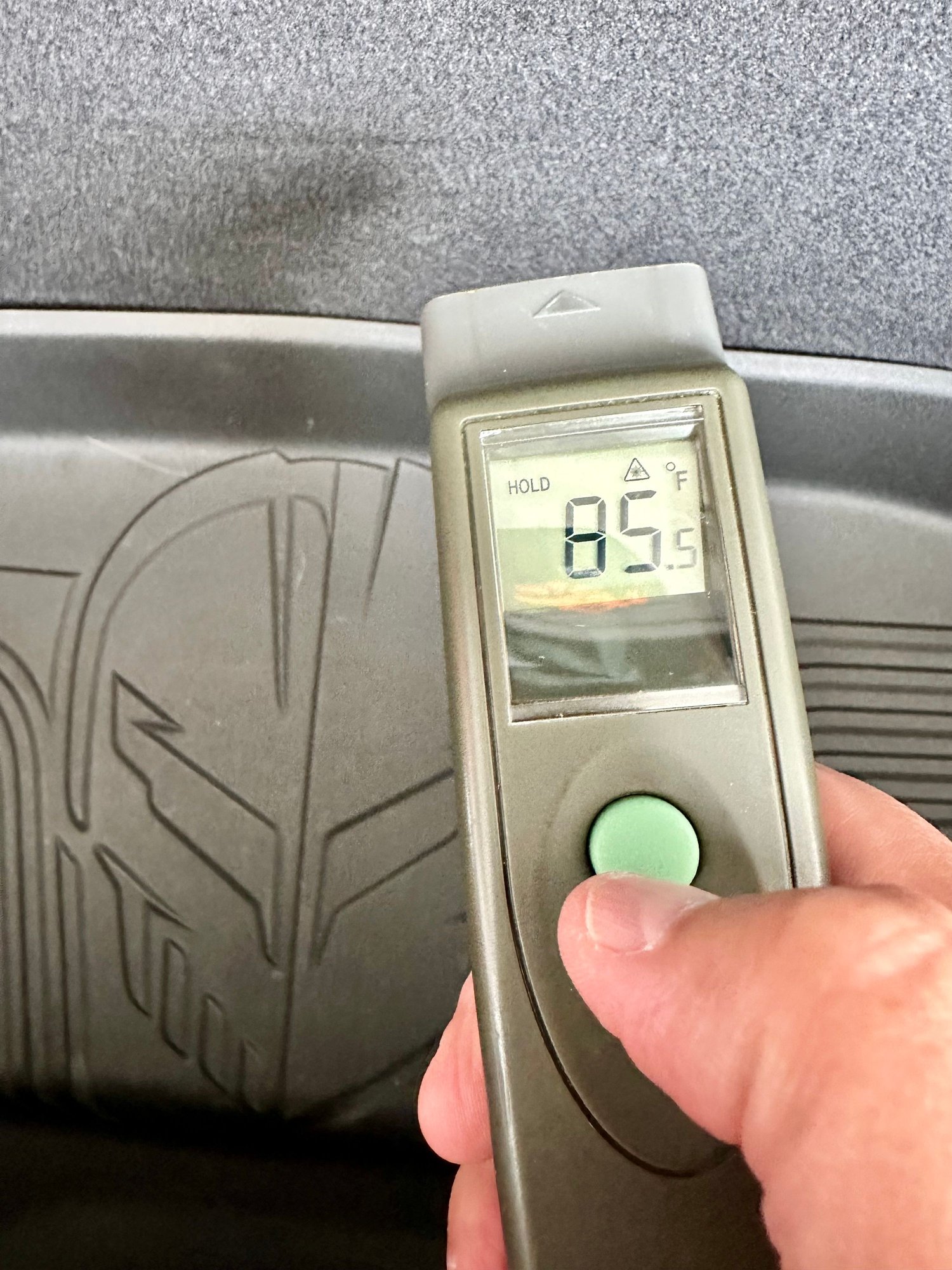

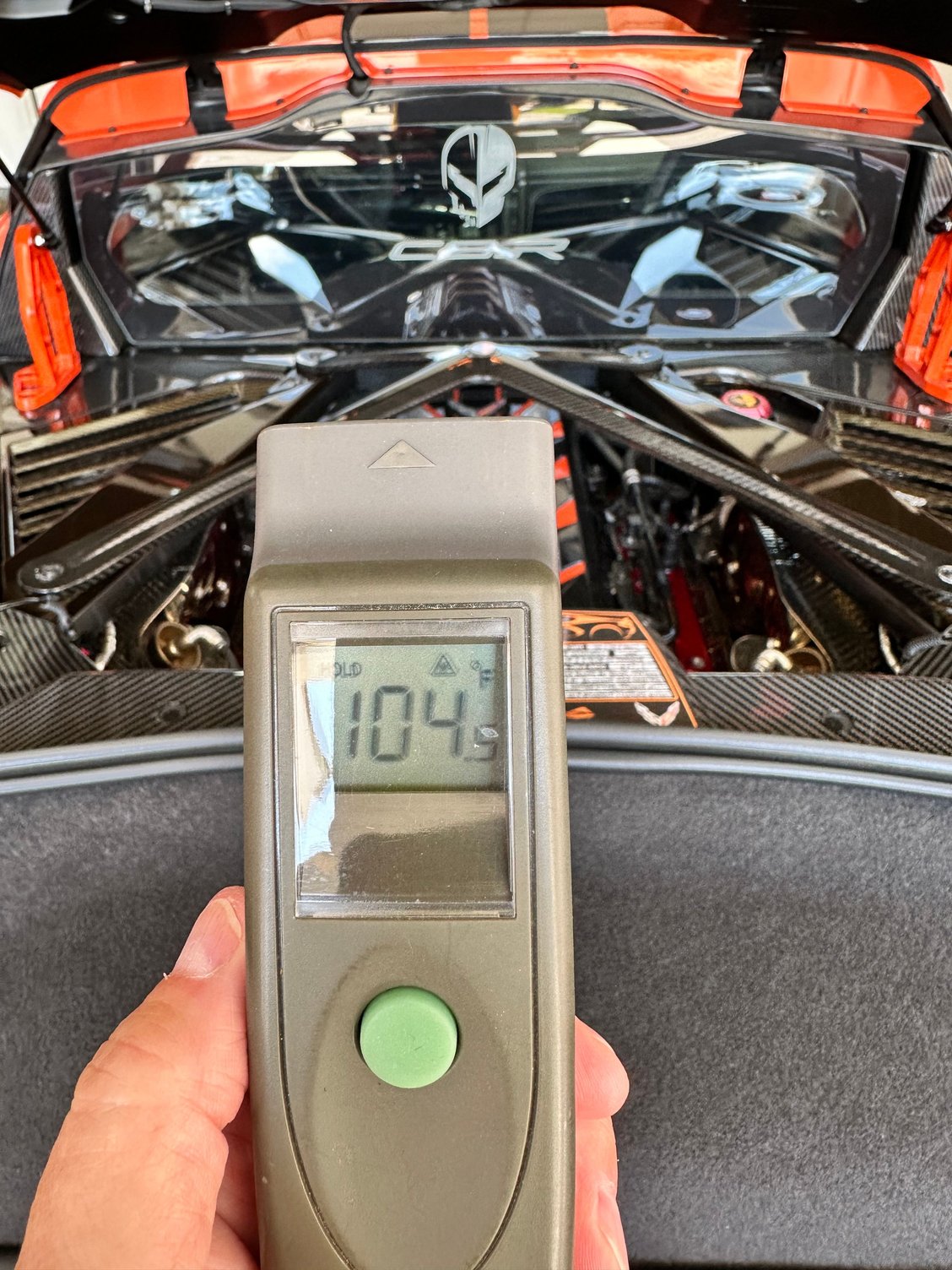

Did the Heatshield Products on the trunk today. Not the most economical solution at $165, but the results are definitely encouraging.
The test was a 30 minute spirited run in Z mode through the local hills followed by a 45 minute heat soak in the garage. Both runs were about 2 hours apart and in both cases the fans were running after shutdown (Z51). Temperature was taken with a Fluke IR meter in the center of the trunk where the exhaust sits (Borla ATAK). Net result was a 20F decrease. Product is 1/8” thick, very workable and applied with 3M tack spray on both the back of the carpet and the Heatshield Product matting.

I did exactly the same a few months ago, I experience a 30 to 35° decrease. I thought as well worth every penny.
