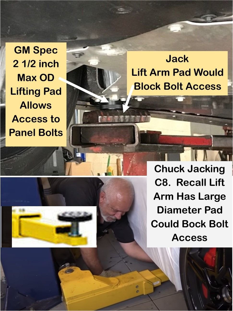

I prefer Jack Pucks meeting GM specs (2 1/2" max diameter) and I like 1"inch high. Contrary to some comments, Techs buy their own tools. Doubt many buy jack pads for Vettes! Yep the dealer "May" have them and the Tech can go to the parts department (where most keep special tools) and check them out and bring them back, like other "special tools." Doubt many do that as can't make commission going back and forth!
I have a great C8 Trained Tech. Only one who does everything, oil changes, warranty issues etc on my Vette. He did NOT have jack pads. He knows mine are in my tool bag in the Frunk, as is my wheel lock key. Always uses them. In fact when removing the rear aluminum Aero Panel/Shear Plate it allowed him to reach the 4 of ~30 bolts that are close to the oval lift slot.
Funny, Chuck the Tech where Conti is a salesman said in a video out changing the DCT filer they had to jack the car several times as the large jack pads on their lift arm hoist blocked some of the 4 bolts!
Also note, Chuck is a skilled Tech and he still reaches under the car to locate his jack arm pads! Try yourself, see if you can see the oval lift slot without putting your head on the ground. Techs are probably not going to put their head on a shop floor to see those flat lift pads! When I use mine, I can "feel" to get the top of the Jack Pad go in the oval slot. It's your Vette bring your own pads!
