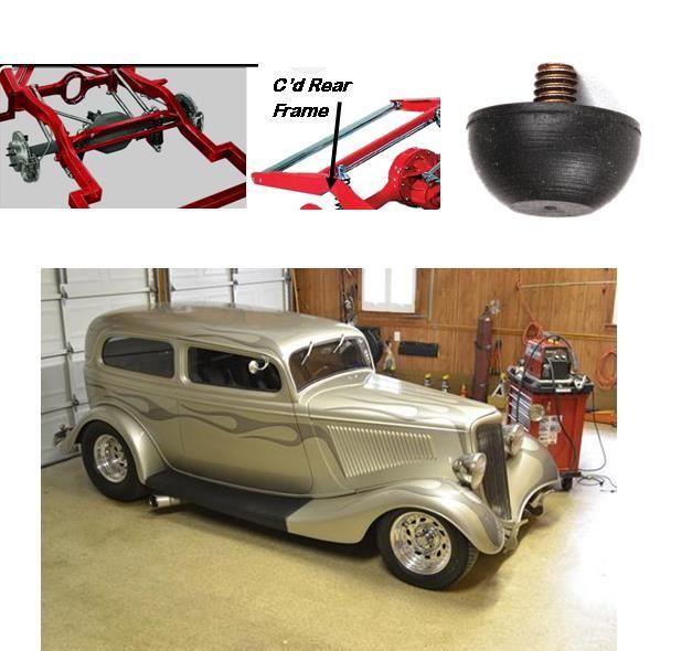

Originally Posted by jimmie jam
I have driven mine all over town in track mode. I also drive my 911S in sport/sport + mode all the time...the cars were designed and built to be driven hard. The suspension does not "crack" wheels, the driver does that.....ponderous.
Yep, agree. Hit whatever hard enough and you hit the bump stop! Much higher load than any shock can deliver. On my Street Rod, the rear TCI Tubbed Frame is C'd so the 9" Ford axle has some room to move up! But I have it lowered so much, on a big bump the axle was hitting the frame. I added a small rubber bump stop. Less of a shock but cut down on the amount it could move before hitting. Bottom Line, don't hit big bumps!
