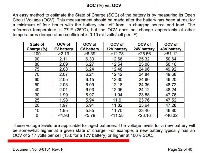

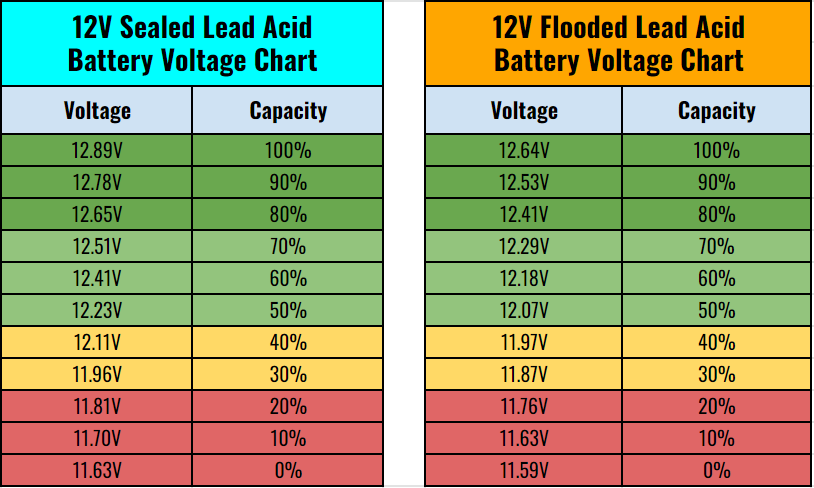

Below is a typical lead acid battery voltage vs state of charge chart. Any time the open-circuit volt is at approximately 12.5V it is 100% charged. What I would like to know is why did Chevy put a flooded battery in instead of an AGM battery.

Sorry. 12.6V I am a crappy on a keyboard

Thats right. A recently charged battery, right after charging, will read a higher voltage. The OC voltage in those charts must be measured after the battery has set without a draw for 4 hours, in order to assess the state of charge. The car actually does that, by the way. After it has been off for several hours is will calibrate the Battery Monitor Module, then when the engine runs it measures current into and out of the battery to keep a running estimate of the state of charge, which it uses as on of the factors in selection of the charging mode. The voltage range for the Economy Mode is 12.5 to 13.1.

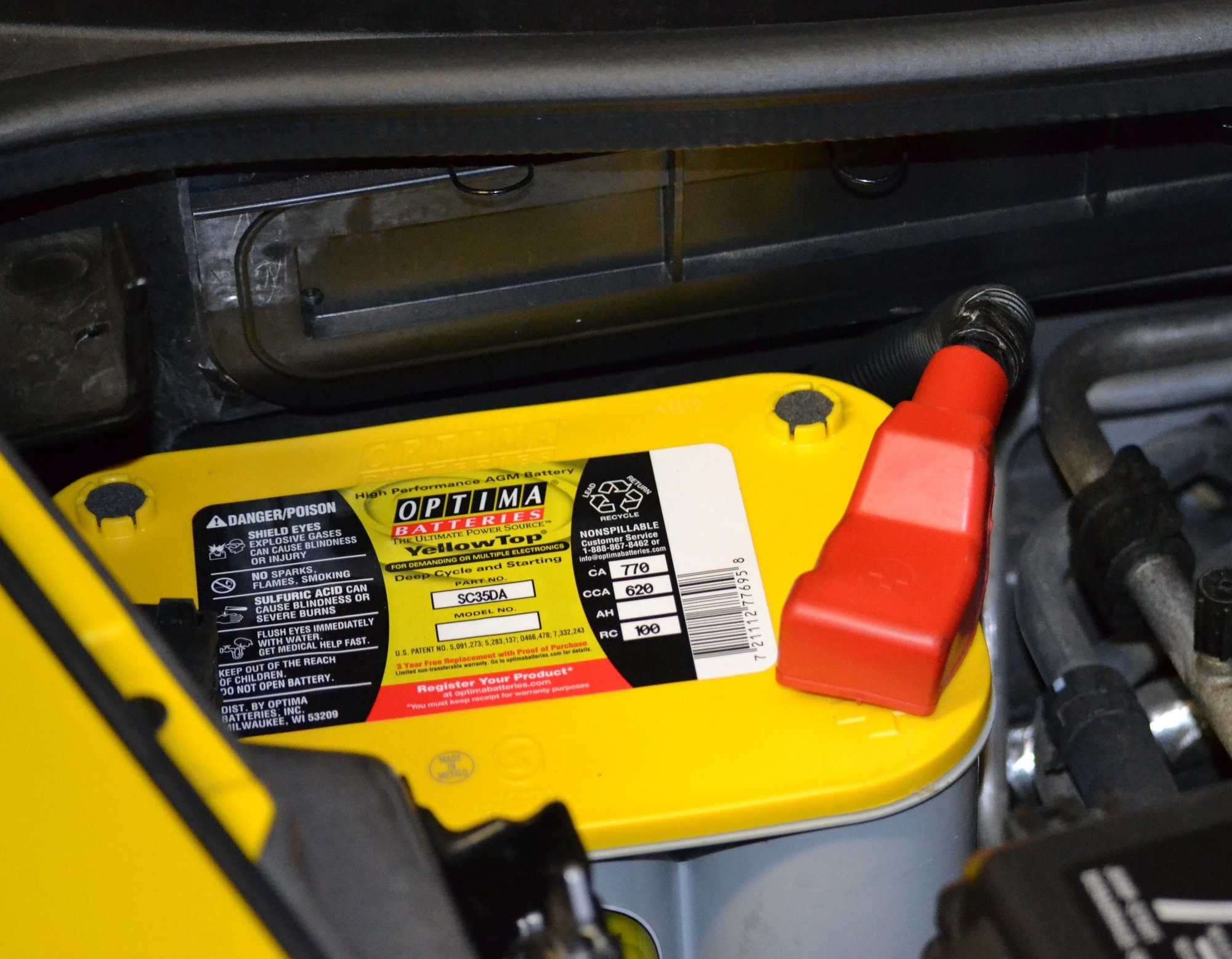

What I used as a replacement for the OEM in my 2008 C6. Since the car was yellow used an Optima Yellow Top!

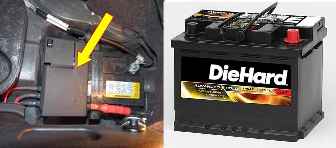

Used a Diehard AMG as a replacement in my 2014 C7

Hmm, the Optima AGM's have a slightly higher voltage.
The Optima worked fine in my 2008 C6 and the Diehard AMG worked fine in my 2014 C7.

Right. Meaning at 80% the Optima voltage is bit higher than an FLA at 80%. Which means, if it does not adapt, it will overestimate the state of charge of the AGM, and thus undercharge it with respect to its target state of charge, be it 80% or 100%. For example, in the attached charts the FLA OC voltage after sitting a while is 12.41 at 80% charge. But the AGM will produce 12.41 volts at 60% state or charge.

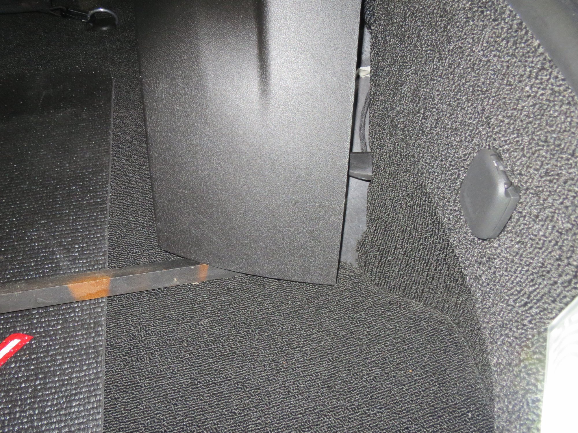

I had replaced my 1st Vette, a1988 battery within a year since the car had no low parasitic current draw circuits. Twice I tuned on the interior lights to get something in the car when I pulled into the garage at night. Since they had a 30 second time delay after the door was open on the high wattage interior lights, thought nothing of them being on when I closed the door from the garage to the house. Both times dead battery in the morning!

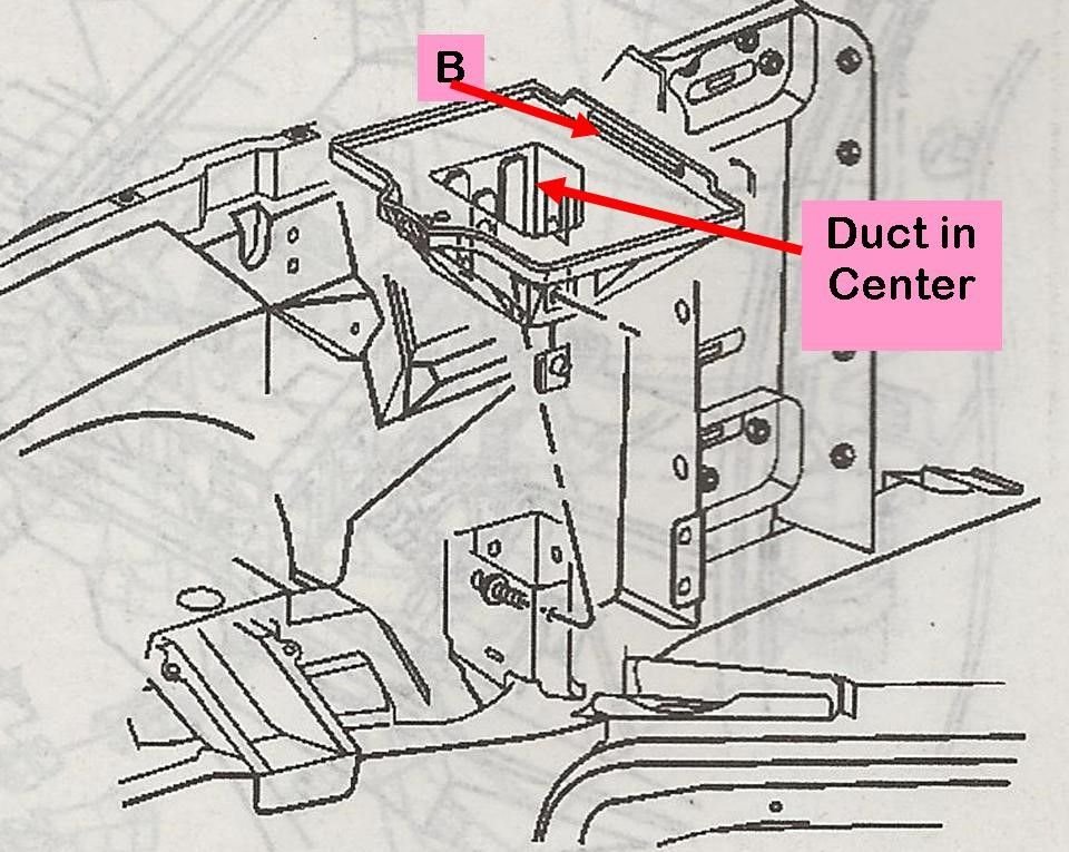

My 2008 C6 battery failed within a year. GM was smart enough to include a plastic open duct in the engine compartment battery holder as their were some power electronics right below and if the case failed (mine did with a crack on the bottom) the acid could eat the electronics! My C6 was yellow so bought an Optima Yellow Top to match! My S-10 truck battery case also failed. That OEM battery had front posts and if the screw was tightened too much it cracked the case!
I was one of the 1st on the Forum to replace the battery in my 2014 C7. Had ordered right after the launch at the Detroit Auto Show in Jan/Feb 2013. Was one of the 1st delivered to Hendrick in Cary NC. Only dealer at the time who would take a deposit not knowing the MSRP with an email saying that would be the price! GM didn't release the price until ~May. Mine arrived late August 2013. It had a low voltage from day one but local dealer just said it's fine. By year two voltage had dropped and before year 3 winter I installed a Diehard AMG. Recall despite having the Four Volume Service Manual it just said remove cover over left side of battery but no clue as how! Turned out needed to push a screwdriver into recesses to release the plastic clips!
The real trick, in addition to getting the battery out of it's hole was accessing without ripping the untrimmed carpet under the plastic wheel well cover. Some posted dealer tech ripped their carpet. Wasn't hard. In my How To Doc PDF I showed how to remove the front of the plastic inside wheel cover so that the carpet could be slipped out without tearing!

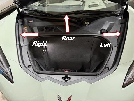

Yep if you plan to keep the C8 plan on learning how to access and replace the battery. Those with AAA who think I'll just call them when the battery dies in the winter might find with a C8 the tech will break the two side plastic covers in the Frunk that need to be removed. At least learn to do that yourself before they come! Need to pull to center of car NOT UP or you'll break the clips!

As long as some still want to post erroneous data, AGM and GEL have completely different charge parameters. AGM and Lead Acid are nearly identical (within 0.1Vdc) on their charging parameters. AGM and standard wet cell batteries are 100% charged at 13.2 Vdc for professional manufacturers, 12.85 for budget manufacturers and 12.6 for substandard manufacturers of Lead Acid batteries. This is why you any see these different % charge tables. The C8 and every other vehicle is worthy of a credibly manufactured battery.
Lifeline uses 2.2 Vdc per cell (13.2 - 12vdc battery) in their batteries, but is showing a range to cover many manufacturers. They mention 2.17 at the bottom for their batteries after aging (typically after 24 months). i can verify from actual use and installing verification in thousands of locations.
The above Lifeline (Best AGM batteries manufactured) document may be found here.
