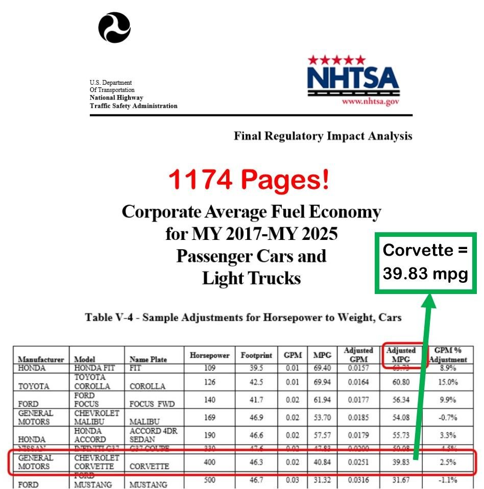

Still doesn't make sense with the low volume (compared to the entire fleet of all makes and models in GM), they could get more of an EPA mpg by reducing tire footprint by 0.1"
This is a topic I have followed closely after reading the 2012 Government Plan to cut CO2 emissions in ~half by ~doubling the mpg by 2025. That was to be done with agreement by most auto manufacturers stating an aggressive redaction in mpg BY CAR FAMILY. It was a very well written report that define BY CAR FAMILY what each would be required to achieve. At the time Toyota was pushing Hybrids as a method all could use. Some said they would use EV's to reach the goal, one was Porsche. The goal for the Corvette Family was ~39 mpg. (It would be similar for most high powered 2 seat sports cars. It was a complex formula-but logical.) A high powered car that could carry 4 folks could have a lower mpg goal. A "Grocer Getter" with lighter weight and low hp engine could do much better so the goal was higher. NOTE it was not by Manufacturer so Ferrari could not buy Tesla to lower their average mpg. It was strictly by "Well Defined Car Family." Also it was not driven by a "Gas Guzzle Tax. They were NOT going to let rich Corvette (Ferrari, Porsche) Owner's destroy the World while others sacrificed! It was a prohibitive Tax of the Manufacturer And not just the name Porsche Sports cars were in a different defined family than a Porsche labeled SUV.
I read the report. it was well done and pretty fair.
These were some press releases in 2021, the 2022 when a new pen signed new goals:
WASHINGTON December 2021– In a major step to fight climate change, the administration is raising vehicle mileage standards to significantly reduce emissions of planet-warming greenhouse gases, reversing a Trump-era rollback that loosened fuel efficiency standards. A final rule issued Dec. 20 would raise mileage standards starting in the 2023 model year, reaching a projected industry wide target of 40 miles per gallon by 2026. The new standard is 25% higher than a rule finalized by the Trump administration last year and 5% higher than a proposal by the Environmental Protection Agency in August. “We are setting robust and rigorous standards that will aggressively reduce the pollution that is harming people and our planet – and save families money at the same time,” EPA Administrator Michael Regan said. Details to come. (MY NOTE: little doubt those details were going to be announced after this past election! We'll see just what happens I expect in January. BTW in 2017 when the plan was canceled with a Pen, California supported by 5+ other states sued the government and it was died up in court. Expect as then it will NOT BE, drop all mpg goals. The EPA shows car companies have made little progress and must do better. We'll see just what happens.
Washington, April 1st, 2022 49 MPG Fuel-Economy Standard Ordered for Cars by 2026 The Biden administration ordered carmakers to increase their average fuel economy to about 49 mpg by 2026, in an ambitious effort to make up for progress stalled when President Donald Trump rolled back the efficiency program. The new fuel economy rules, issued April 1 by the National Highway Traffic Safety Administration, require carmakers to heighten the fuel efficiency of their fleets by 8% annually for the 2024 and 2025 model years, and 10% for 2026, according to a senior administration official. The agency was facing a March 31 deadline to finalize new rules for the 2024 model. Putting the new numbers in perspective: The EPA reported in November 2021 that carmakers achieved an average of 25.4 mpg for vehicles made in 2020. That was 0.5 mpg higher than the 2019 model year and a record high, but a far cry from the 49 mpg by 2026 that President Joe Biden’s is now proposing. In real world mpg terms, 39 mpg is what is estimated 49 mpg EPA values will achieve.
This is a summary of the 2012 government plan showing we have affected the Corvette. A hybrid Vette could have met the goal in EPA tests. (if you want to know how this is my DOC, defining as a PDF: C8_FWD_Hybrid.pdf ) Ferrari in 2013 started to make hybrids. Like GM the 1st, Performance only Hybrids until a government US/Europe required higher mpg. That required forced Stop/Start and not turning on the ICE until in EPA test the electric motored accelerated the car to cruising speed (per Newton's Laws, that is where much energy is required in the EPA tests, accelerating!) Note the Mustang below the Corvette in these example numbers only required achieving 31 mpg since it could transport 4 folks. As I said most car manufacturers contributed to this report, understood the reduced CO2 emission goals.

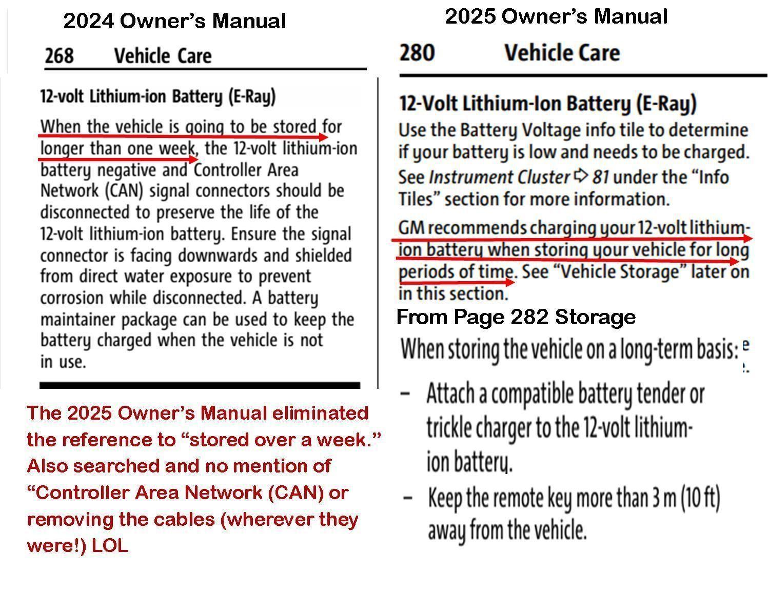

Hmm, had only seen that "one week" mentioned in the 2024 Owner's Manual and ONLY for the 12 volt Li-Ion battery!

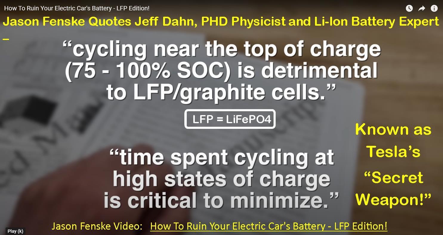

First there is no Sulfation in a Li-Ion Battery! The 2025 Owner's Manual eliminated that statement. See lower Pic I made:
Second, with my E-Ray 12 Volt LiFePO4 battery tests have found the alternator only charges to ~13.3 volts which is ~90%. The GM Recommended and sold Charger is for both Li-Ion AND Lead Acid Batteries. The same one sold for all 2025 C8's. I found after 24 hours after charging (which is recommended to check battery voltage after charging, it is also ~13.3 volts. Note it was only 13.37 volts immediately after the charger showed fully charged and unplugged.
Some dedicated Li-Ion chargers can change to as high as 14.4 volts. If using in an RV and want max capacity when parked, might be useful. Jason Fenske has a number of video's on EV and other Li-Ion batteries quoted what Tesla calls their secret weapon when it comes to Li-Ion batteries, Jeff Dahn. His lab has done a lot of research for Tesla (and I'm sure others.) He's a PhD Physicist.
He discusses the dichotomy of charging to 100% versus a lower level. He shows why Ford for example would say charge to 100% about once a week. It has to do with estimating the charge percentage, important to EV user. However Ford also states if charging for a long term only charge to 50%! He quotes the Jeff Dahn report which in extensive testing even charging to the same capacity of 0 to 25% and 75 to 100% the high charge level reduces battery life. Jason goes on to explain the technical reason. He also explains why I found when installing the GM charger it went to 80% charge instantly from my 13.27 volt start BUT took 4 hours to charge to 13.37 volts. His analogy is great, the negatively charged Lithium have to find a place to "park" in a crowned lot!
PS: Jason (Engineering Explained) is a mechanical car expert. He states in the video he has been reading many electric power vehicle technical articles. He has made a number of related video's. Now with my HEV E-Ray and wife's PHEV BMW X5 SUV (where in two months have only filled the car once with gas because we made two ~225 mile trips to visit a sick friend.) The remainder of the total 1443 miles were all ~40 to 50 mile local trips/day have all been on battery, charged when plugged in at night on low cost Off-Peak power cost! Trying to lean more about the technology and better Jason reading all the tech pubs than me, and summarizing in videos!
This is one clip from The Jason Fenske video. He quotes tests made by a person Tesla quotes as their secret weapon in battery technology, Jeff Dahn. They have sponsored some of his work. He notes Ford says charge to 100% about once a week so can properly calibrate the battery capacity display (important to an EV owner.) BUT they state for long term storage only charge to 50%! Dahn's tests show that has much battery life!
GM fixed the 2024 Owner's Manual misstatement in 2025. Was not logical to have to charge a Li-Ion battery every week. It lead to speculation (including by me) that for some reason the E-Ray had a high parasitic current draw Tadge Juechter admitted that was not correct but until the 2020 Owner's Manual there was still speculation!
RKCRLR's speculation is interesting BUT IMO the GM misstatement re the Li-Ion 12 volt battery did not relate to Lead Acid Batteries. No explanation of why it was in the 2024 Owner's Manual. Putting the E-Ray 12 volt Li-Ion battery on a charger weekly is not logical. As Tadge agreed in the Jay Leno video and his statement to me in an Email, quoting: "Li batteries are actually better than lead-acid for sit-time." All reports reports say is true, with some stating it can "sit" for several months and still start the car.

Jerry, the RKCRLRs hypothesis and the 1 week thing both were in context of the FLA battery, or course. The literature to which I referred, where that statement appeared and still appears, is the Getting to Know Your Corvette, that I think may still come in the owners package. Attached is the statement found in the 2025 version of that. It does not, but probably should have a comment regarding its applicability to the LI starting battery in the e-ray.
The manual I have for the CTEK that came with my 2021 say its is ok for LI batteries. That was pre-eray but think it might be true for the battery in the eray - but I'm not sure its true for all LI batteries - the AnitGravity battery webiste says their battery can drop right into a car that was using an FLA with no issue and no adjustment to the charging system, but also says that for external charging, it requires a "special" charger.
This is from the Getting to Know Your 2025 Corvette
This is from the manual that came with my C8 CTEK device
