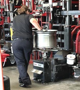

Discount Tire is privately owned by one family. They have >1100 stores in 38 states. But as any store they are staffed by folks they hire!
Our local DT store moved to town ~2017. Recall since I bought Tire Insurance for my 2017 Grand Sport when the car was a week old, soon after it opened. Fortunately never had to use it.
  • Bought tire insurance for my Wife's new 2018 BMW X5 SUV. It way more than paid for itself as she had two nails near sidewall and got two new tires. Also had two reparable Flats
  • Bought insurance for my 2020 C8, and needed one rear rear tire and one flat fixed," Free To Me."
  • Bought for the wife's 2022 BMW X5 SUV. Needed new rear tire within a few months, one tire plug/patched,
  • Bought DT Tire Insurance week one for my 2024 E-Ray. Had two tires with nails Plug/Patched and a rear requiring a new $650 tire (I have the ZER Option summer tires)
  • Bought insurance week one for my wife's 2025 X5 SUV PHEV. So far luckily no nails!
Our Discount Tire Store Has Very Knowledgeable Folks. Have done great work and not dinged a wheel. Now I use a method to get their best folks to work on my Vettes. I ask the store manager for his "Best Tech" and tell him I will give a $20 tip for no wheel dings or marks! All have gotten the Tip. Not easy changing wide low profile run flats as my E-Ray 345's on 13 inch wide rims!
