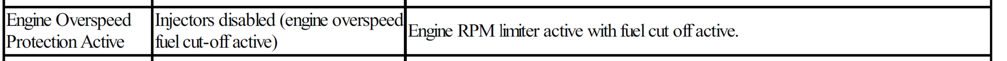

Default engine overspeed protection
Not to be confused with the Maximum Downshift Inhibit function, the so called "rev limiter" is called Engine Overspeed Protection in the version of the Service Manual that I have. It works by invoking the "Fuel Cutoff Mode". There are other conditions that will also invoke the fuel cutoff mode, such as extended, closed throttle coasting. As noted now in several posts, the function that prevents engine over-revving caused by downshifting to a gear too low for the speed of the car is called Maximum Downshift Inhibit, which is described in the Owner's Manual along with the speeds above which a downshift into a particular gear will be prevented.
Both features are implemented in software using sensors for the relevant parameters, one by invoking the fuel cutoff mode, the other by inhibiting the requested downshift (or in automatic mode by not requesting a gear that is too low).
