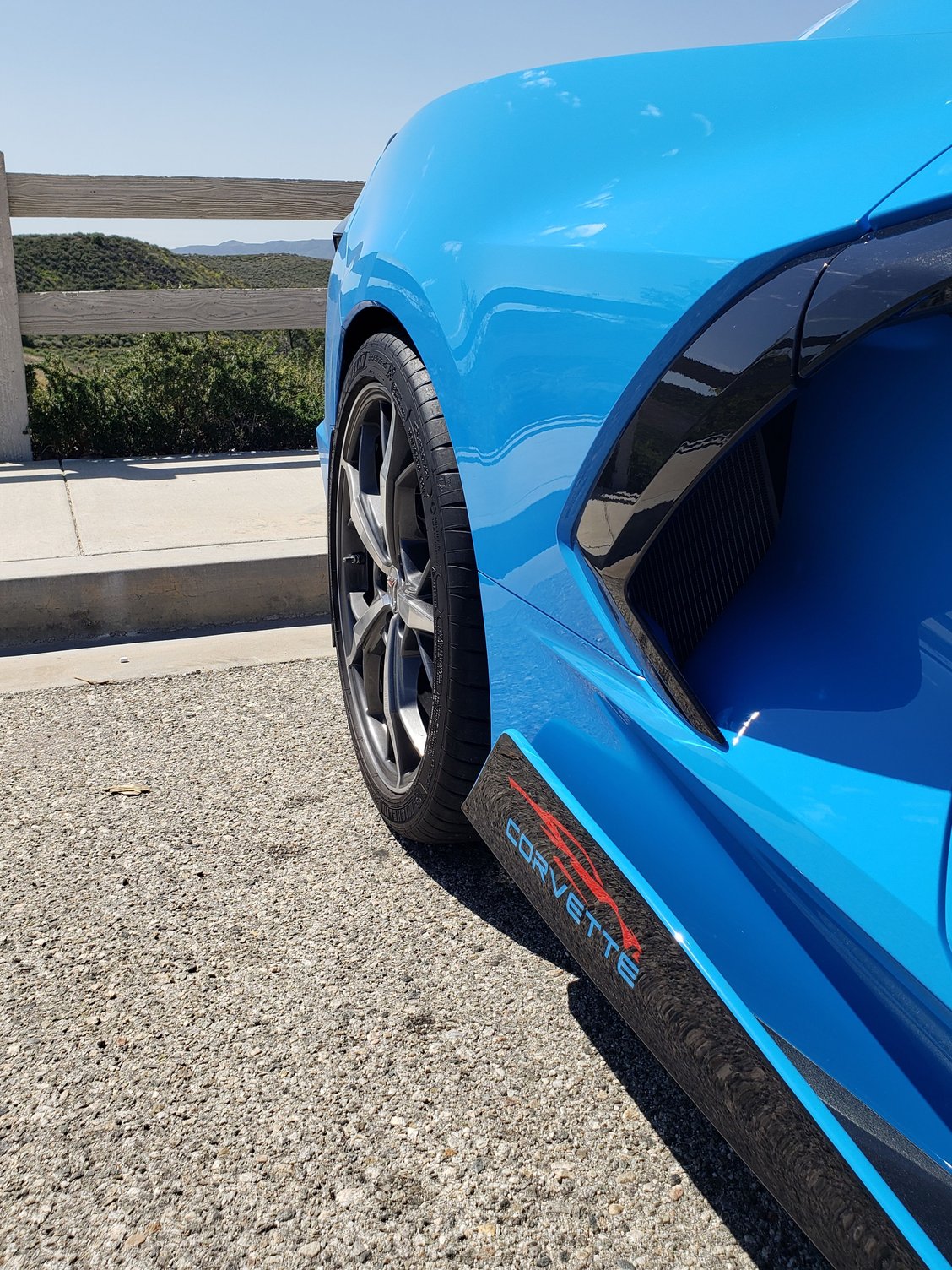

My old school opinion of spacers is to stay clear. But heard so many use them now. Brings the C8 wheel out flush with the body, for a much better stance. Thoughts? C8 Corvette 20mm Wheel Spacers | Paragon Performance

I use them. 20 mm Paragon. No problems so far.

I've also had Paragon 20mm spacers on my 2022 for 3 years. No problems at all. The spacers, and lowering it 3/4" give it the stance it was meant to have.

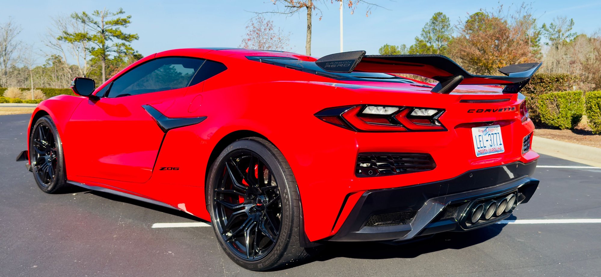

Hey bud, you forgot to mention your C8 model. In my case for my Z06, I opted for 20mm Hub Centric Spacers from
Wheel Accessories Parts Wheel Accessories Parts
on Amazon for $56.52. They are made of Forged 6061 T6 Aluminum and fit perfectly, no issues and are not overpriced like other brands.

I asume that you have a Z06 since anything over 25mm would require to shave the studs. I stated on a previous comment that I have 20mm spacers on my Z06 but it was an error, they are 25mm. 30mm are the thickest spacers that you can put on a Z06 with factory forged aluminum wheels (don’t try on carbon wheels, they don’t fit at all), but I didn’t feel like shaving the studs.

I got them on Amazon, they are hub centric and the best quality forged aluminum. Please click on the link above the red Z06. The tires are now flush, it looks awesome.

With a little research I've used off brand spacers on other vehicles and have never had issues. That 25mm spacer looks good from the pic, do you have another shot that shows it better?
