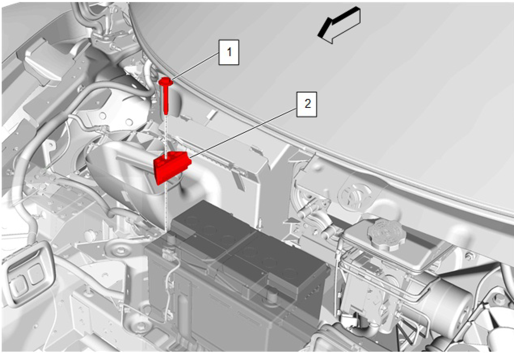

Now I just have to figure out how to the the battery out. I have the top strap removed and the terminals disconnected. Apparently there is one more anchor point before this thing comes free. Can't find a video that gets to that point. Nothing is easy anymore.

There's an extra bolt at the bottom of the battery tray that needs to be removed. Most online videos never mention that or show where it is. Tight space, but I got it removed. It's important to note the positioning of the two pieces. Also, be careful not to drop anything.

This one? Edit: Our posts crossed. I see from your previous post you found it.
