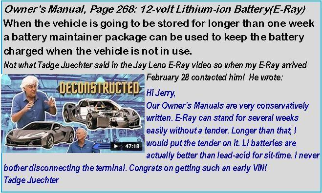

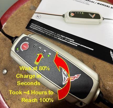

FWIW, although my 7 Vettes have all been DD's, when I got my 2014 C7 I bought a CTEK GM Logo equivalent charger I seldom used. Retired in 2000 and don't have to drive every day. But typically always drive a few times a week the ~50/60 mile round trip to town. On the trip to town, if car sat for ~4 days, it charges to the 80% capacity GM allows (to save energy.) Been on vacation with my two C7s AND my 2020 C8 for 3 weeks. Did NOT install the charger even then (too many lightening storms in summer and fried enough things plugged into the garage.) Plus GM says NOT needed.

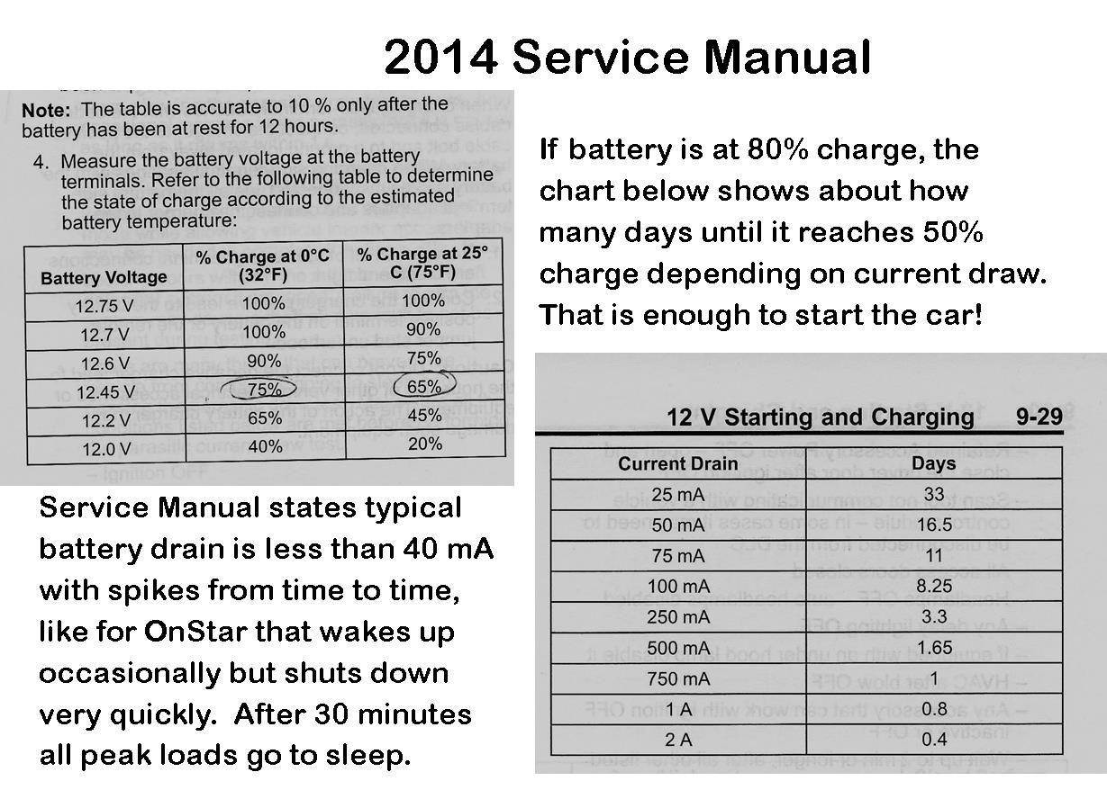

@Andybump measured the parasitic draw of his C8. When all the battery saving circuits are fully activated (all by 20 minutes) he measured the parasitic draw at <10 milliamps. that is equivalent to a 0.12 watt bulb!
Below is what the 2014 Service Manual says about how long the car can sit and the battery still start the car:
Starting from 80% charge (where the alternator will charge the battery to save energy like many modern cars) even a 25 milliamp (mA) parasitic current draw can start the car after 33 days. With ~10 milliamps would be longer. Folks with C7's reported their car was at an airport for 5 weeks and started fine. I do monitor my battery voltage. After 3 years if it dips too low I replace it! Far easier than with a DD screwing around with chargers when NOT needed! It's not your father's Corvette!
PS: Funny for my E-Ray with it's Li-Ion battery would have thought it could be much longer. But spent the last year investigating and Conclude in my Doc pdf:
http://netwelding.com/E-Ray_12_Volt_Battery.pdf
Considering: 1) Tadge’s Statement; 2) Since we do not know the exact E-Ray Parasitic Current Draw: My Best GUESS is install a Charger before sitting ~4 Weeks.
This is what Tadge Juechter Emailed me soon after i got my E-Ray in February 2024, answering my question about how long the E-Ray Li-Ion battery can sit :

@Andybump measure the parasitic draw of his C8. When all the battery saving circuits are fully activated (all by 20 minutes) he measured the parasitic draw at <10 milliamps. that is equivalent to a 0.12 watt bulb!
The chart shows, for whatever battery size that was, 33 days from 80% to 50% for 25 ma. So for 10 ma I suppose that is roughly 82.5 days, but probably does not account for the charge decay that happens even if there is no draw. Still it will be long time making it look like a maintainer is not necessary.
But, is "enough to start the car" really the only consideration? Many say that its best for battery life to not let it drop below 80%. And also, many say (and not without sources) that charge/discharge cycles is what shortens battery life. And cycling between 50% and 80% charge would probably be an example. So it would be my opinion that allowing it to drop to 50% is not really a good idea. Still - it takes a long time to get to that level, so yeah you can go a few weeks without concern (although GM recommends using it if more than week don't they?).

Nope that "One Week" was silly for the E-Ray and IMO for lead acid batteries. have let mine go 3 weeks with no issue. However admit for our last 3 week cruise when I had the C8 I installed my old CTEK charger for a day when there were no thunderstorms and then removed. It brought the lead Acid battery to 100%
As noted below, Tadge agreed the 1 week was not right in his Email he sent to me soon after I got my E-Ray in Feb 2024. Was wondering as even the paper copy that came with the car said the same "one week." So my suggestion even for the Li-Ion is 4 weeks max.
This is what the difference was between the foolish working in the 2024 Owner's Manual for the E-Ray and the current 2025!
Unlike a Lead Acid that can get low and be recharged as can a Li-Ion BUT Li-Ion batteries contain internal contactors that open the battery at a prescribed low voltage FOR THAT BATTERY as protection. Quoting the 3 page GM TechLink re the e-Ray 12 volt Li-Ion battery:
Under VoltageIn an under-voltage condition, the relay will open if any cell drops below 2.5 volts, which may occur when the battery is discharged below 11 volts. The relay can be closed under normal conditions by charging the battery using the EL-52800 E-XTEQ Diagnostic Charge Battery Station (DCBS)
The GM sold charger prescribes pushing the large Reset button for 10 seconds on the charger to close those protective contacts.
Large Red Reset Button on front left needs to be pressed for 10 seconds to close the protective low voltage contacts. (However a member with what appeared to be a dead E-Ray battery did that with not help. The dealer used a large Jump Box to start.)
