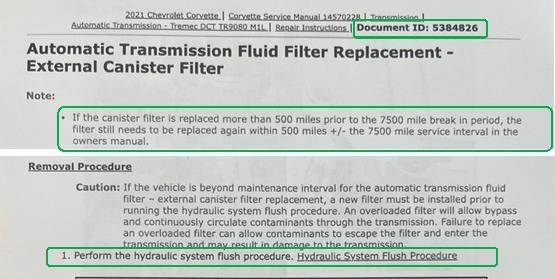

First: I knew when I had my DCT filter charged on GM's Dime year 1 with ~3000 miles it was required again at 7500 miles. There is some debate on the exact time the Doc below published BUT when I had my DCT fluid Changed Year 3 with ~8000 miles I knew in August 2023 when that occurred (and so did the C8 Trained Tech I use) that the DCT filter required changing AND I could wait until 8000 miles.
You may have learned late BUT it was known when I had my DCT filter charge year 1 with ~3000 miles it was needed again at 7500 miles to maintain DCT warranty. Yep did not know the +/-500 miles until later but positively knew well before I had mine changed again at ~8000 miles year 3 in August 2023. Well before that I believe all of 2023, that is why I waited to about end year 3 to get max time for the DCT Fluid change required every 3 years regardless of low miles.
So NOT accurate to say anytime in 2023 "At that time there was no directive to change it no earlier than 7K miles i.e 7500+-500 miles."
Yep when I paid for my 3 year service I knew a new DCT Filter was required and my having it changed at ~3000 miles year one gained only my peace of mind! And so did my C8 Trained Tech. I waited till end year 3 to get max time on the new fluid charge and for my engine oil/filter requiring change.

First: I knew when I had my DCT filter charged on GM's Dime year 1 with ~3000 miles it was required again at 7500 miles. Some debate the exact time this Doc was published BUT when I had my DCT fluid Charge Year 3 with ~8000 miles I knew in August 2023 when that occurred (and so did the C8 Trained Tech I use) that the DCT filter required changing.
You may have learned late BUT it was known when I had my DCT filter charge year 1 with ~3000 miles it was needed again at 7500 mils to maintain DCT warranty. Yep did not know the +/-500 miles until later but positively knew well before I had mine changed again at ~8000 miles year 3 in Auguest 2023. Well before that I believe all of 2023, that is what I waited to about end year 3 to get max time for the DCT Fluid chage required every 3 years regardless of low miles.
Yep when I paid for my 3 year service I knew a new DCT Filter was required and my having it changed at ~3000 miles year one gained only my peace of mind! And so did my C8 Trained Tech. I waited till end year to get max time on the new fluid charge and for my engine oil/filter requiring change.
Yes GM said change the DCT filter 7500 miles but similarly I change my engine oil a bit earlier than recommended. For example If an engine oil change requirement is to change at 7,500 miles and I change it at 6K miles, I know of no manufacturer's make or model that would tell you it's required to change it again at 7,500. How would one expect to know this about the DCT filter until the notice was communicated and then, for me, it was too late.
I stand by my statement that at the time I had my filter changed the +-500 mile requirement had not been communicated. I received my notice way after that point and I'm interested to know what GM's stance would be if I had a failure. As the other poster stated it won't be a problem if I don't but still I was curious to what other people thought if a problem did happen.

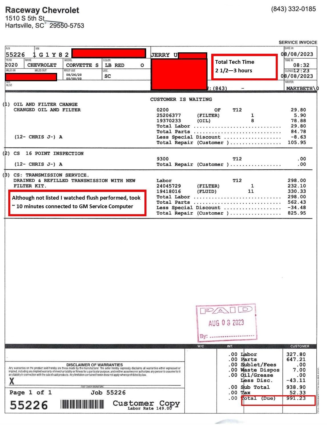

You and your Tech may not have known BUT it was clear to me well before August 2023 when I had mine done it was +/- 500 miles. I believe that was known sometime in 2022!
Here is why:
I had mine done in 2021 when my C8 was 1 year old with ~3000 miles. Because:
  • Folks were getting DCT CELs and when they brought the car to the dealer their tech was told by GM Service just do a Flush, no new filter no change of fluid just a FLUSH. It most cases it was reported the CEL was gone and did not come back.
  • When I crawled into my garage at 2 to 3 mph watching the driver mirror to garage door molding gap, keeping it below 2 inches, there was a chatter or somewhat jumpy movement. After ~1000 miles it was perfectly smooth. I attributed that to the high spots wearing off the 1st gear (and all odd gear) clutch. I wanted to get that clutch debris out of the trans. Mostly took advantage of the GM Free offer to get a free Flush.
There was a lot of discussion on the forum in 2020/2021 about the tolerance in the 7500 miles. A Member asked a GM Exec at a race and was told +/- 500 miles. He reported. Soon after it was published. May be the Doc I posted BUT I knew in all of 2023 which is why I waited until I had ~8000 miles.
WILL GM Deny Coverage?
If the DCT fails GM may not pay as IMO Opinion, from understanding GM supplier agreements for things like Transmissions, Steering etc they buy, the Supplier signs an agreement saying for GM's Warranty period they will replace the product AND reimburse GM for what they allow dealers to charge them for the replacement.
The supplier can specify "required maintenance." So IMO that is Tremec's mileage/range and decision. Heck I self insure for many things BUT would not for a $20,000 DCT. Hope your DCT doesn't fail during warranty!
PS: You are not the 1st person to raise the issue. The answer doesn't charge based on when you and your tech knew!

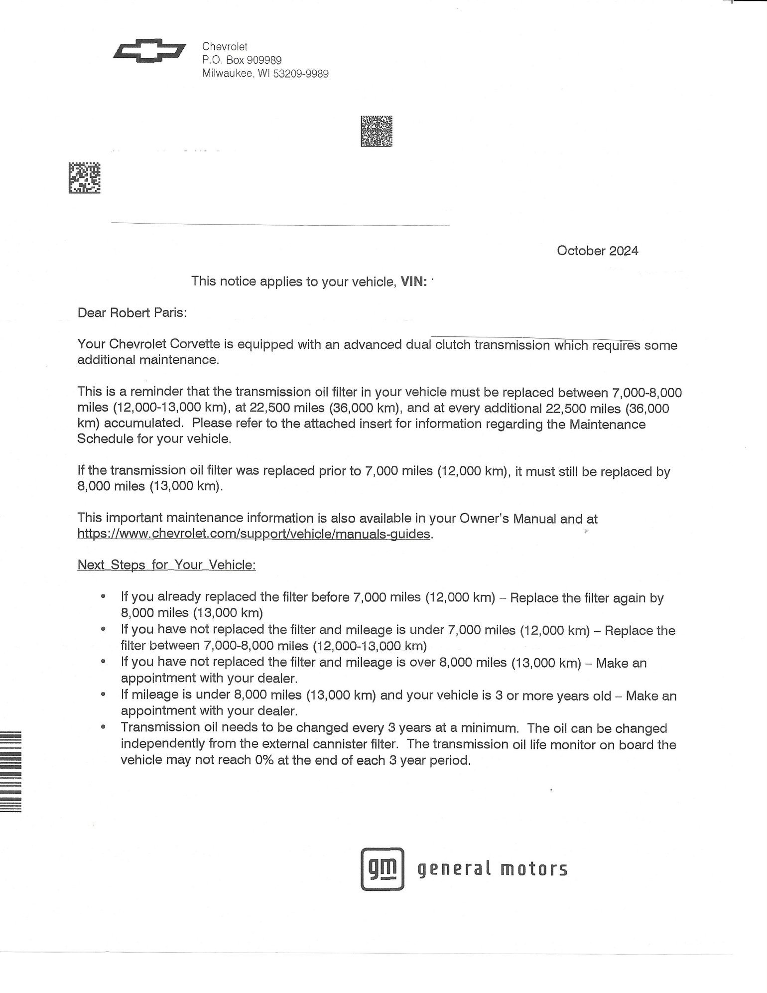

GM notified affected customers by letter in 2024. If one replaced their DCT filter early and it has not been changed again and their car has over 8,000 miles on the odometer , I would think that they would be expected to change it again as soon as practicable after receiving this letter. Pro hint: Do not perform scheduled maintenance ahead-of-schedule.
The OP's point is that he changed his filter at 6579 miles in Nov 2023, and when he received the letter he already had 9K miles on his car. He can't go back in time to meet comply with the letter and the letter doesn't say what to do if you changed your filter early and now have over 8K miles on the car.
And the wording in the letter is misleading in stating it is a reminder. It is only a reminder for those with 2025 or later cars. If you use the link in the letter to review the maintenance requirements for the DCT there is nothing in 2024 or earlier manuals stating if you changed your DCT filter earlier than 7K miles you need to change it again between 7K and 8K miles.

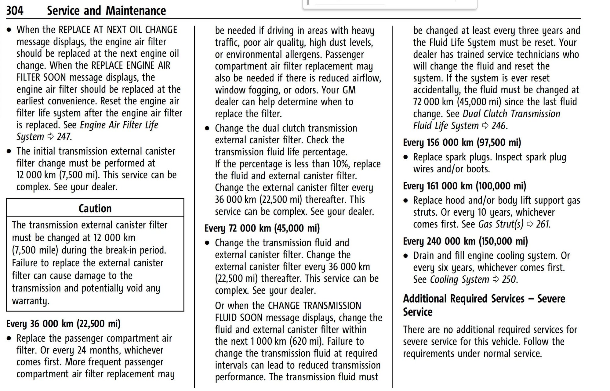

Its pretty clear in the owners manual of my 2023, page 304. It says to change it at 7500 miles, the way I comprehend this, if it was allowed to be changed sooner it would say so, so my assumption was it has to be changed at 7500 miles, even before the letter was sent out confirming this. Could they have made it clearer? Yes, they could have
That caution note isn't in my 2020 owner's manual. And many people would read that note and think something like "wow, that sounds important. I'm going to over maintain and change my filter at 5K and 10K miles to be sure I don't have any problems".
