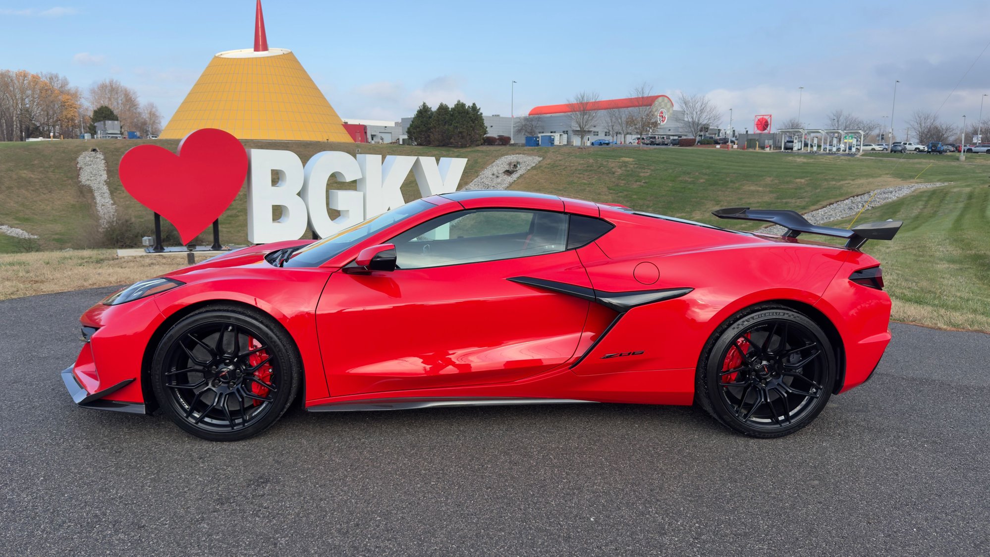

Thanks for that information. It seems the C8 needs a reboot once in a while. Great looking Z06.

Love the look of those wheels Sometimes my rearview mirror camera flickers, maybe I'll try the battery disconnect, Thanks for sharing.
