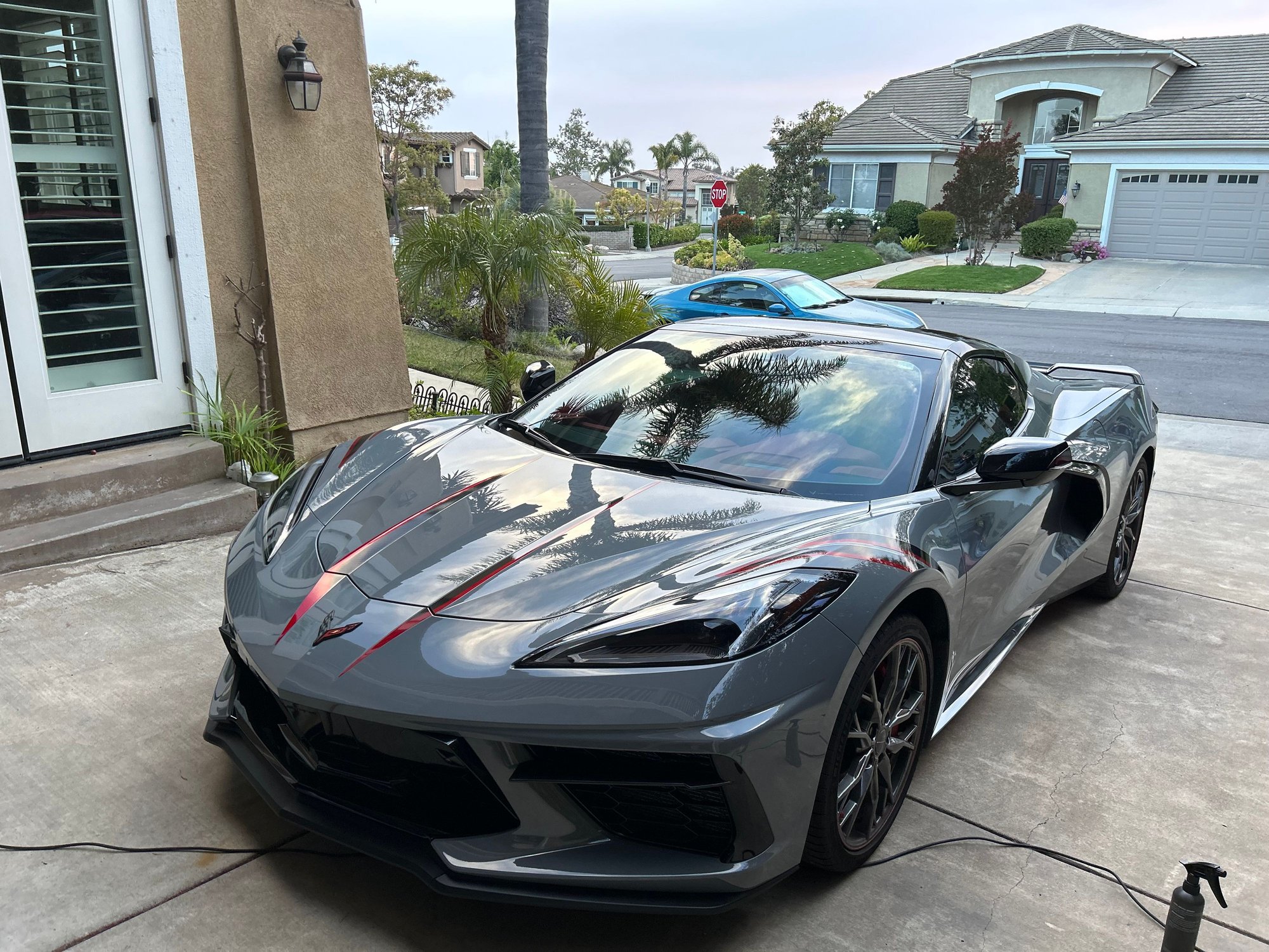

Stripes on top of the PPF and ceramic on top of the stripes and PPF. You will have an air gap if you put the PPF over the stripes which will vary in size depending on the thickness of the PPF and the quality of the installer. If the car is a dark color you’ll see the air gap more, I.e., white will be less noticeable than black. Here is an example using a custom stripe from Vettestripes with the stripes on top of the PPF and ceramic on top of everything…..

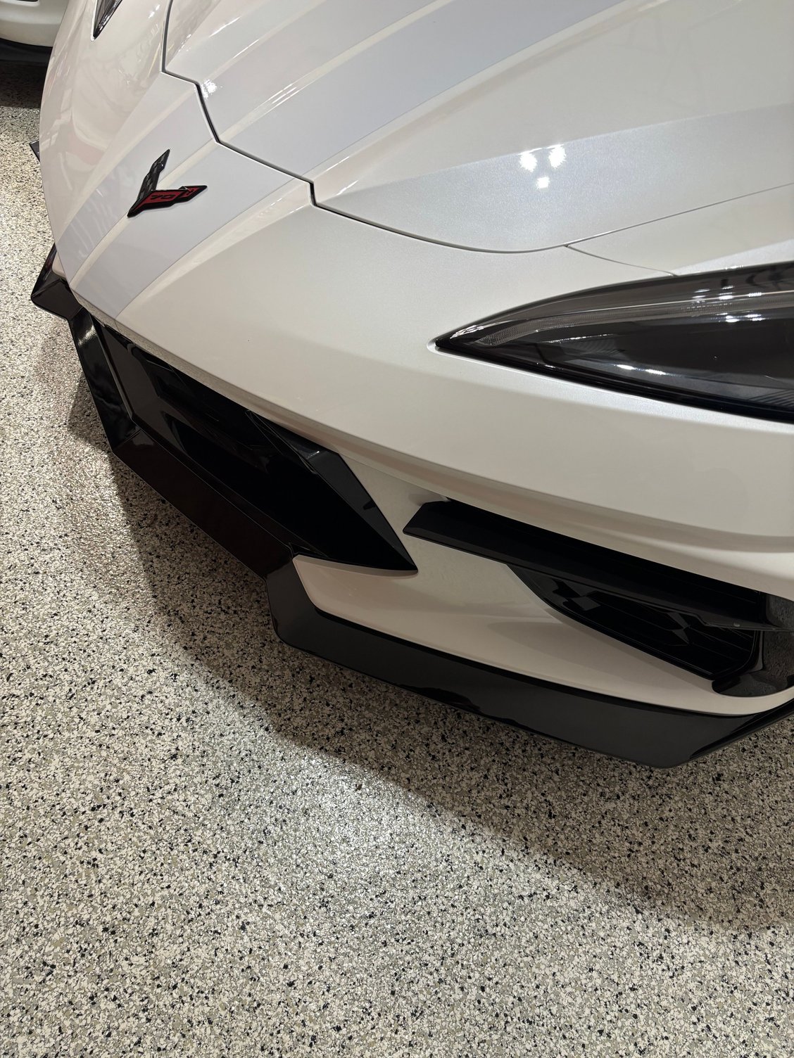

I bought my car used with PPF installed on the whole front and hood. It has factory stripes. They installed the PPF around the stripes on the front bumper cover and over the stripes on the hood. IMO it is better over the stripes. No edges to deal with and is a cleaner install.

That makes no sense ... wonder if nose was replaced and PPF installer that time said no way to going over the stripes. Showed to my PPF guy and he said nobody would do it this way - quite strange for sure.
Your car looks great in photos!

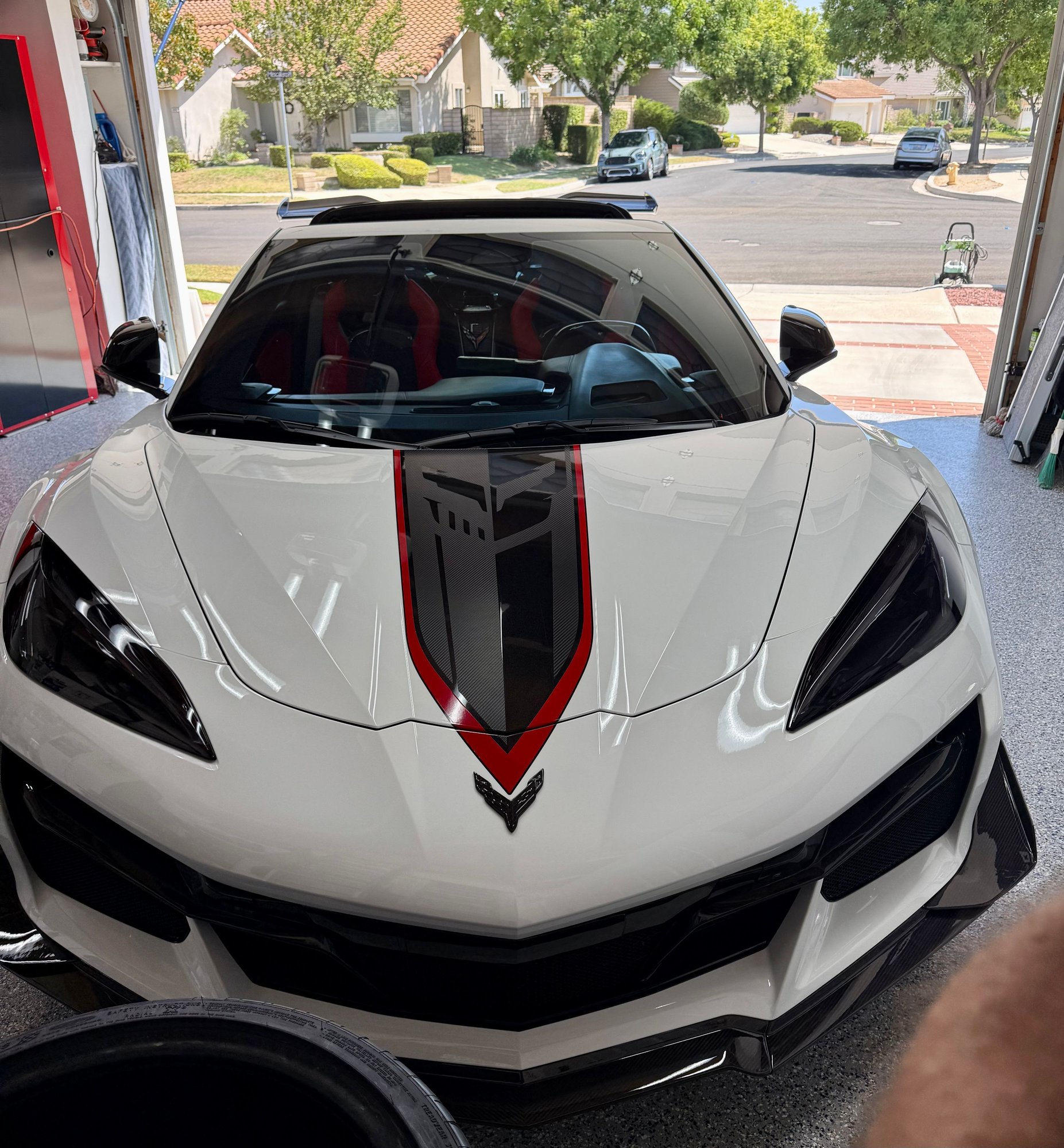

I have PPF on top of my full-length stripes. I didn't want the expense of buying another set of stripes and having them installed. Yes, there is a small air gap that is perceptible if you look close. That gap is more visible on some colors than others. My installer has two hoods hanging on the wall with PPF over the stripe on one and under on the other so someone can see the difference before going ahead. If yours doesn't maybe find one that does or hit so cruises before the season is over. You're likely to find an example of one or the other. As has been said, PPF on top also protects the stripe.

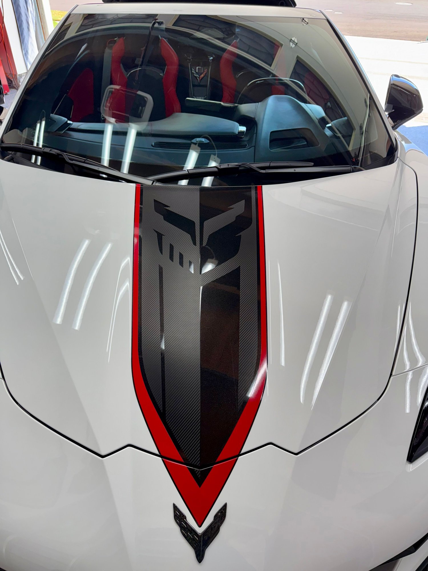

Stingray stripes with Xpel PPF on top
