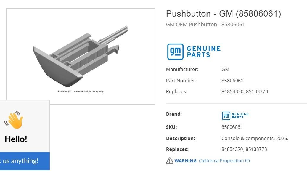

The new console button .#85806061
In my case the button would pop out when I closed the console. Pulled the button out and installed the new one. Gonna have to get the console door open first.
I have the same issue; car is under warranty. I just don't want to take it to the dealer.
So, you don't have the replace the whole thing? part number 85599089
The part number you posted was the whole console locking assembly. The number I posted was just the push button. Correct button only
Pushbutton - GM-85806061

Just to confirm does the new console button GM #85806061 also fit a 2024 C8 or is it only for the new interior 2026 and up?
Gm parts online show it as the wrong part for 2024 C8. If it is a redesigned/improved version I would like to upgrade my original button now before it has a problem.
Thanks.

GM Parts Direct says it is a replacement for the old part.
Thanks.
I have a 2024 C8 that’s the # I used
