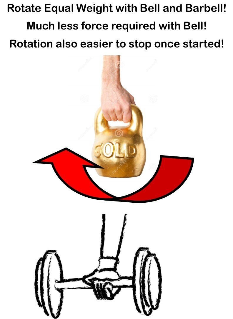

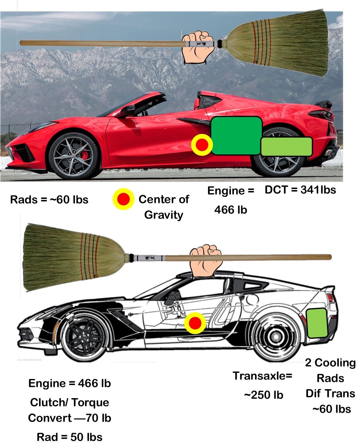

I was referring to your comparison of front brake rotor size! The ME C8 with 60% of it's weight on the rear wheels does NOT need the large front rotors as does the "Dynamically Nose Heavy C7 When Braking!" On a 1+ "g" stop the C7 has ~60+% of the braking load on the front tires! The C8 has more equal braking on the rear wider tires - a good thing!
I'm not a GM apologist, I just understand the laws of physics! It's where the weight is located that is important NOT "what some think is ideal 50/50 weight distribution!" Dr. Porsche knew that in the 1930's when he worked on the German race cars- all of which were ME's. He built the 1st Porsche 356 in 1948 as an ME BUT too expensive for 1948 Germany (recovering from WWII.) He used the rear engine/cheap transaxle VW and other parts of the "peoples car" for prodcution. Zora Duntov was involved with Dr. Porsche before he came to the US and understood the same thing! That is why the "Father of the Corvette" wanted a ME Vette since the mid '50s! In fact Zora won his class at Le Mans driving a ME Porsche in the 1954 while he was working for GM!
Try Andy Pilgrim's twisting broom approach to understand the ME benefit. IMO, his interview in February 2019 was to show the "FE Forever Crowd" why a ME Vette was needed when they were "having a temper tantrum" including expounding foolish 50/50 weight distribution statements! If his broom example is not clear try my commonly used simulation for understanding "Moment of Inertia" of twisting a barbell versus the same weight bell. Easier to turn and stop the exact same center weight location.
BTW F1 cars are ME with little weight on the ends. Very low Polar Moment of Inertia!
PS: I present this info NOT for the ~40 folks who posted on this Thread (about half shown as many vocal minority, including me, post 2+ times) as some of them have their mind made up! Rather it's for those who visit (over 11,000 on this Thread) some who actually want the info. Also learned many years ago- as it's common to quote- "a picture is worth 1000 words!"
