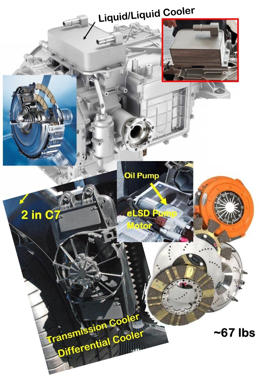

To avoid and apples and orange comparison, the DCT includes lots of "things" the M7 did not! Similar the extra weight versus the C7 A8 trans/dif with torque converter fluid that makes it work, two chassis mounted air/fluid heat exchangers, eLSD electric motor/pump and hoses mounted on the chassis and not part of the C7 trans weight.

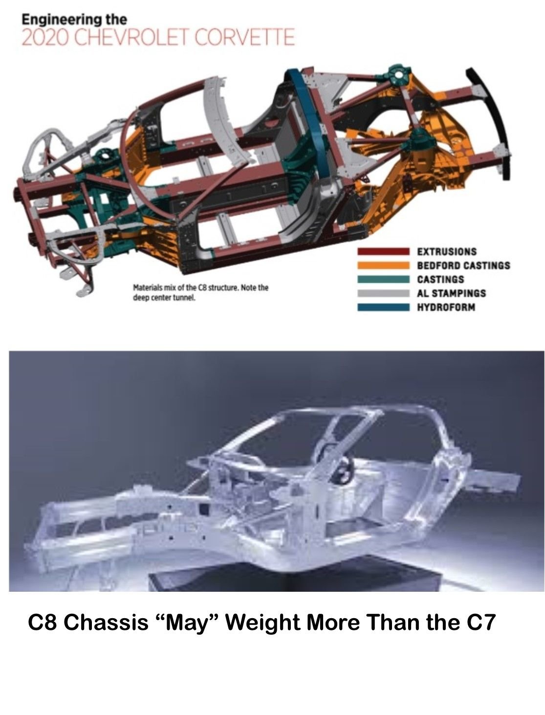

We don't know how much the C8 chassis weighs versus the C7. All those large high pressure aluminum castings (called Bedford in pic as that is where GM produces them) may be technologically great BUT to get the added rigidity and needed strength may add extra weight!

To avoid the apples to oranges - I wouldn't compare the manual C7 to the C8 it must be compared to the auto C7 where the DCT adds 100lbs and the Vert adds 77 minus the weight of the C7 vert. what maybe half, also there is a lot more to the interior vs the C7 most of the plastic is gone and replaced by aluminum and leather. I think it is safe to say at least 150lbs of weight gain is in the Trans, Vert and interior like 4 more speakers and a phone charger.

Don't think there is even close to a 150 pound difference in an A8 with dif and all the other "stuff" that makes a viable C7 transaxle system!
I did mentioned the A8 "slushbox," which no doubt weights more than the M7 and you have to include:
  1. The weight of the C7 dif, that is part of the DCT 341 lb weight.
  2. All the fluid in the torque converter required to make it operate.
  3. The two ~30/35 lbs each air/fluid heat exchangers (for A8 trans and dif coolers) with case and electric fan motors behind each C7 rear fender and the ducts directing air to them versus the liquid/liquid cooler integrated as part of the DCT
  4. The electric motor driven high pressure pump with hoses for the eLSD in the C7 that is mounted on the chassis where that function is included the DCT.
Would not be surprised in the C7 A8 "slushbox" with all that is needed to make a viable transaxle weighs somewhat more!
Would also not discount the chassis being a significant part of the weight increase!

Yeah that chassis is WAY beefier... maybe there is some truth to those "frame twist" rumors with the high po models. Very interesting to look at the two side by side. Hadn't done that yet.
