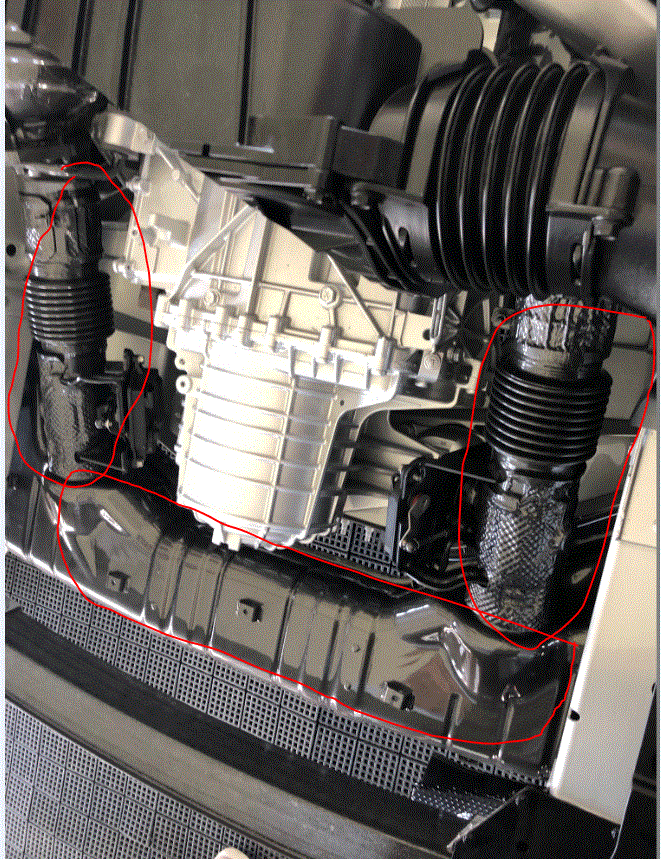

So this is what you have to deal with circled are the cats and a big muffler. See what after market can do with this.....

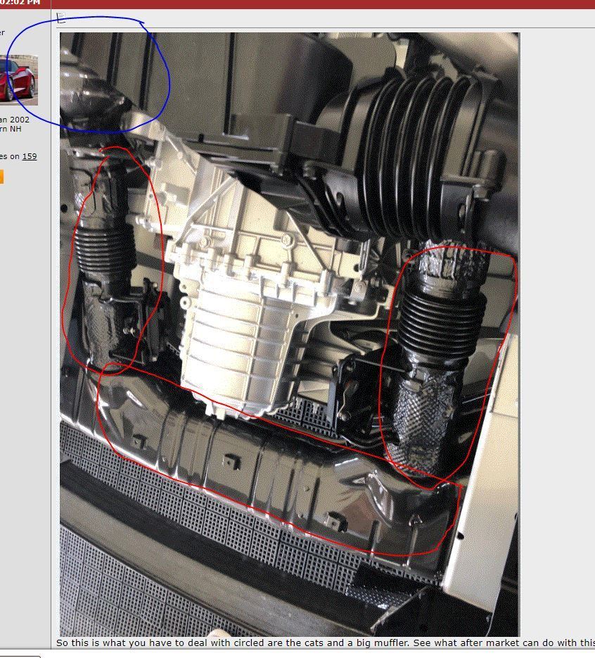

What you circled is not that cats. You circled the flex flange on the pipe between the cats and the muffler. If you look up additional photos you will see the cats right after the headers. There is a bolt on flange between the cat and the portions you circled. Easiest option would be to cut the pipes after the flex flange and just before the muffler and then straight pipe it or fab a replacement muffler. The AFM valves are located right after the flex joint. I suppose an aftermarket muffler could include additional valves to mount the afm controllers, at higher expense.

Yeah, one of the cats is way up top in that pic. See blue circle

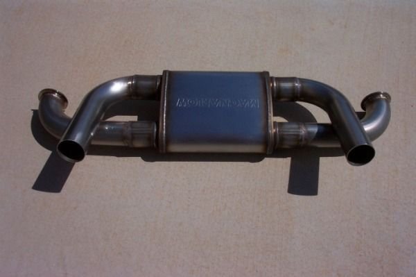

I'm certain we'll soon see some exhaust systems that are the equvialent of long tube headers that replace the factory cats as well and run down to the muffler attach area. down to something like this..
