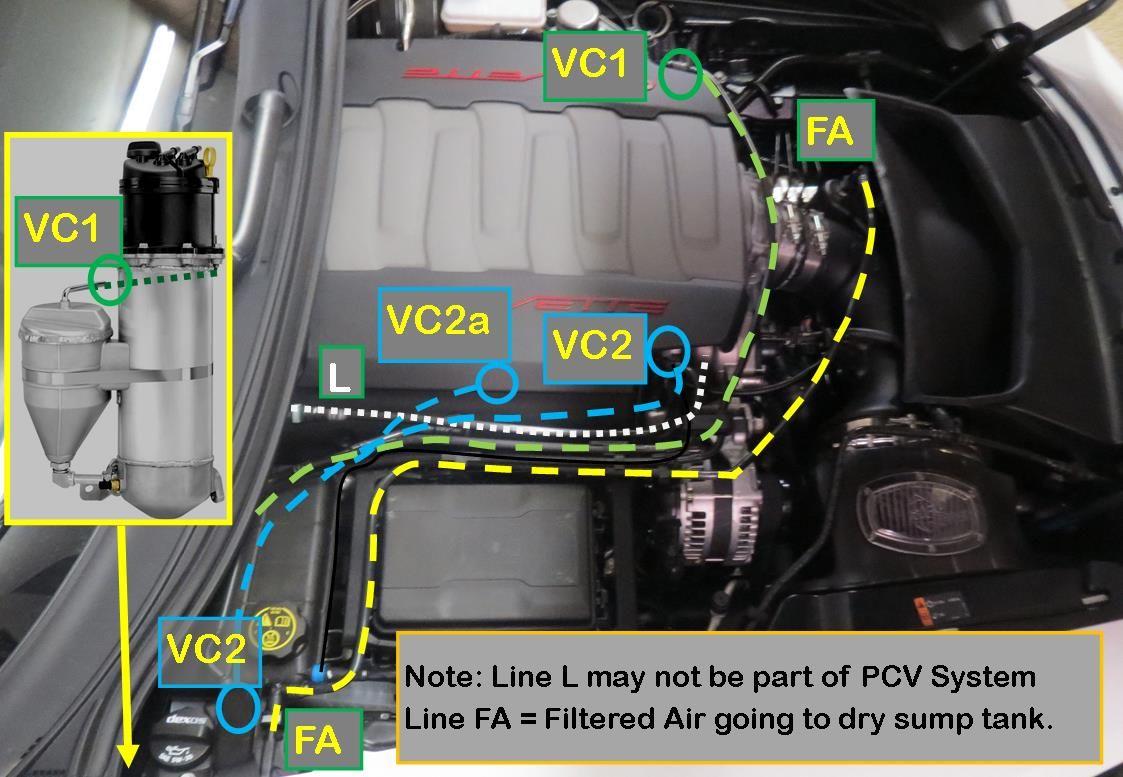

Had the same concern when I got my early 2014 C7 Z51 (built September 2013.) It was GMs 1st high performance engine with DI (where the intake valves get hotter than a grocery getter so more chance of baked on oil on the backs of the intake valves.) There is oil mist and some fine oil particles that are created when oil leaving the crack journals hits the spinning crankshaft, That comes into the intake from the crackcase through the PCV system. No gasoline to wash it away with DI. BMW and Ferrari were having issues with what is called "coking." Heck there were gasoline ads saying you needed "Top Tier" cleaning additives in the gas even with port injection where it did wash the valve backs! Pasted an old gasoline ad pic below from when their was gasoline washing the backs of the hot intake valves and without extra "cleaning additives" some coking occurred!
So I installed a quality "Catch Can" that collected the oil mist that came from the crackcase, condensed it into drops that had to be removed periodically. Like others I collected a few ounces/1000 miles. That was a few ounces that had no chance of baking on the backs of the intake valves. Removed it when I sold the 2014 and installed on my 2017 Grand Sport. GM said they "improved the PCV system used on the Grand Sport" and had some of that oil mist return through the valve covers instead of going into the intake. BUT there was still the same hose going from the crackcase to the intake and I still collected some oil. For all those who said it was a none issue, GM sure spent engineering time and effort to improve the PCV system for a NON PROBLEM!! However I collected only 1/2 the amount! Then saw a comment that "some oil" is a help in lubricating the valve stem SO REMOVED THE CAN!
GM is learning and probably has reduced the amount of oil vapor & mist going to the LT2 intake. Since there were no significant issues reported with the LT1, doubt there will be any with the LT2.
PS: Managing "Blowby" past the piston rings and oil vapor/mist in the crackcase has been an issue since the ICE was invented. Up until the 1960's there was a "Road Draft Tube" that just put the "stuff" into the atmosphere! Had a "roadcraft tube" on my '56 Chevy small block. The EPA rightfully said you can no longer dump that "stuff" into the atmosphere- burn it in the combustion chamber with the gasoline. The addition of a Positive Crackcase Ventilation (PCV) system started. Up until DI, gasoline passing over the intake passages and backs of intake valves (with extra cleaning additives, i,e, Top Tier etc gas) washed most of it way.

Hmm, year old post BUT doubt the large intake valves in the LT1/LT2 run cooler than the 4 valve/cylinder BMW engines that had significant coking and where some cars required walnut shell blasting to remove it at ~50,000 miles.
SIDEBAR
Intake valves are exposed to the >2500 F combustion temps and a major amount of the required cooling (stainless steel not strong at those temps and getting close to melting) occurs at the valve seat. The large valves have a longer heat conduction path to the valve seat than two smaller valves that coked in BMWs etc. . However valve temps are also function of power used. The large 6.2 Liter Vette engines (in normal use) are operating at a lower rpm and with less stress of the typical European performance engine where coking was an issue, BMW, Ferrari. In fact it was mostly an issue in "high performance engines" not grocery getters. So GM's first use in a high performance engine was 2014 in the C7 as the C6 did not use DI. So GM no doubt learned from competitive prior high performance engines
Also, although it was said "there was no issue with the 2014 LT1," GM spent a lot of engineering time and effort to improve the dry sump PVC system in my in my 2017 Grand Sport from my 2014 Z51. They didn't do it for fun! I collected 1/2 the amount in my catch can of crackcase "stuff" in the Grand Sport. IMO for normal street driving a catch can was not needed in the later design dry sump. Expect they improved the LT2 even further and for street driving a catch can is not needed in the LT2. The key, IMO was reducing the oil and oil mist being pulled into the intake manifold. They said they accomplished that in the later dry sump design that was much different and more complex that the one in my 2014 Z51.
Tadge said in a forum post they find that the coking that occurs is cosmetic. He didn't say it didn't exist, just that the buildup was not a "performance issue." The larger intake passages in the single valve engine may be another factor allowing more build-up without a significant performance degradation. GM knows but has not discussed.
Before I added the catch can removed from my 2014 to my 2017 Grand Sport I investigated the changes in PCV system best I could to be sure I did no harm. Installed but once I saw I was collecting ~1/2 the oil I removed it as it wasn't needed and a comment in another technical article said "some PCV oil is useful to lubricate the intake valve stem." No doubt they improved the LT2 further.
Defined the entirely different routing of PCV lines etc in my 2017 Grand Sport from my 2014 Z51. Among other differences was their was no line bringing filtered fresh air into the crackcase in the 2017 versus 2014. Also lines were coming from both valve covers.
Installed a pressure/vacuum gauge in the one line going from the dry sump tank to the air intake tube after the air filter. It appears to perform the the function of the 2 lines in the 2014. It takes air pulled into the dry sump tank by the oil/air scavenge pump that has to be feed back into the intake AND provides sufficient air so a separate line, required in the 2014 was not needed.
