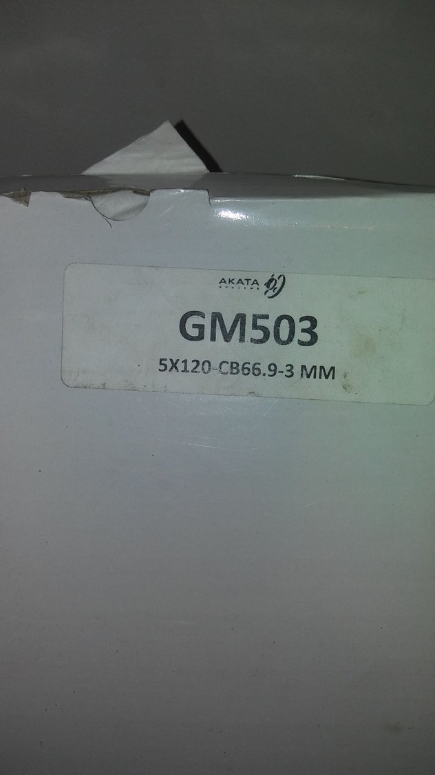

I'm scratching my head here a little bit and I can't figure out why ? The test fit went smooth I thought and everything lined up good with center to center lugs. Yes the hub is 66.9 on the c8 and earlier c versions are bigger, these wheels are 70.3 so hub rings are coming to tighten up the 3+mm gap. As an aside, I have a 6th gen Camaro and the wheels are interchangeable in regards to hub bore and bolt pattern. I have spacers in the garage that I never used on the SS and lined them up with the c5 wheel and the pics are below. They line up perfect. Is it because they are replicas that makes these different ? Thoughts ? The lug holes are clearly not 12mm either.

Those look pretty darn close like I can't tell in the pick. So a 120.65 should be wider than a 5x120 by .13mm per hole. Now that is not a lot but think about a conical lug nut biting down on the wheel, it would bend each stud by that amount when torquing the wheel down. I am not sure I would feel ok with that. Looking at your pics though you could easily see how someone would go ahead and use one if they weren't paying attention to those little details.
