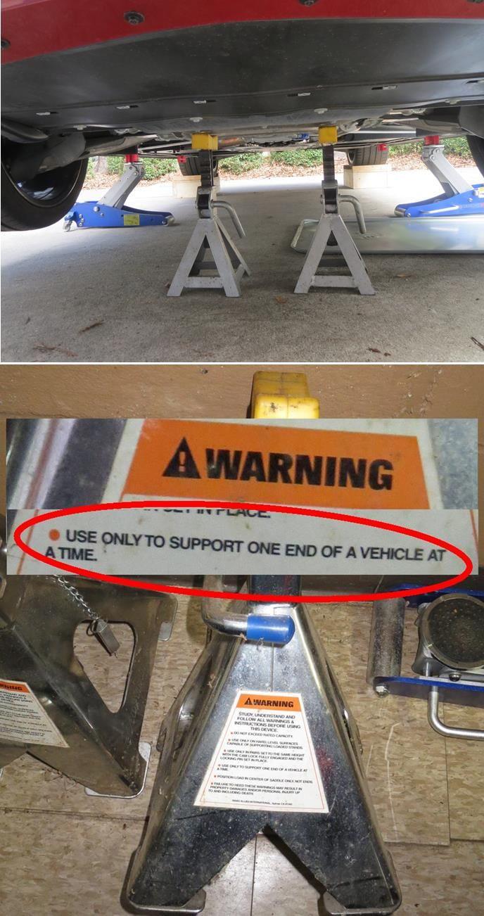

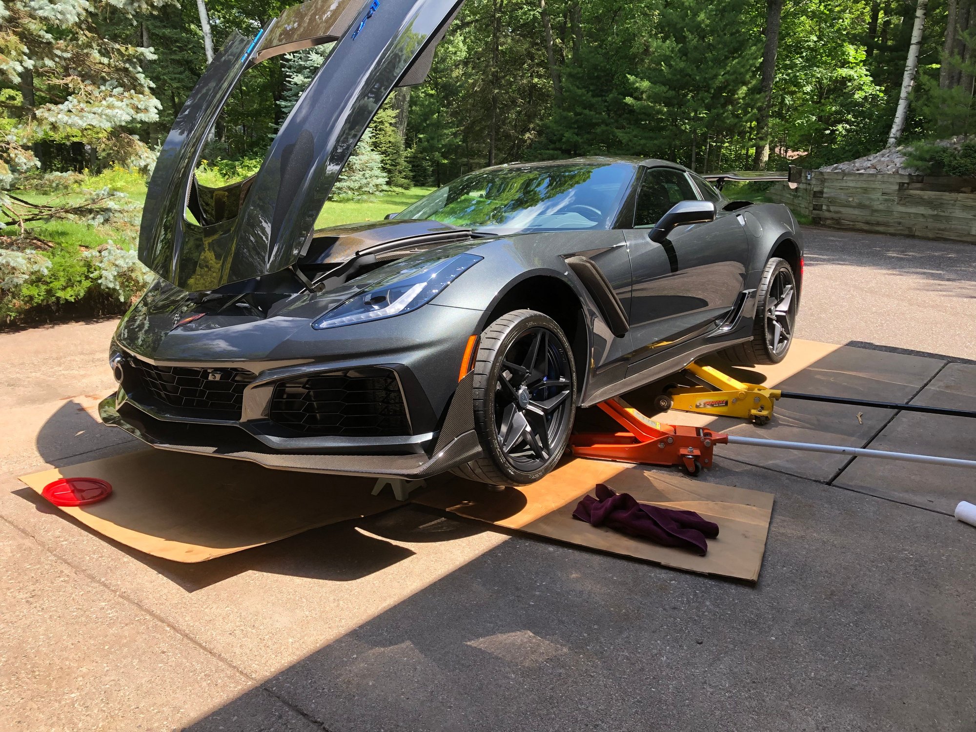

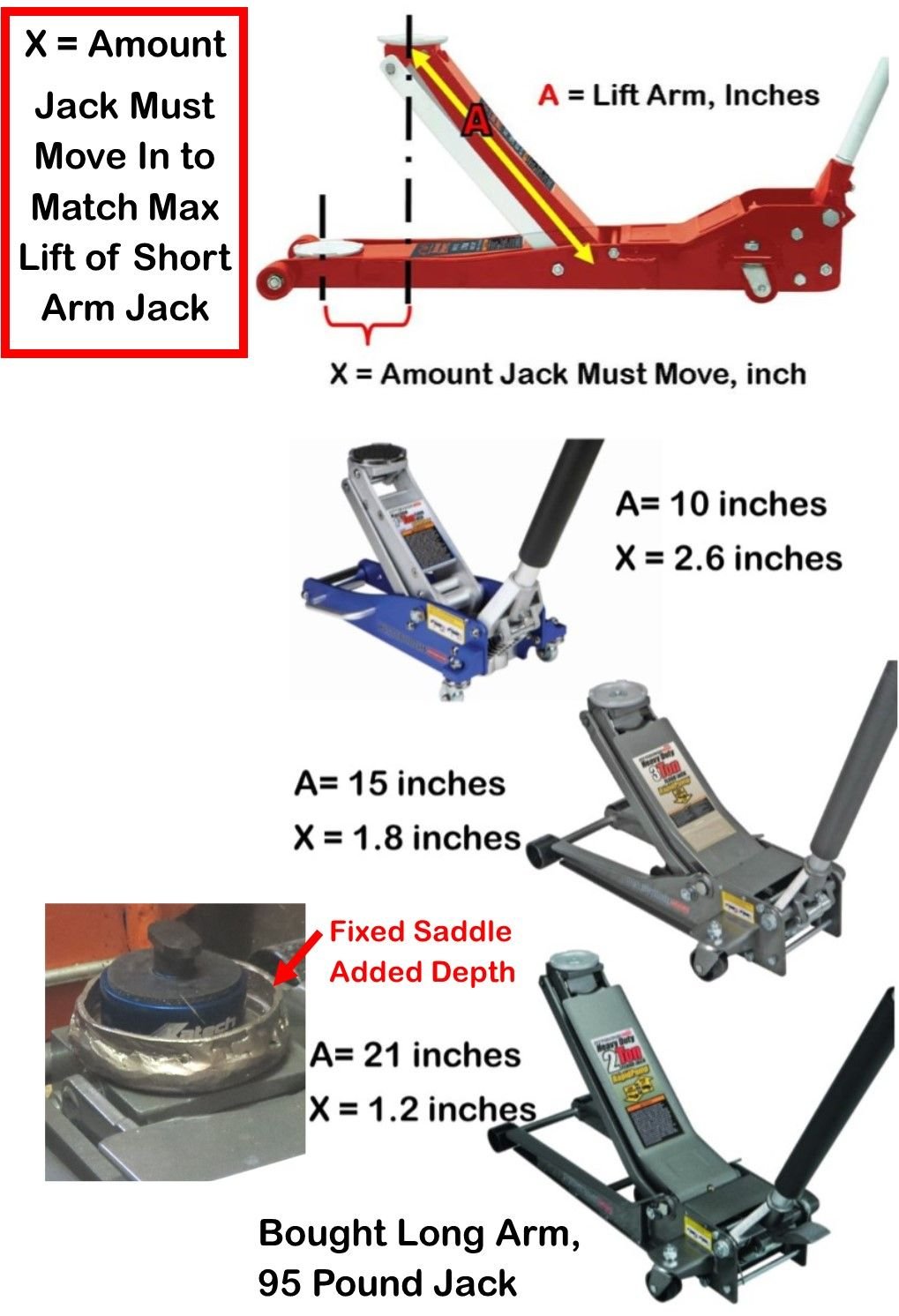

Hmmm, some of the words were fine BUT it starts off NOT doing what he said should be done!
He cautions on a number of things BUT IMO this is NOT the safest way to jack up the car!
Have a PDF link at the end BUT here are a few pics from it to show some problems:
First it's not good to use jack stands on both ends of the car. One pair of jack stands I own has that Warning Label! Since I was jacking cars since I was about 10 with my Pop, I think of what he made me do, '"Hit the car hard with my shoulder after it was ON BLOCKS UNDER THEN FRAME" - - is very good advice. He'd say: "Better it falls now before we get under!" He had a friend killed when a car fell on him!
The Second Thing He Mentioned but does wrong is the jack should be perpendicular to the car. IT MUST move in as he says BUT when on an angle it it much more difficult to keep the jack saddle under the lifting puck. He also jacked it pretty high and was not looking "after each pump" to be sure the jack saddle was not sliding off of the lifting puck. His long reach jack made it less of a problem but with the typical short arm jack it could easily move, slip and crack the rocker panel or worse! In addition his jack saddle had a rubber pad, most of my 4 jacks do NOT. My long arm long reach, jack weights 95 lbs and was not moving in so I welded a larger lip on the saddle. Note in this pic it shows the amount a jack MUST move in to match the max lift of my "short arm jack," THAT MUST MOVE IN 2.6 INCHES (which is the one commonly the cheapest sold at Harbor Freight.) If for whatever reason the jack does not roll in (as he said in the video, for example, there was a gap in the floor tile that could stop the wheels from rolling) sliding 2.6 inches will surely have the jack saddle slip off the jack puck! Leading to a disaster!
Frankly my jacking method is easer and safer! I use wood stanchions on one end that I fabricated, usually on the back wheels (If you don't have the simple wood working skills you can buy plastic stanchions from "Race Ramps" etc) . Then I lift the front and use jack stands ONLY on that end. I also use two jacks and lift each side a pump at a time keeping the car level. i keep the jacks lightly loaded in addition to the jack stands "Just-In-Case." If I were installing, for example an exhaust X pipe, I would be very careful and use my Dad's advise and hit the car hard with my shoulder and be sure it was very secure as there is force required for some installed items.
This is a link to a 17 page picture/text PDF that includes how to make wood stanchions for $10 (with calculations of the safety factor, which is far more than bridges you drive over ) http://netwelding.com/Jacking_A_C7.pdf

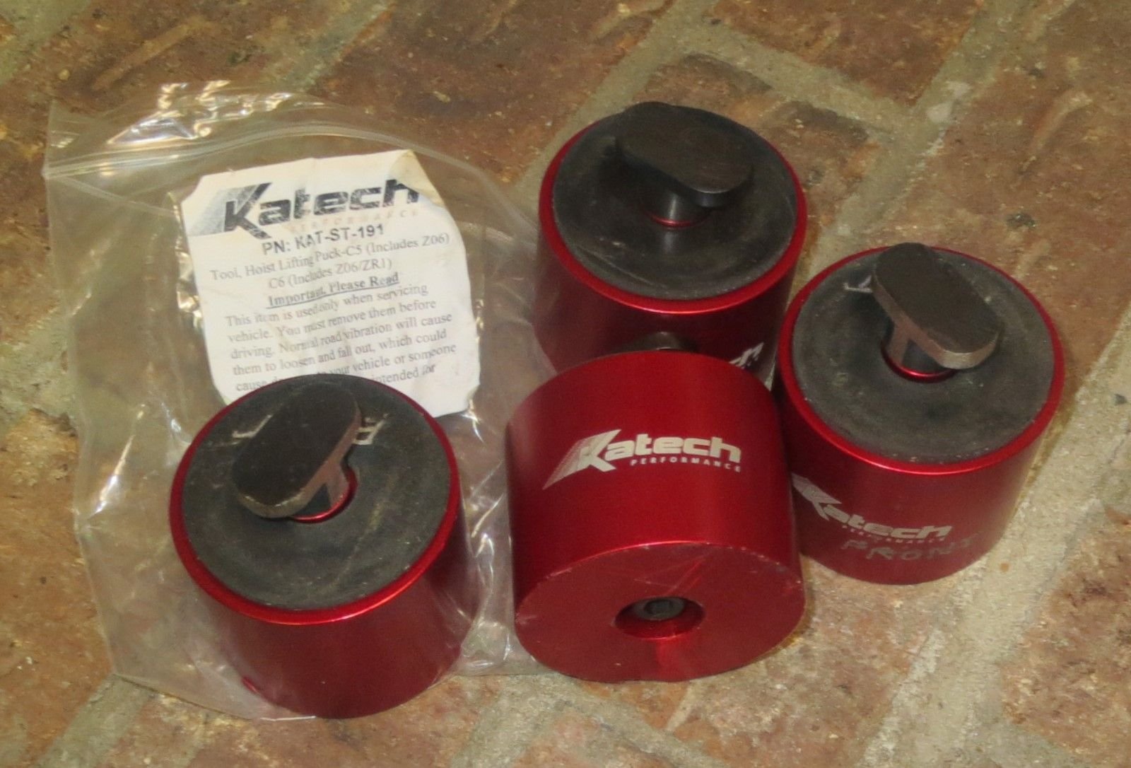

I've seen both aluminum and hard rubber jacking pucks. What do you guys that have used them recommend and where is the best place to purchase?
Old Feb 16, 2020 | 08:10 AM
JerryU's Avatar
JerryU
E-Ray, 3LZ, ZER, LIFT
Joined: Sep 2007
Posts: 34,992
Likes: 12,385
From: NE South Carolina
I have both. Bought 2 inch high aluminum jack pads before my September 2013 built 2014 C7 arrived. Then after GM sent a notice to have my differential fluid level checked was concerned so when I bought my Grand Sport, bought plastic one from Reverse Logic (forum vendor.) His is why:
As I had with my C6, told the dealer service writer my usual, "I have my 4 lift pads on the passenger seat in a clear plastic bag, be sure the Tech uses them!" She knew me from the C6 and said, "Oh I am going to be sure they use only the drive on alignment rack (they have one of those and ~18 center post lifts that "NEED" lift pads,) They just cracked a customer's Corvette rocker panel and it's in the body shop for repair!" BTW, replacing the large one piece rocker panel that is glued to the frame requires removing the door then blending the paint with the front and rear fender- SEE pic!
These Reverse Logic pads can be attached temporarily when visiting a dealer or tire shop where you cannot watch from an open service bay door (my usual MO) and be sure they are used. I mostly just use them as normal pads as I do all my own oil changes etc. You can also buy a kit to make them higher BUT not needed even with the full length carbon Fiber side skirts I have on my 2017 Grand Sport.
