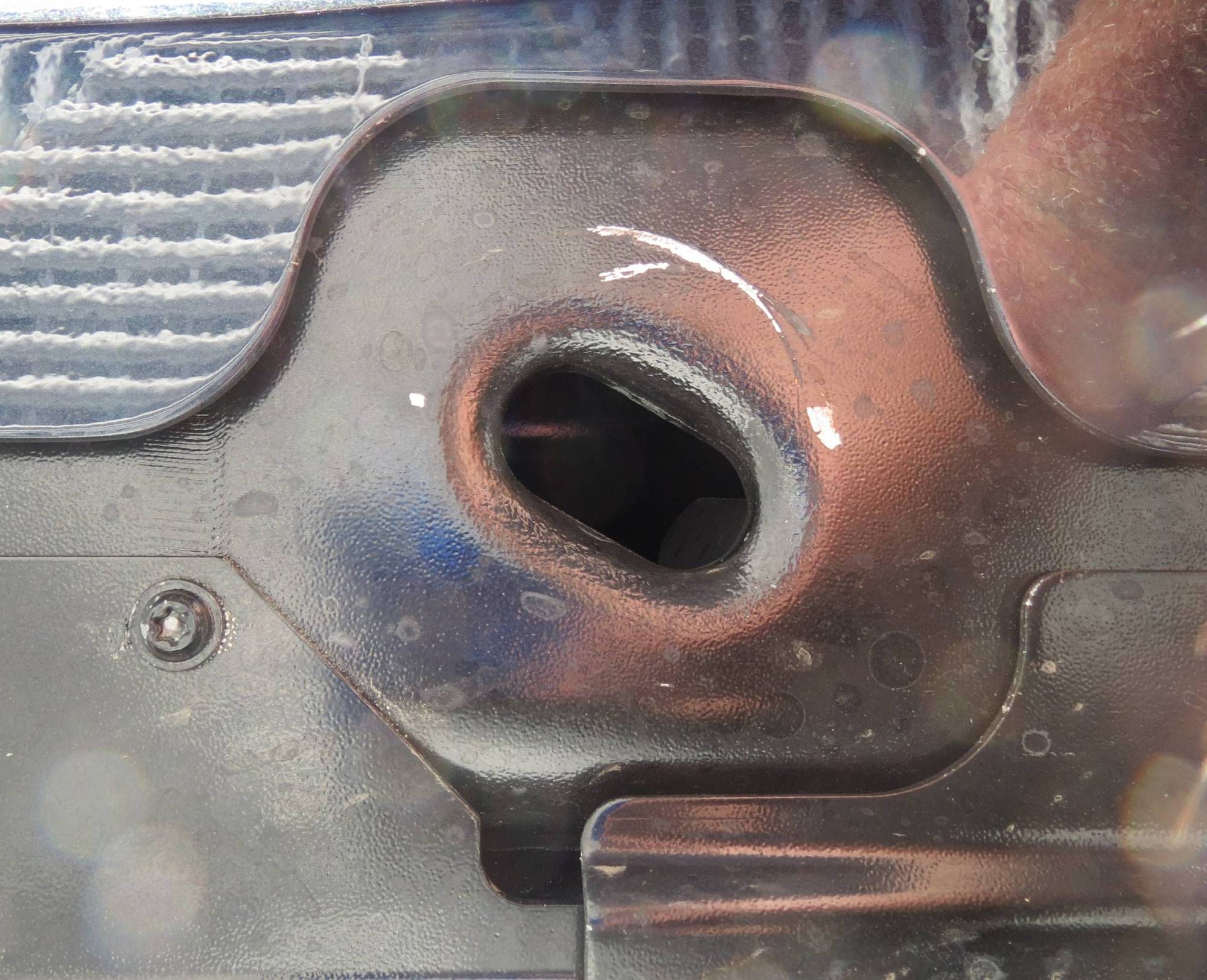

Originally Posted by NoSoupForU
Where is the pic of the underside of the car showing the C8 jacking points?
Hard to see but I circled.

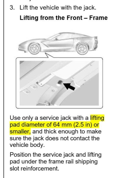

Originally Posted by hochocke
I have a set of aluminum jacking pucks that I used for my C-6 Corvette. Will these work with a C-8?
Hope one of my 3 sets of pads work! The slots are probably the same size as the car carries use them to hold down the car! However found my correct size per the C7 Owner's Manual, 2 1/2 inch diameter Katech aluminum pads were too tight in one slot of my Grand Sport. A grinder took care of that!
Note, had 3 inch diameter aluminum pads for my C6 but in one frame slot it hit my 2014 C7 composite panel, probably why the C7 Owner's Manual says use max 2 1/2 inch pads. Hockey pucks can work as the eye hooks most use have a thin shaft that can be pushed to one side of the frame slot!

Most of my 2014 C7 slots cleared the composite rocker with my 3 inch diameter pads BUT one did not. Bought the recommended 2 1/2 inch diameter pads.
Even if you have a lift or "Quick Jack," etc need pads as most dealer techs don't use them and tire shops don't have them. You risk having your composite rocker panels cracked! First time I brought my C7 to the dealer to have the dif oil level checked per a GM notice, mentioned to the service writer who I knew well from my C6, to be sure the tech used the 4 lifting pads I had in a clear plastic bag on the passenger seat- my usual MO with my c6. She said, "Don't worry I will insist they use our alignment drive on rack as we just cracked a Corvette rocker panel and it's in the body shop being repaired! They have one alignment rack and ~18 center post lifts with arms. Most tire shops use center post lifts as they want the tires unsupported so they can get to all 4 wheels!

Originally Posted by AverageVetteNut
I was under a C8 this weekend at daytona and can confirm also that there are tie down holes in the bottom of the car that look to be the same ( or close ) in size for the T-hooks to work to tie the car down on a car trailer and for the pucks to work as well.
NOW... the bigger question is ... can you jack the car up on its sides or do they advise against it like the other aluminum - framed C7s and the C6Z/ZR1?
This info is from the C7 Service Manual, sure you can lift from the frame. Only caution is lifting from the hollow cast aluminum cross members, which was NOT recommended in my 2014 Service Manual BUT as noted was added as allowed in the 2016 Service manual IF you use a rubber pad or wood block.

THat's what I thought. Thanks Jerry for the sketch.
