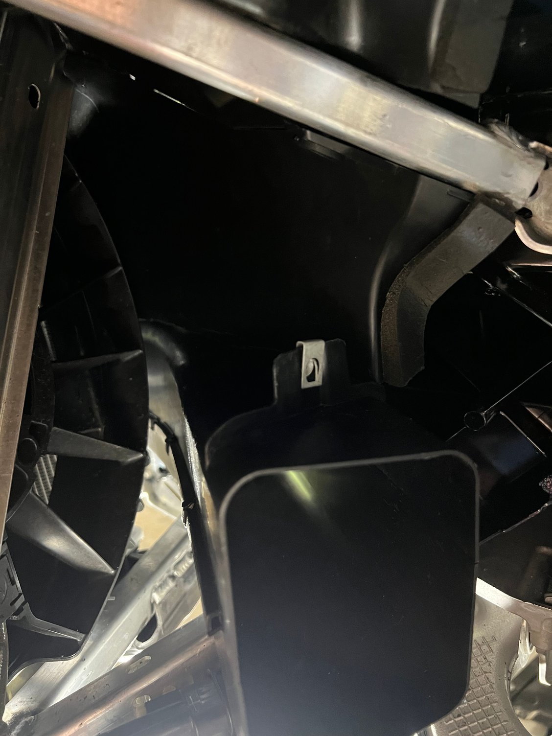

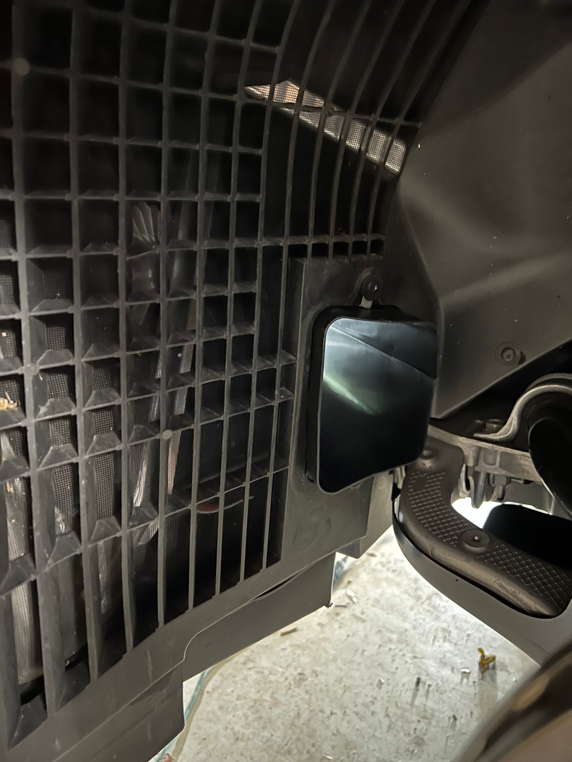

I think for 90% of people Girodiscs Rotors, high temp pads and a good brake fluid will be fine.
I added the cooling ducts myself on my base car.
I’m not sure how do didn’t have cooling issues but perhaps track choice can play a bigger role than I thought.
I overheated my transmission at road Atlanta twice in one day.
