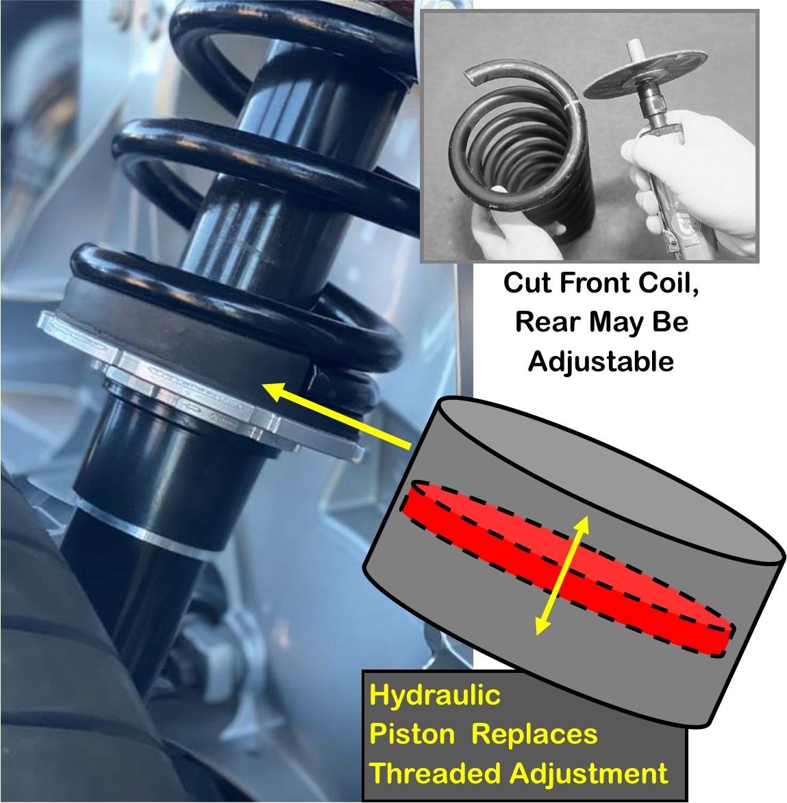

It's not cost! There is only so much room on the front coilover! A large hydraulic piston coil spring seat replaces the threaded adjustable section of the front coilover.
Now you can shorten the front coil the "old fashion way" by cutting (expect in time the aftermarket may have short spring options.) Perhaps the rear coilovers do have the threaded adjustment. If not replace with ones that don't have the "lift option." Lets see if you lower the car 1 inch you'll still have about a 1 inch lift.
