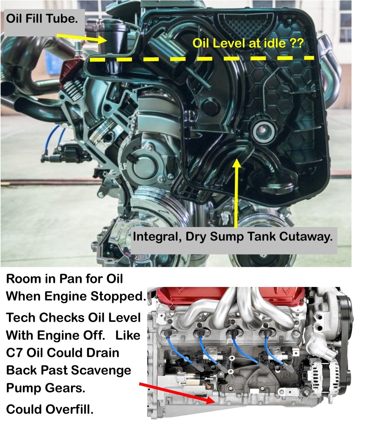

Hmm, perhaps NOT! Think as I would anytime a Tech changed oil in my C7 dry sump- would check the level after!
In the case of the C7, lots of oil will drain back to the pan from the dry sump tank. For fun, checked the level after the car sat over a day before starting the engine! Oil was below the dip stick tip! Looking at the length of the hatched area (which is one quart) it was about 5+ quarts under minimum!
In a C8 a Tech checking with the engine off of a length of time would also find low oil. If they added oil it would be overfilled! The Owner's Manual clearly says DON'T OVERFILL!

Small/tiny pan - it’s all in the tank, hence “dry” sump. But yes sir, this will confuse the untrained oil jockey.

Yep, wonder how many will overfill because they checked the level with the engine off and got a low reading? Don't know what the "correct" oil level is in the tank with the engine running but assume it will be lower when the engine stops and some drains back to the pan as it does in a C7 dry sump!
