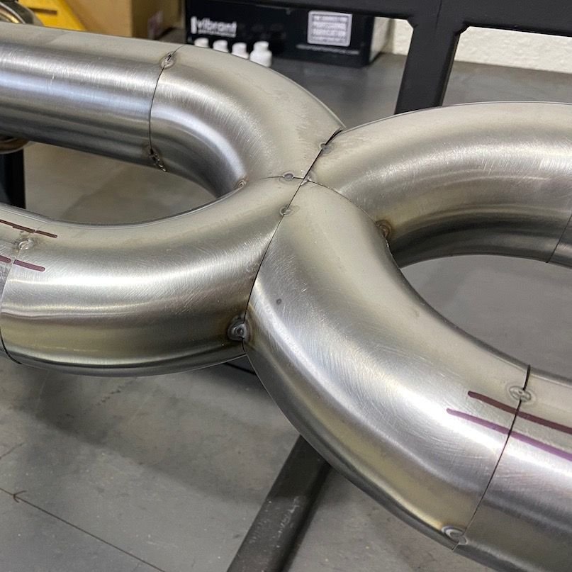

The answer is most haven’t truly addressed the heat issue and you’re going to see issues/revisions on these eventually if I had to guess. Most C8 owners also have NPP on their cars already (either with Z51 or separately like I have) and would like to retain the adjustability of the factory valves and most are simply coming out with straight pipe/not really x-pipe catbacks (hell saw one today with some fake *** welds too - wtf?) because it was the easiest to get to market quickly. Would you spend up for Mag Ride only to rip them out and replace with coilovers after taking delivery of your car?
With all that, I’m working with a custom exhaust company out of Houston that’s going to address all these and deliver a kick *** exhaust, utilizing the factory NPP system, at a price comparable to the straight pipe exhausts available now. Give me a couple weeks and I’ll share more details/etc. A little teaser pic below of what a TRUE custom x-pipe is going to look like for the C8.
