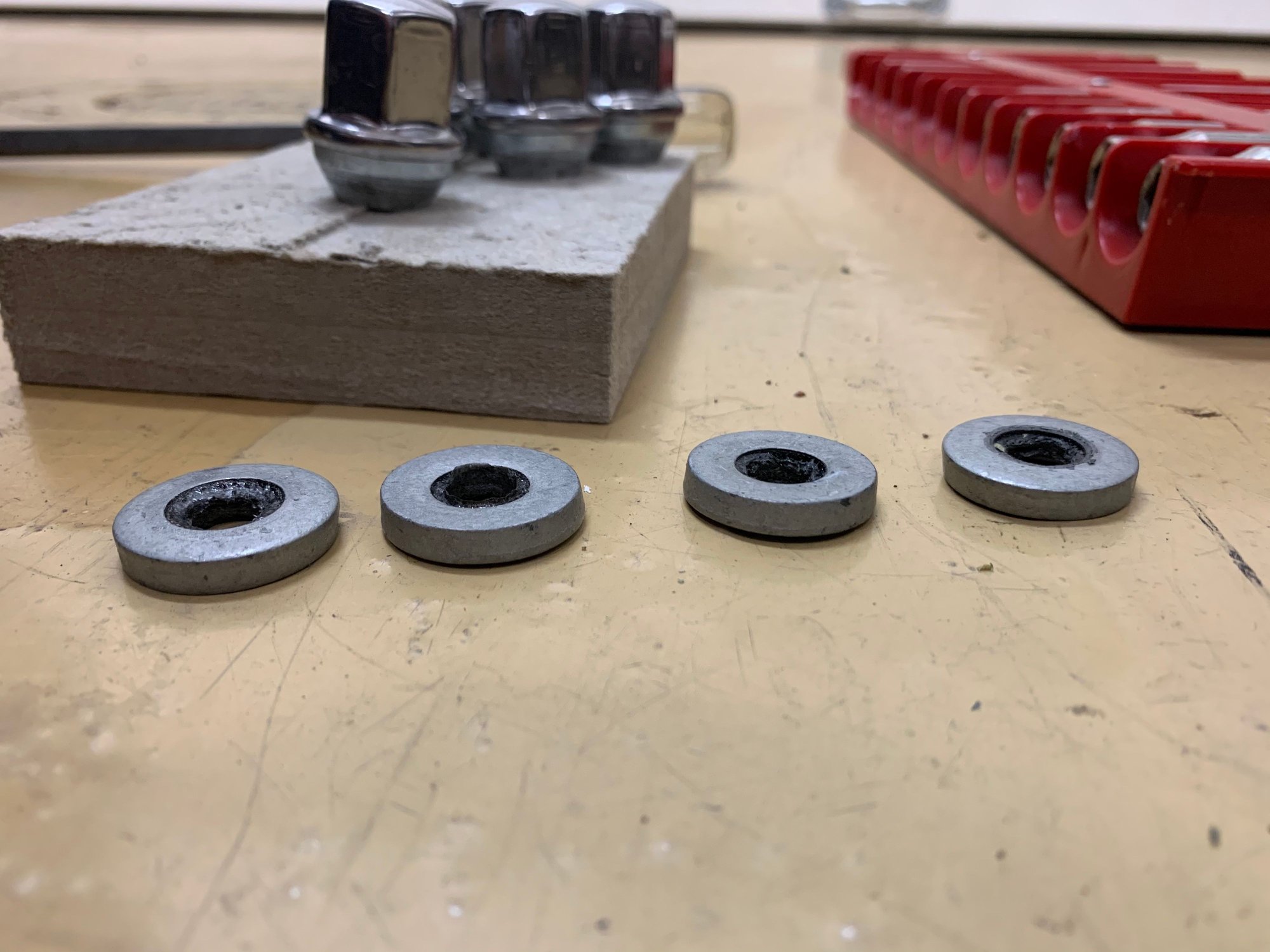

First one - cars with the front lift kit do also have the UCA shims allowing for more camber. I'd read in at least one place that they don't have this adjustment. In fact they do, one shim per UCA bolt.
They are about 5mm thick (my digital caliper's batteries are dead, eyeballed it). They have some kind of interesting material in their interior, I wonder if it's perhaps to prevent galvanic corrosion.
Also, the OEM lug nuts are 22mm, a weird size.
More to come!

Next bit - pulling the front UCA shims introduces 3/4” toe out on the front wheels. For those not familiar, that is a ton and will wear out tires in a big hurry, especially when combined with some camber.
To get it back to zero required just over 1-2/3 turn (or 10 “flats” if you measure it that way) on each front tire rod) of toe-in adjustment.
