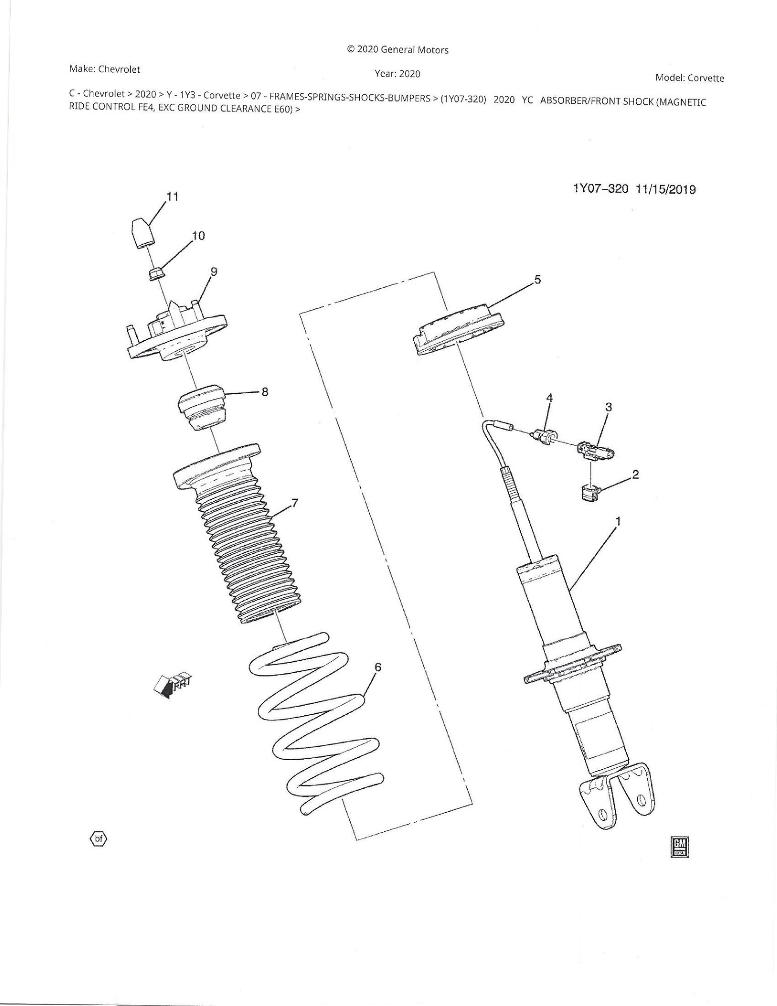

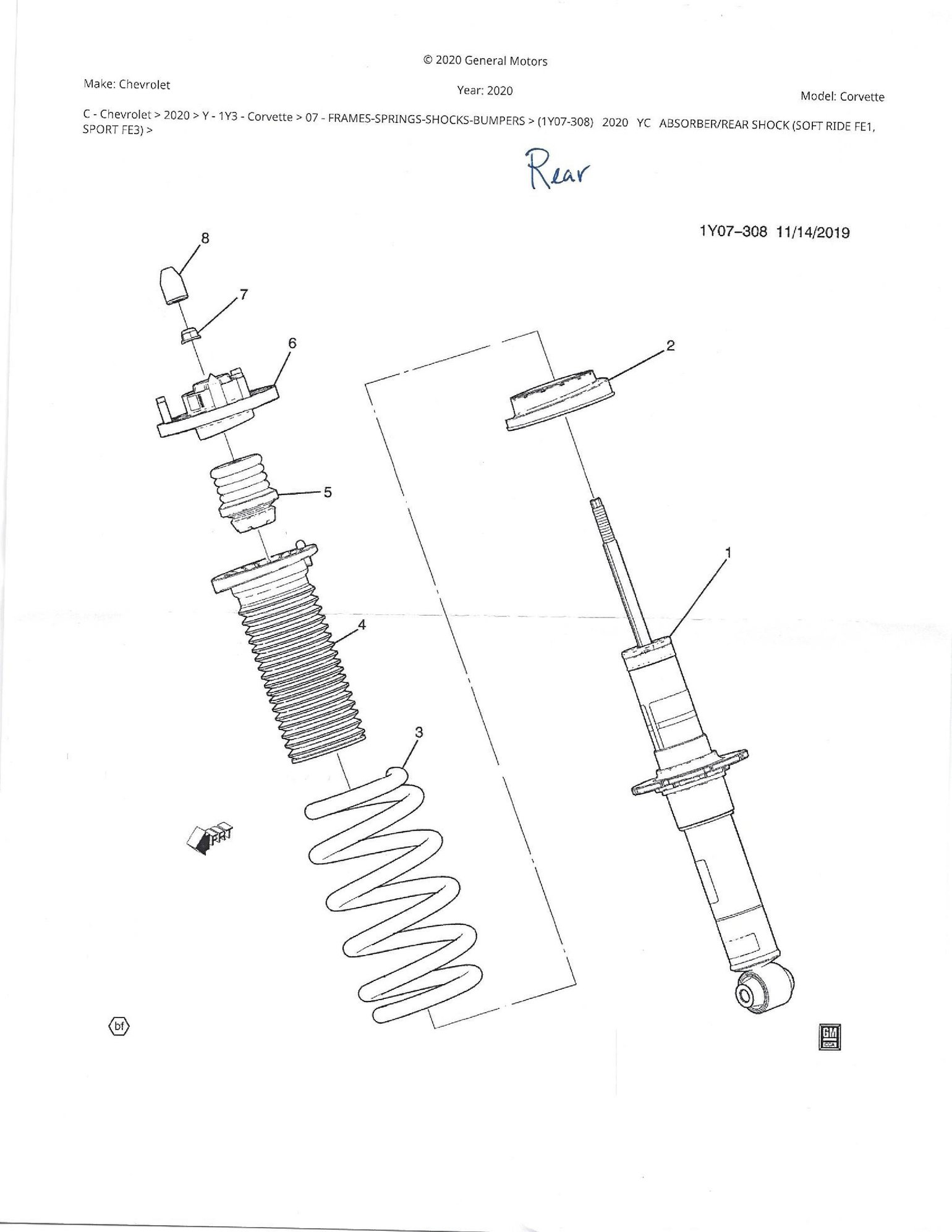

I did go to my local dealer and their parts guys to see about purchasing the FE3 Shocks so I could have adjustable shocks on my C8 once it arrives, They gave me a price nd parts numbers, but I think they are not the correct shocks..... Front part# 84726286 & the rear part # 84905755..... Total price would be $961.42, but again, I don't think they are correct because he printed me out the pictures aka drawings of the shock, and they look like the non adjustable. I'm afraid there is going to be a learning curve on parts for the new C8 for several months.

I agree, the rear drawing looks correct, but the front looks like the standard shock.... I won't get my panties in a bunch until I actually have the car in my possession or when I can talk to an actual coil-over manufacturer that I could then buy the style shock I need

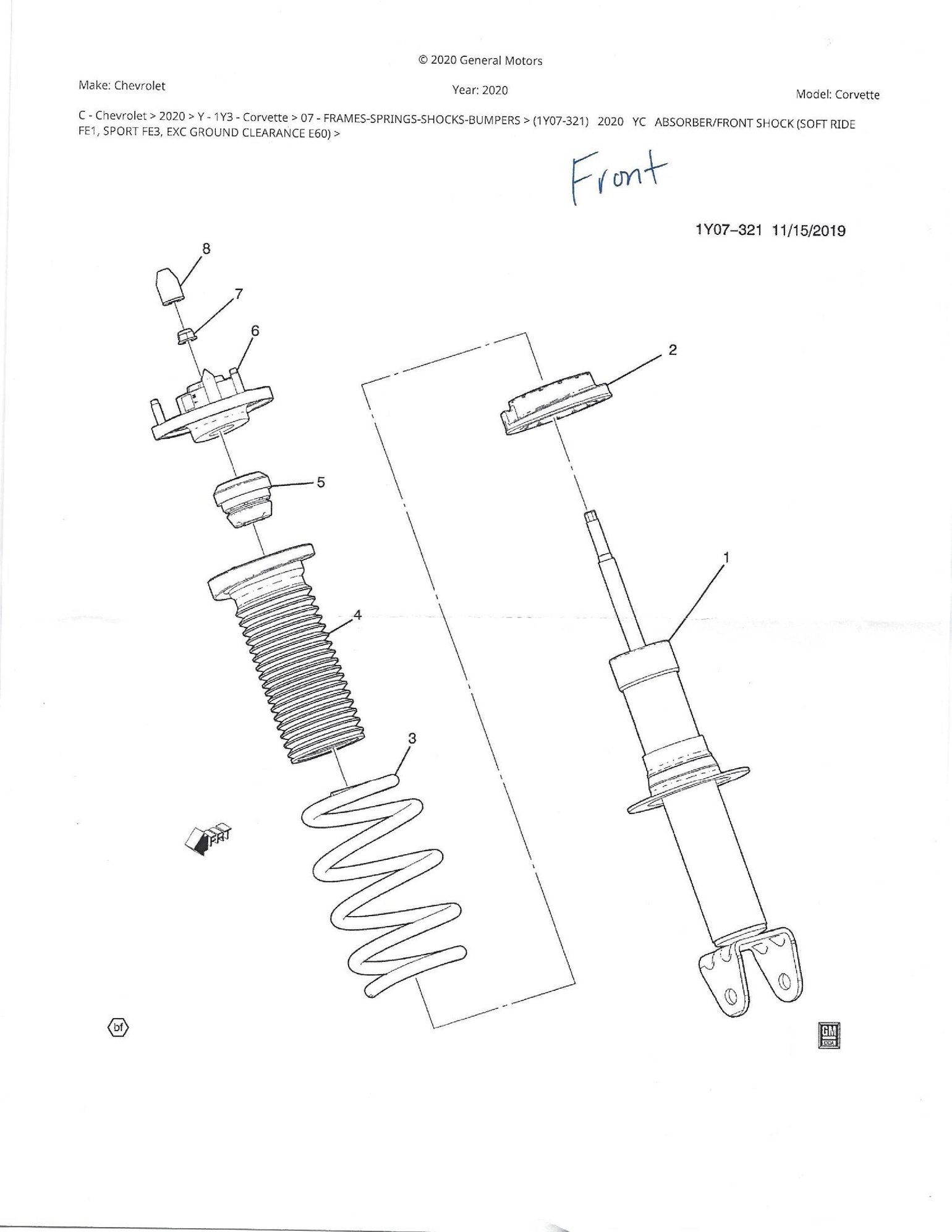

OK... So I know I'm not the only person who screwed up and ordered his C8 without the FE3 shocks in the Z51 package aka non mag ride. I'm still trying to figure out if there is a way to buy just the FE3 shocks from the dealer....... I've posted the specs that the parts guy found for the rear non mag ride FE3 shocks in an ealier part of this thread, but I'm still not sure he has the correct number for the front shocks, today, I got the specs for the FE4 front shocks, that are from the Z51 equipped cars without the lift option, but they still are setup for mag ride....(see the diagrams below) does anybody know if you can run this shock and have it act normally without the electronics hooked up to it, or does it have to have the hookup connected for the shock to act like a shock? I don't need the tuning capibility of the mag ride per say, I just want the shock to be a shock that I can lower the front of the car with.

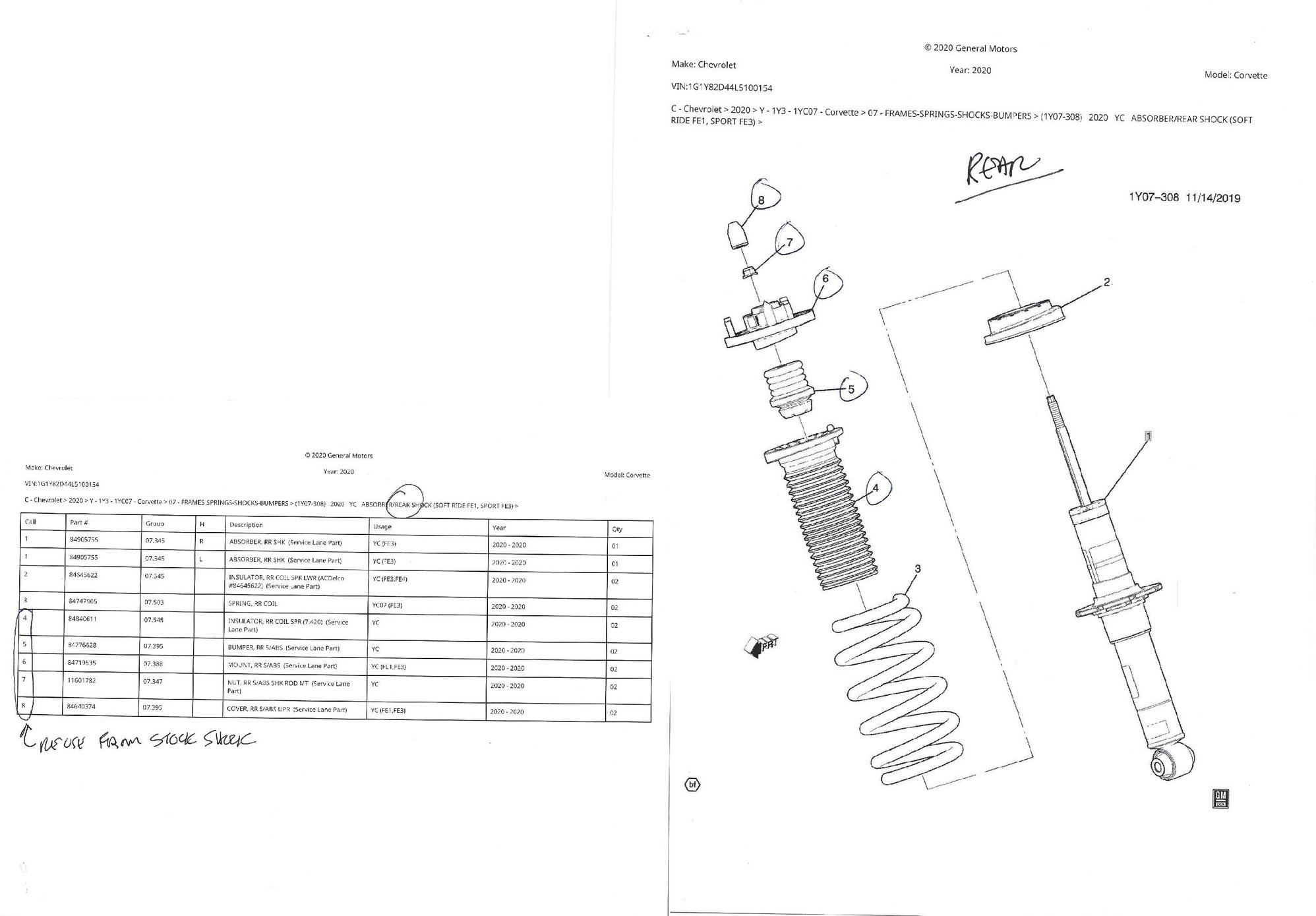

Well.... Finally got the answers I needed.... Since I'm more interested in just lowering the car 3/4" to 1", I was able to finally confirm that the shocks from GM for the FE3 setup w/o magride and for a C8 w/o the front lift will interchange with the stock FE1 shocks, I can buy the GM parts I need, and with a few handtools and shock wrenches I already own, transform my FE1 shocks into FE3 shocks, achieve my drop I want and not have to spend a bunch of bucks as of right now for aftermarket coilover shocks.
