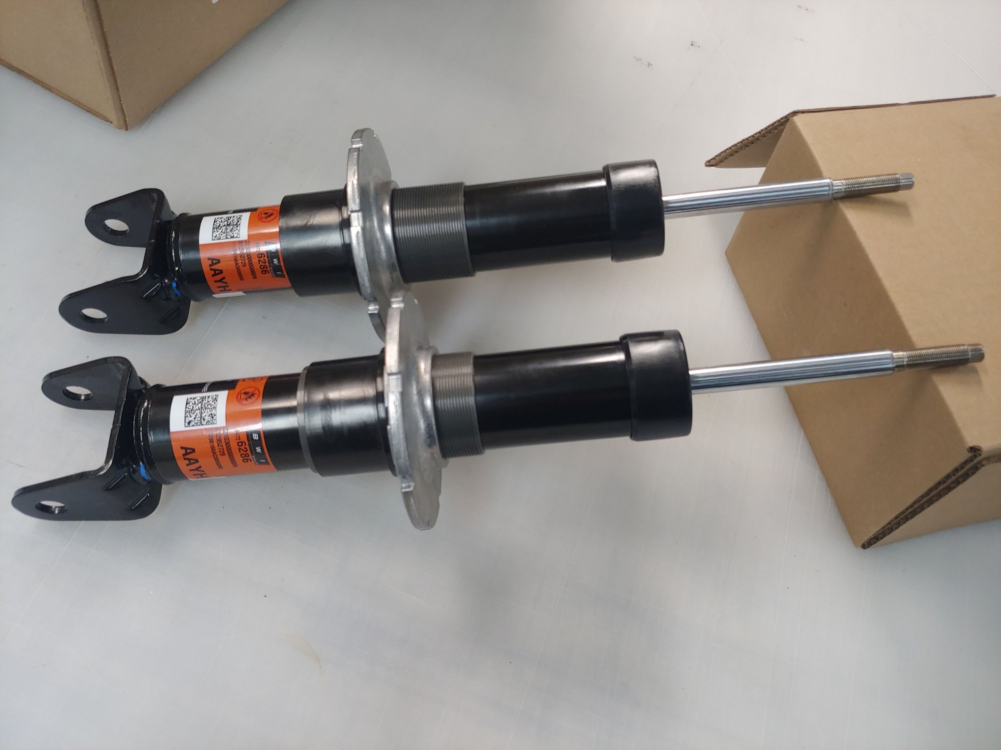

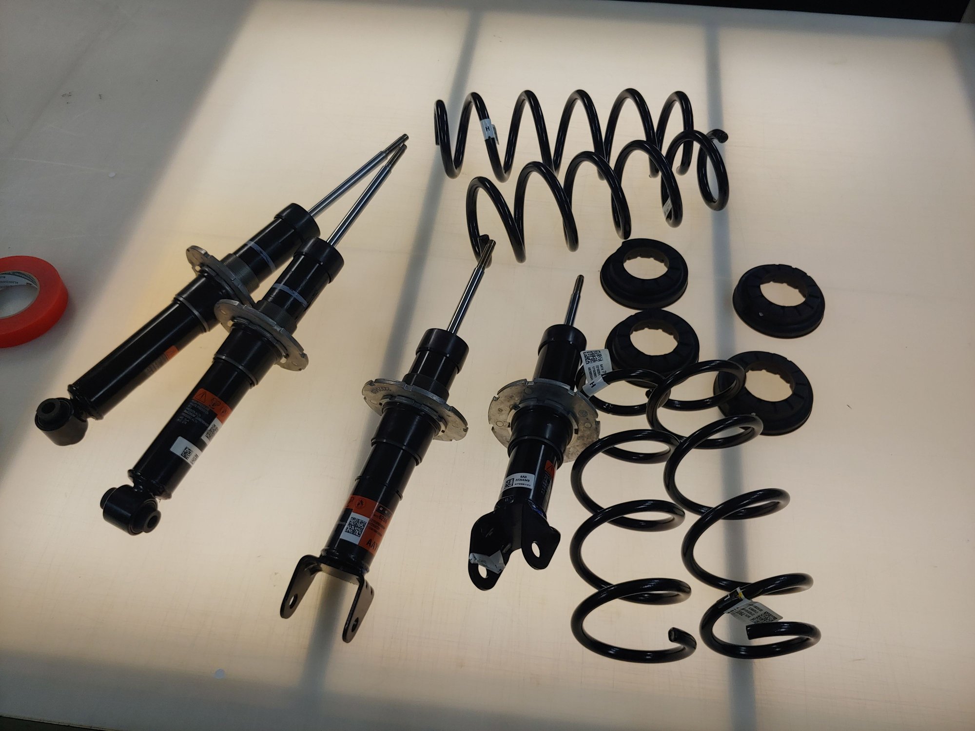

Front FE3 shock body, fully height adjustable
Rear FE3 shock body, fully adjustable
everything you need to convert the stock FE1 shocks to adjustable FE3 shocks on your C8
Aaron is an example of a GM dealership parts guy who is also a Car Guy. Thank You.
I am so happy to prove to allot of nay-sayers on this forum that you can buy stock FE3 shock setup... you just have to have some basic mechanical skills and tools and you can convert the stock FE1 shocks to FE3 shocks, so for less that $900.00, I'll be able to lower my car and have a factory style, GM warranty suspension! And my "Rona" C8 is due here next week, so I'll post a seperate "How-TO" with plenty of pics!!

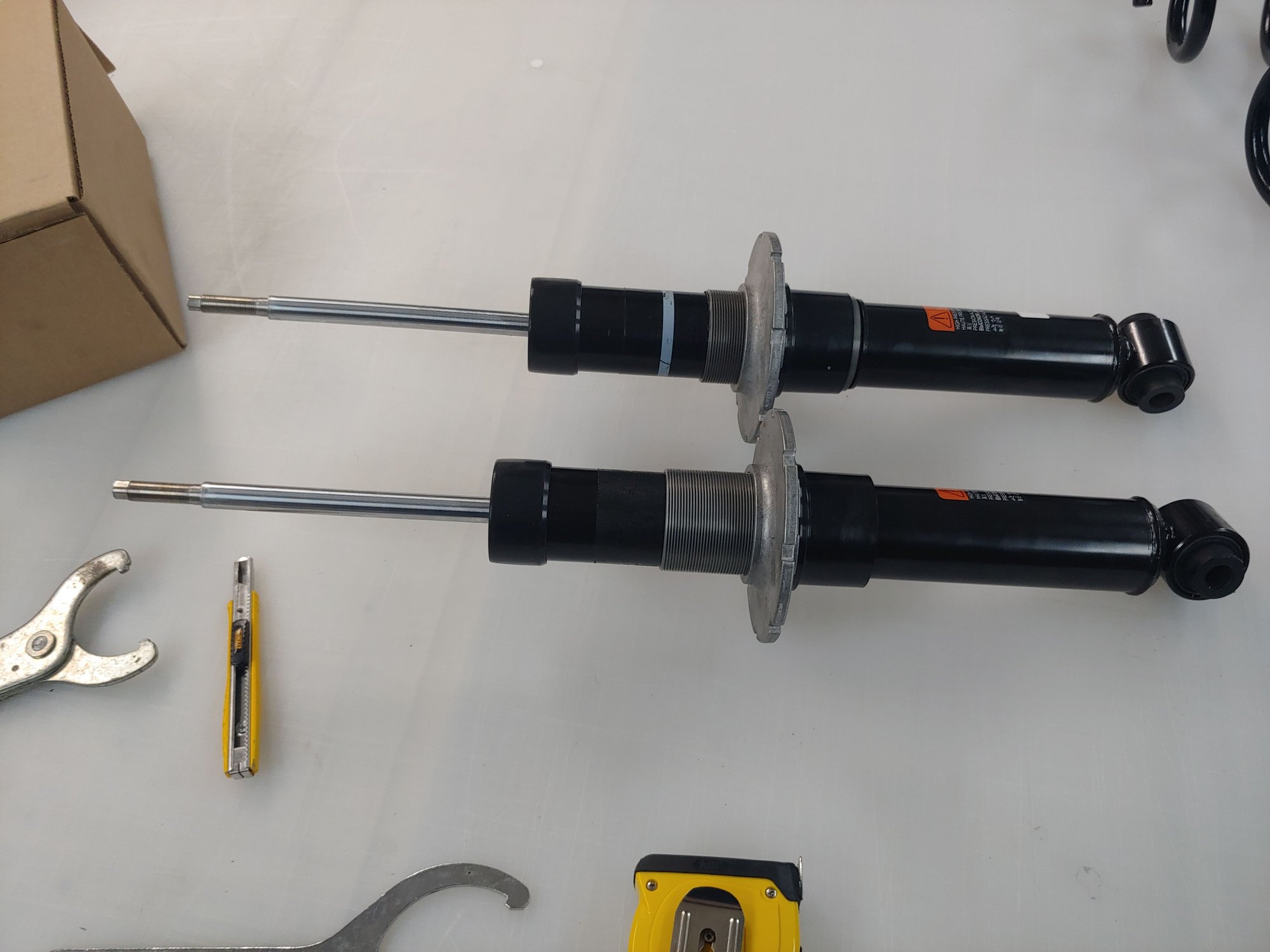

I messed with the adjustment collars on the front and rear shock bodies and I felt like if I left 4 or 5 turns on the threads like I use to do on my QA1 shocks, there was enough bite to be safe under most driving conditions, and with that setup, it seems to me you can gain at least 1+" of drop in the front and the rear.
Fronts
rears
shock adjustment wrenches I bought from Summitt back 6 years ago, fit like money!

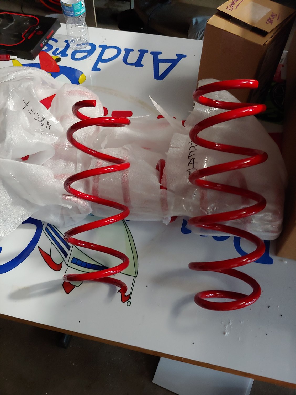

Got my springs back from the powder coater and next week we will establish our baseline on all 4 corners and then we will swap out the FE1 shocks for the FE3 shocks, lower the car, reset weight at all four corners and re-align the car... photos and videos to follow!
just remove the three trim pieces in the "frunk", and easy access to the front shocks... and what do you know, a battery too
Got the new FE3 spring powdercoated to match the calipers.... most likely nobody will ever see them, but I know they are there.

Work and life have intervened, but we will set our 4 corner weights today at stock ride height with the new wheels and tires, then we will do the shock conversion in the next day or so, then redo the 4 corner weights to bring back to close to where it started, but just at the lowered stance. I'll make sure to make pics and video. I found a local wheel alignment shop with a in-ground alignment machine... that will help since we will be too low to go on the above ground machines that are standard in most tire shops.

So you got the FE3 coils as well as the FE3 shock bodies. In another forum a guy just got the FE3 shock bodies and is reusing his FE1 coils on them. He's gonna report back on what kind of difference it makes and if its not right he says he'll get the FE3 coils or wait for aftermarket lowering coils.

I got both... i wanted the correct setup for FE3 shocks.
