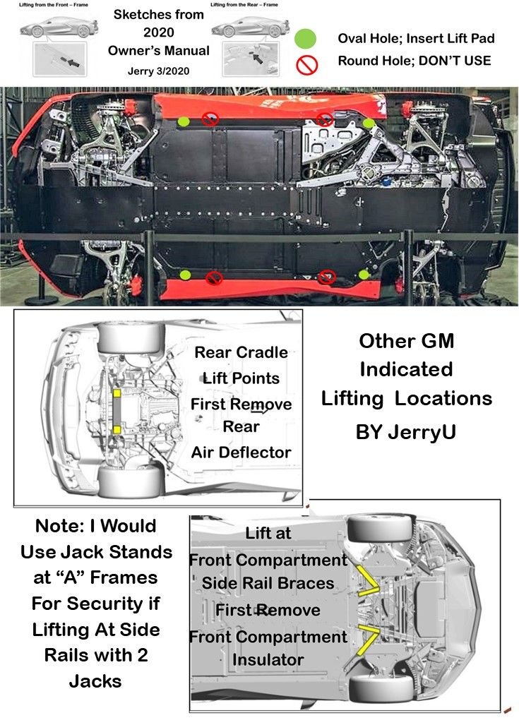

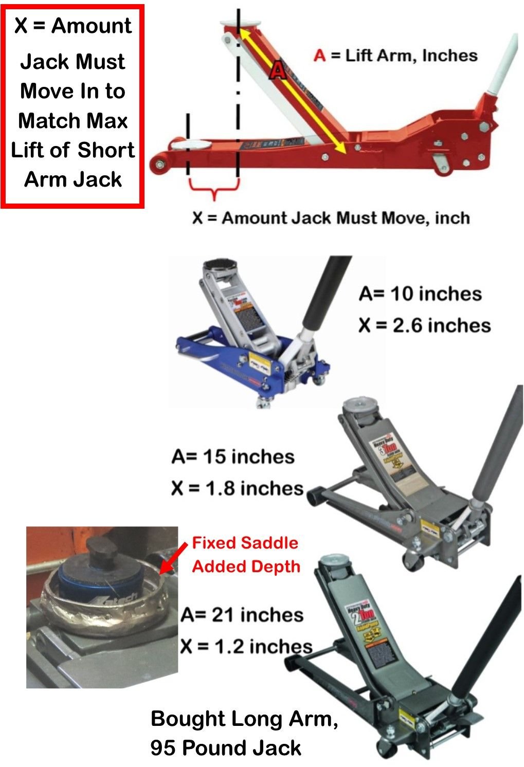

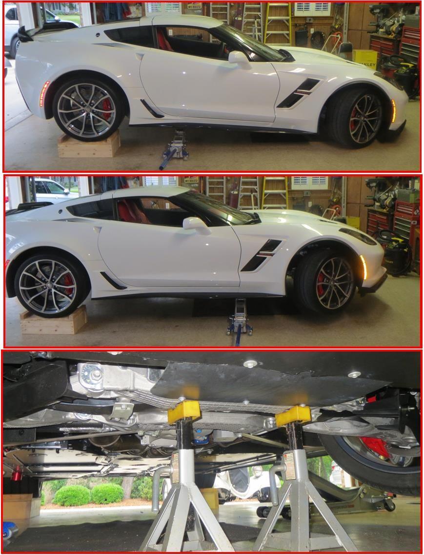

I think Harbor Freight jacks are fine. I have 4! My first is large and bought it when I built my street rod ~20 years ago. Have the other 3 because one has too short a Lift Arm. Regardless of which brand you buy don't buy one with a short arm because it has to move into the car quite a bit or the saddle will slip off the jack pad!
These pics will help explain.
Note: found the issue with my long reach jack was it weighted 95lbs and wasn't also not moving in! I welded a steel band onto the very flat saddle!
Frankly I'd buy two jacks with ~15 inch Lift Arms.
I always use jack stands. With the C8 where the cross members are not accessible because they are covered by bottom aero panels I'd keep the jack under tension and put a jack stand under the suspension "A" arm.
I use stanchions on one end if I need to have the car level, like when changing oil (not needed on the C8 as only one drain plug on the front.) I made these wood ones for ~$10 and they are light. Have fiberglass ones that are 12 inches high I used when building my street rod. But have to use a two step jack approach to get the car that high. Was fine when spending several months under my street rod BUT not for working on the Vette! I'd never use jack stands on both ends of the car.

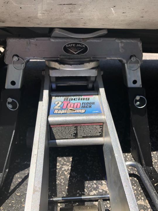

I've been told by other mid engine car owners that this floor jack with the safe jack device works well
