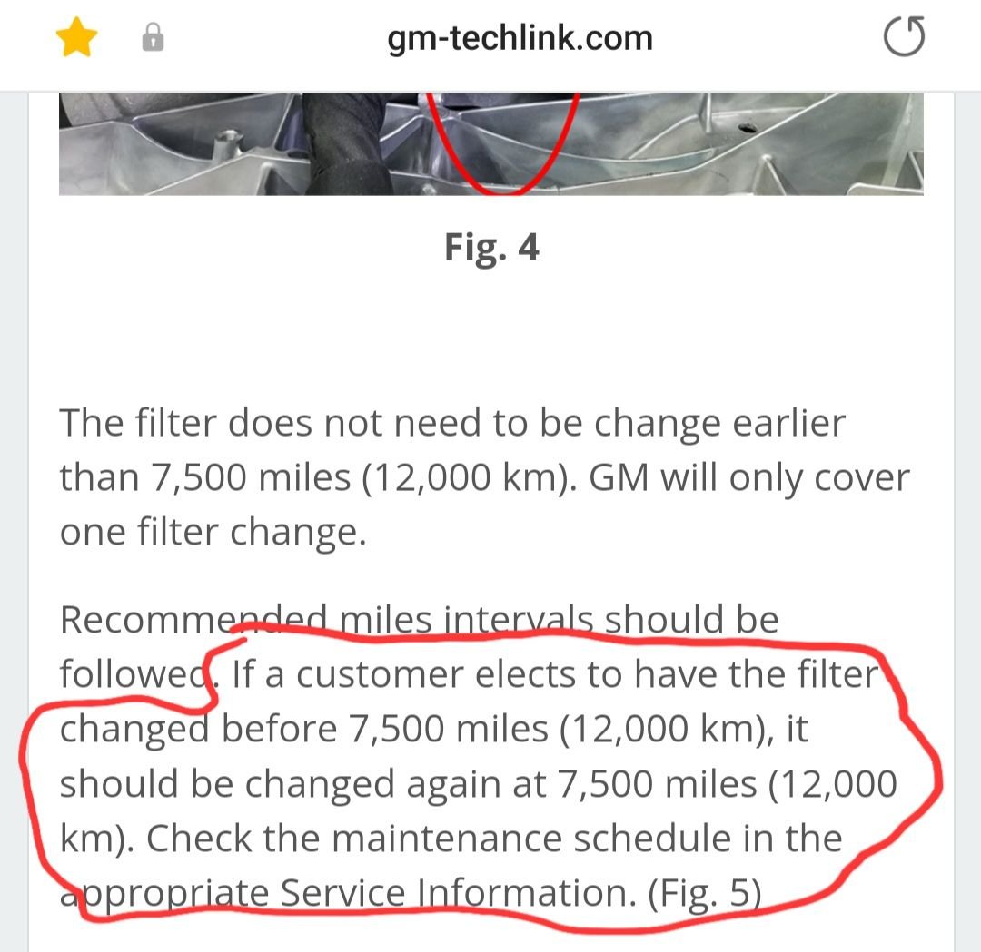

Originally Posted by JerryU
There will be many more Threads on the subject as there have been unless GM adds a statement about how to deal with early DCT filter changes. My "Guess IF" they ever do it will say, "Like making early engine oil changes were you are instructed to reset the OLM, for early DCT filter changes add the mileage where the DCT filter was changed to 7500 for the next DCT change, them follow...."
Doubt they will, they like to chuckle as some of us post suggestions!
Here ya go. Hopefully this helps.

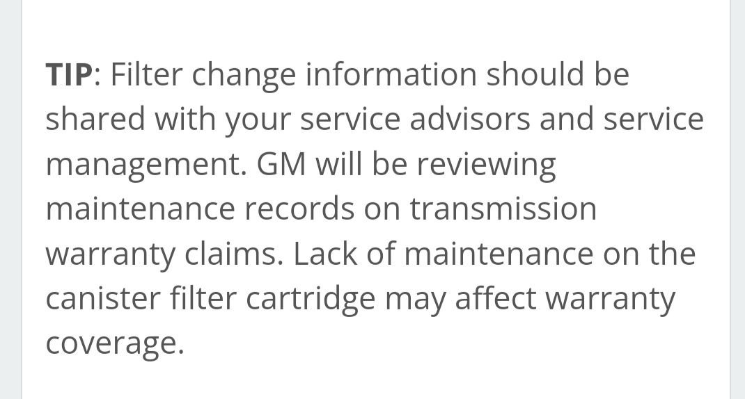

This link may be helpful to everyone RE: DCT filter, Oil & Oil filter change. I did the first one myself have an appointment next month to have the Oil & DCT filter done. I called to be sure they had the DCT filter in stock. The tech said they did but only one and it takes about 1 - 1 1/2 weeks to get one in. Wanted to make sure they have one for me. I'll be calling a week out before my appointment to be sure there's one their along with the 0w-40 ESP. Here's the link from GM Tech Line. Hope it helps.
https://gm-techlink.com/?p=15781

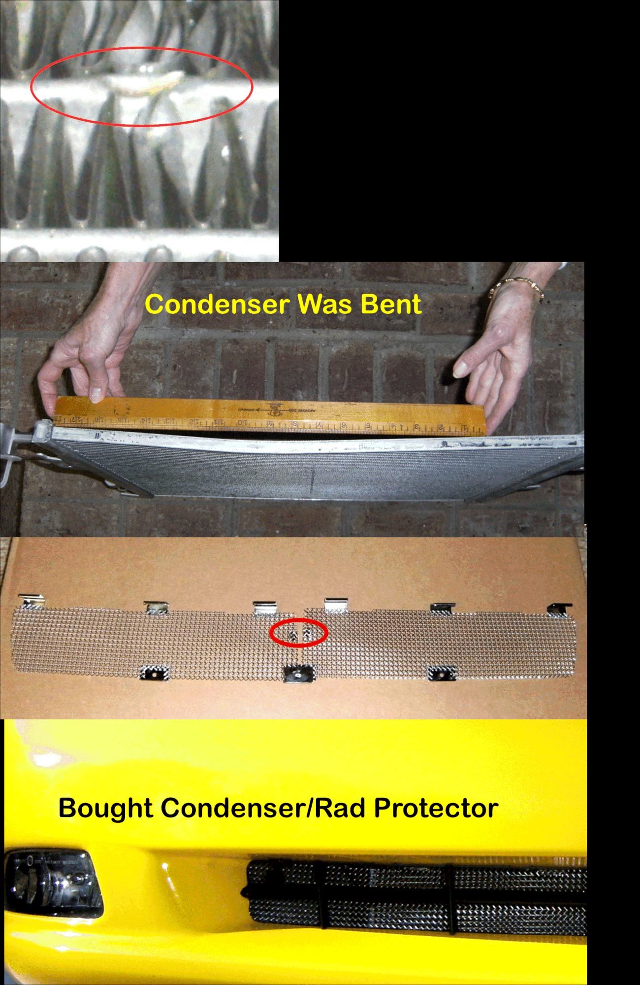

  • Last was my 6 month old C6 where dealer service manger said GM won't cover hole in AC Condenser, just like a paint chip, was "probably cause by rock." Had new one installed. However he helped by showing pics and short report I make after examining the defect in AC Condenser. The AC Condenser was bent right where there was a defect that leaked. Suggested it was "probably dropped" prior to being installed, which weakened the heat exchanger tube wall and it finally failed. Suggested it may have been done at the manufacturer not at BG as was somewhat difficult to see! Dealer Service Manger showed my short report with pics to his GM Service Rep and got the $800 paid for new one reimbursed IN FULL.
Was told GM would not cover hole in AC Condenser as, like a paint chip, "probably" caused by a rock. I showed with pics it was "probably" caused when Condenser was dropped before being installed! My "probably" trumped theirs and got the $800 I paid for new one reimbursed. Note added an AC Condenser "protector" for the new one- just in case, For C8 did not wait for a rock, added before!

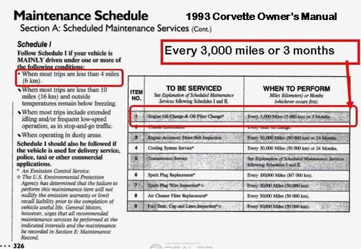

You only should change engine oil and filter WHEN THE OLM STATES. That will display on the dash at ~10% Oil Life Left and say change due. That will display EVERY TIME you start the car and count down with life left. YOU MUST press OK to have the message go away! Can't miss it.
The OLM considers many things NOT just miles (heck we're not back to the 1960's when only the Odometer and time were what we had as measurement indicators.) GM confounded the engine oil change words with the required DCT filter change at 7500 miles for some foolish reason. My C7's and C6 just said change when the OLM says! That IS what the C8 Owner's Manual states as well!
Now if for whatever reason you want to change earlier do it and reset the OLM. The OLM does include a measure that actually considers oil temp after cold starts. My last Vette, before the OLM, was a '93. Since all we had was an Odometer and Time it stated as I posted below -Change at 3000 miles OR 3 MONTHS WHICHEVER OCCURS 1ST. So IF you have a garage queen that most drives are 2 to 4 miles going to the Country Club on weekends it will reduce that min 12 months to less!
PERHAPS WHY skevette WITH 1020 MILES FEELS LIKE IT'S TIME FOR THE 1ST CHANGE!
PIC from 1993 Vette Owner's manual BEFORE the OLM.
