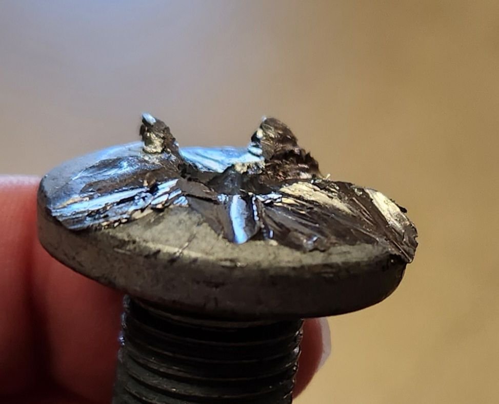

Man I feel you. The exact same thing happened to me when I tried to remove mine to replace it with a Paragon carbon fiber wheel in August of last year. I ended up taking it to my mechanic and they used every compressed air chisel and tool they could to remove it. Two guys and a half hour later and it was off, so it cost me a full hour of labor or $135 or so. They couldn’t believe how tight the thing was on and it was tough to remove down to the very last thread. I bought a new one online before having them remove it. Check out what it looked like a next to the new one once they got it off. Sadly someone on the line is a little overzealous with the thread locker and torque spec. Paragon assured me this is rare but I’ve heard from enough people with similar experience to know that it does happen. Fortunately the new wheel is really awesome so I feel it was worth it.
