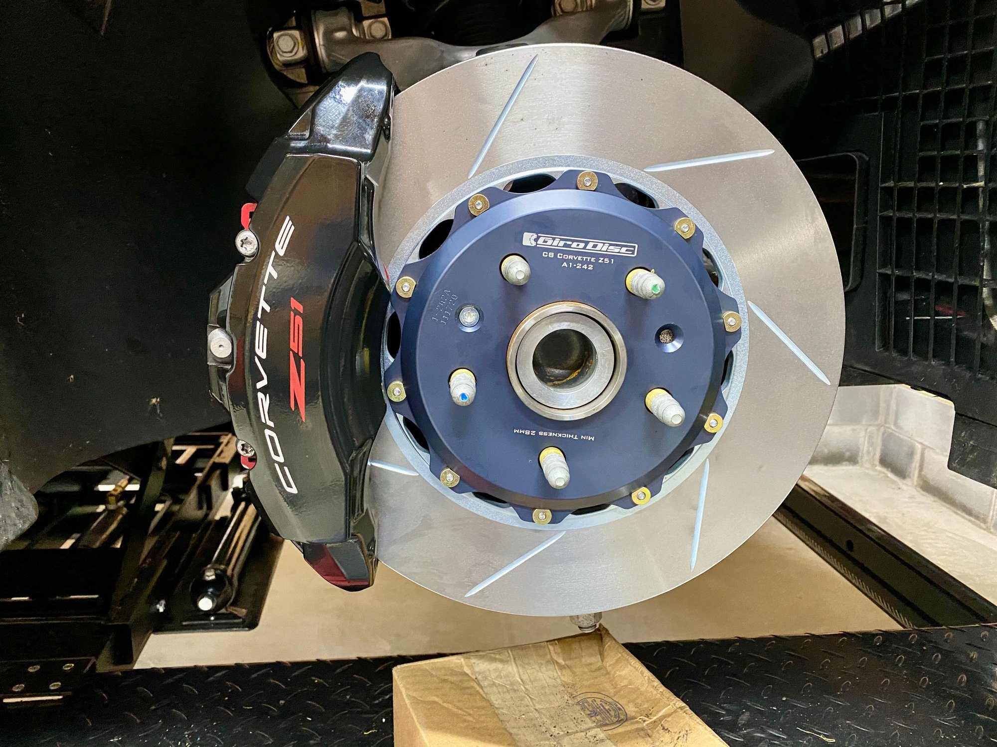

Front caliper bolts torque setting is 155 ft lbs
Did mine last month

Very helpful info here thanks for sharing it. I just replaced my rotors at home and was wondering how the hell to torque those rear bolts to 155 without a lift. I'm not too worried about 70s torque by hand but correct me if I'm wrong!

Yep. Might hand tighten then go to person with lift and proper torque wrench and have then tighten. Like the C8 wheel lugs. “Hand tight “ may have worked for prior Vettes but 140 ft-lbs is much more!
In my How To PDF Big Lebowski shows how he achieved 155 ft-lbs without a lift using jack and jack stands! There are torque wrench with pivoting head BUT he got by without: netwelding.com/Ceramic_Pads.pdf
