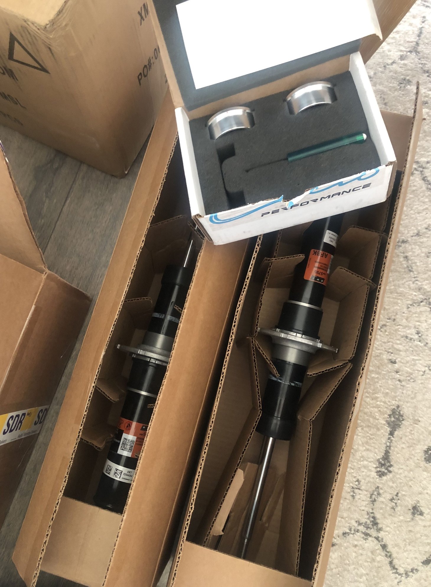

I have the parts for it (Cicio front collars - mine has front lift) and FE3 shocks for the rear. Car is going to my mechanic next Tuesday for install. Total cost is around $500 for parts and $500-600 for installation. I think I will be the first to try this. We will see how the car rides/handles then make any necessary adjustments from there.

Are you worried that the spring rates between the FE1 front shocks and the FE3 rears will be mismatched?

Can you share the part numbers and where to buy the coilovers?
Thanks
