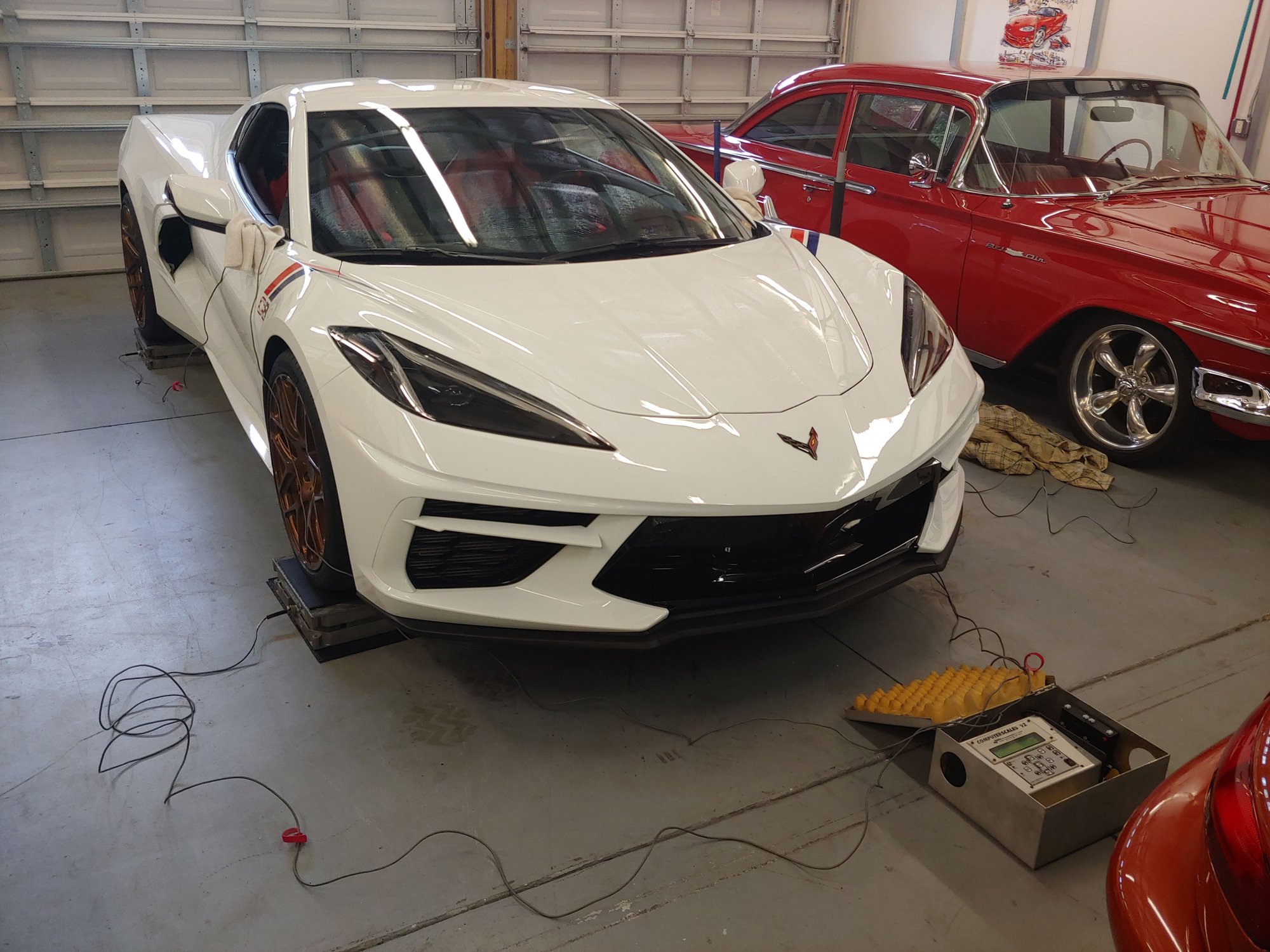

we got the 4 corner weights and ride height all balanced out, the car dropped another 12lbs and the ride height dropped an additional 8mm front and back. So with the tires being lower than stock height and with the shocks set at the lowest height setting, the car dropped a total of about 3/4" overall.
Checking the 4 corner weights and double check shock settings... All good.
The bottom of the sheet are the after numbers
