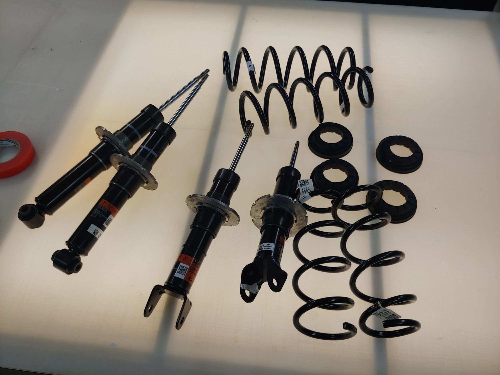

Bought these shock bodies and springs from GM parts dealer

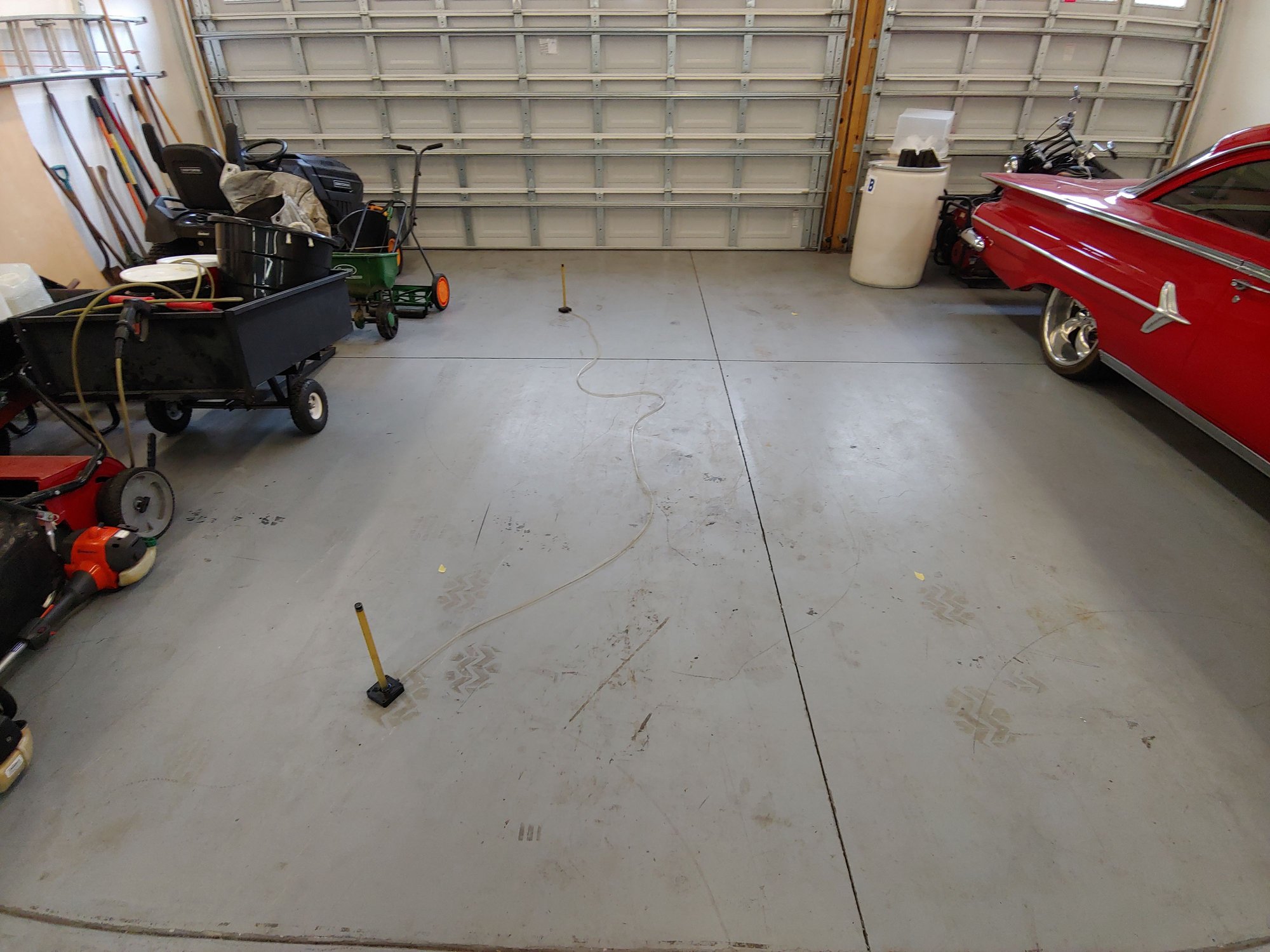

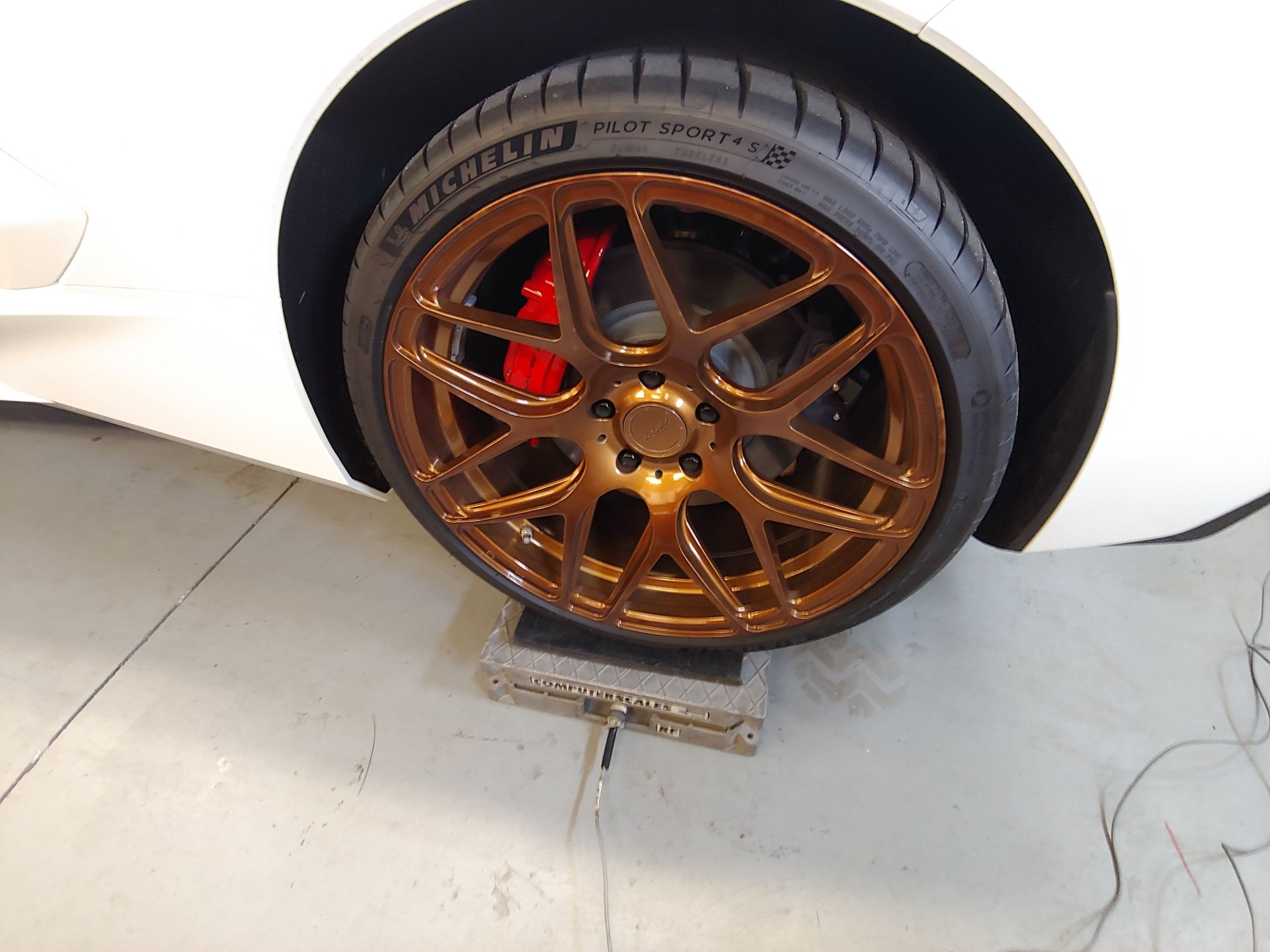

Using water levels, we made sure our garage floor was level

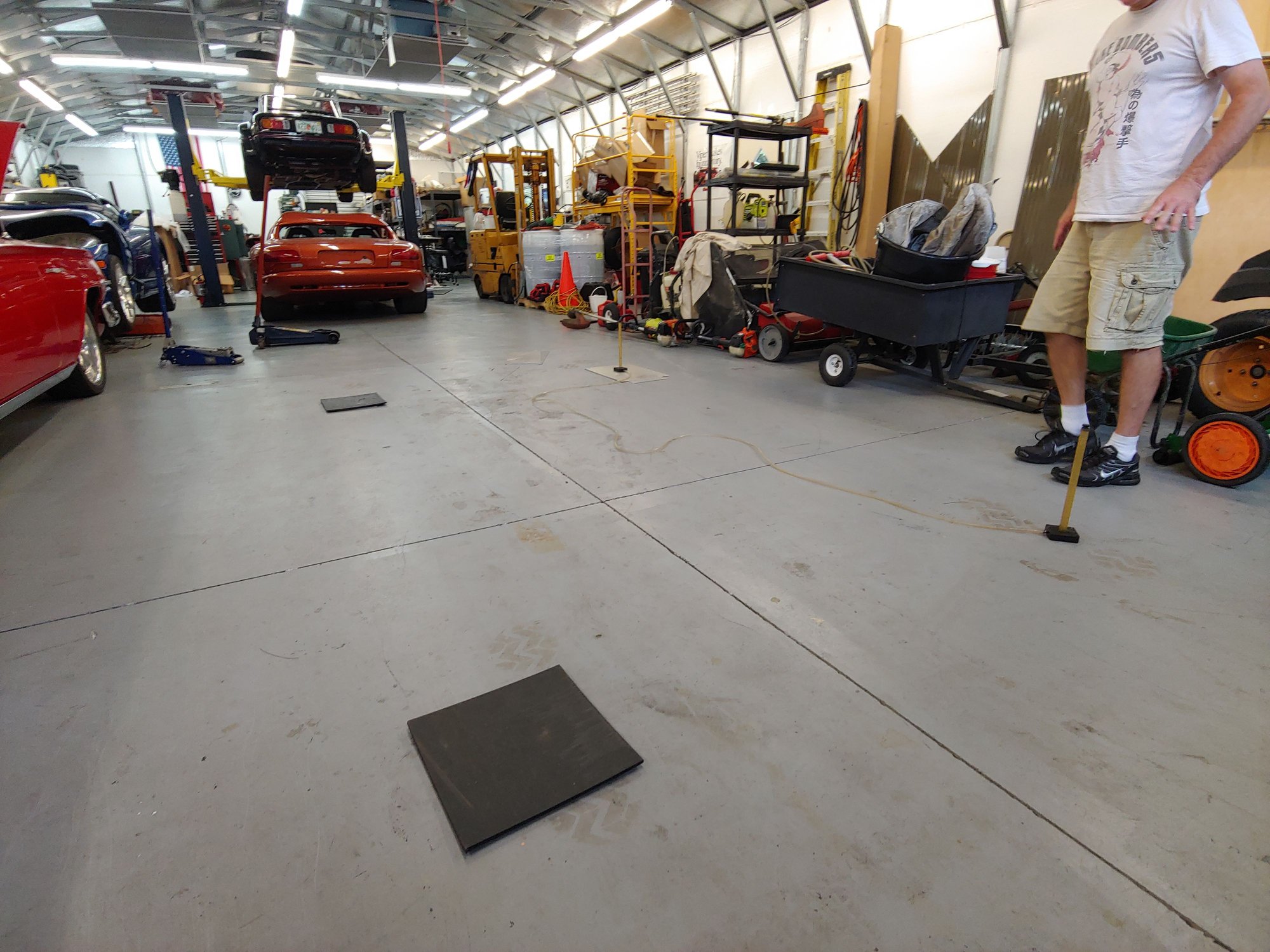

Using "shims" as needed to make sure the scales would be level under the car

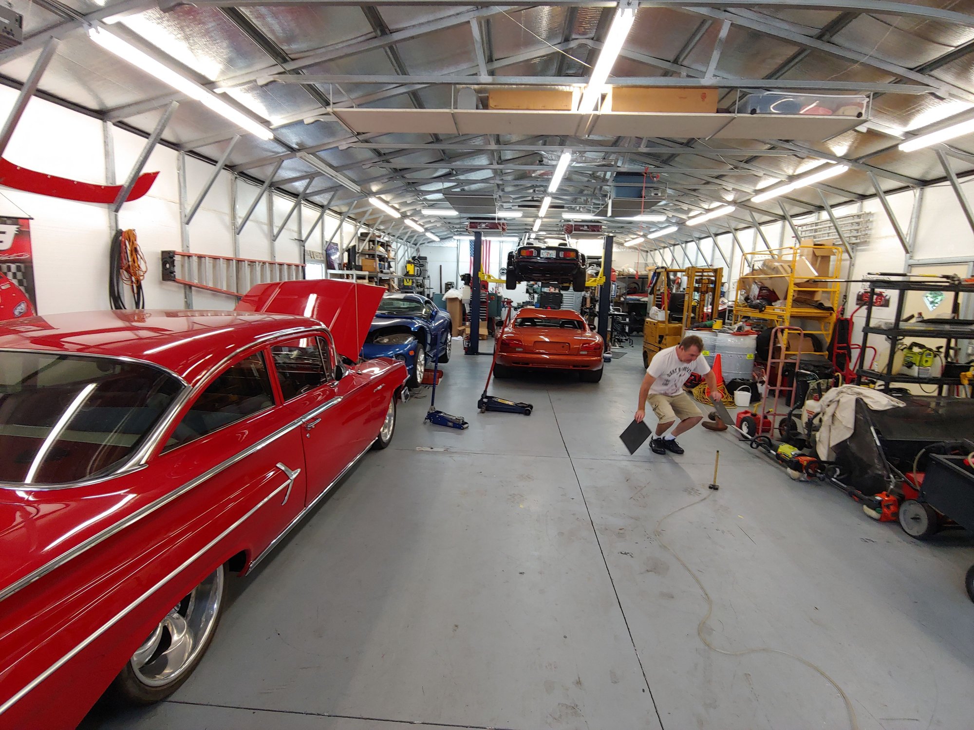

Here is Sean in his home shop setting up for the scales. For those of you wondering.... Sean Roe was the 1989 IMSA Super Car Rookie of the year in a Corvette, and campaigned a Greenwood 383 Corvette for a few years before changing to Vipers before the series ended in 1996. He just re-acquired the Geenwood Corvette after it was totaled in the Golden State Highway races back in the day by the man who bought the car from Sean when he retired it to run the vipers.
Sean Roe measured all for corners to establish a base line for height.

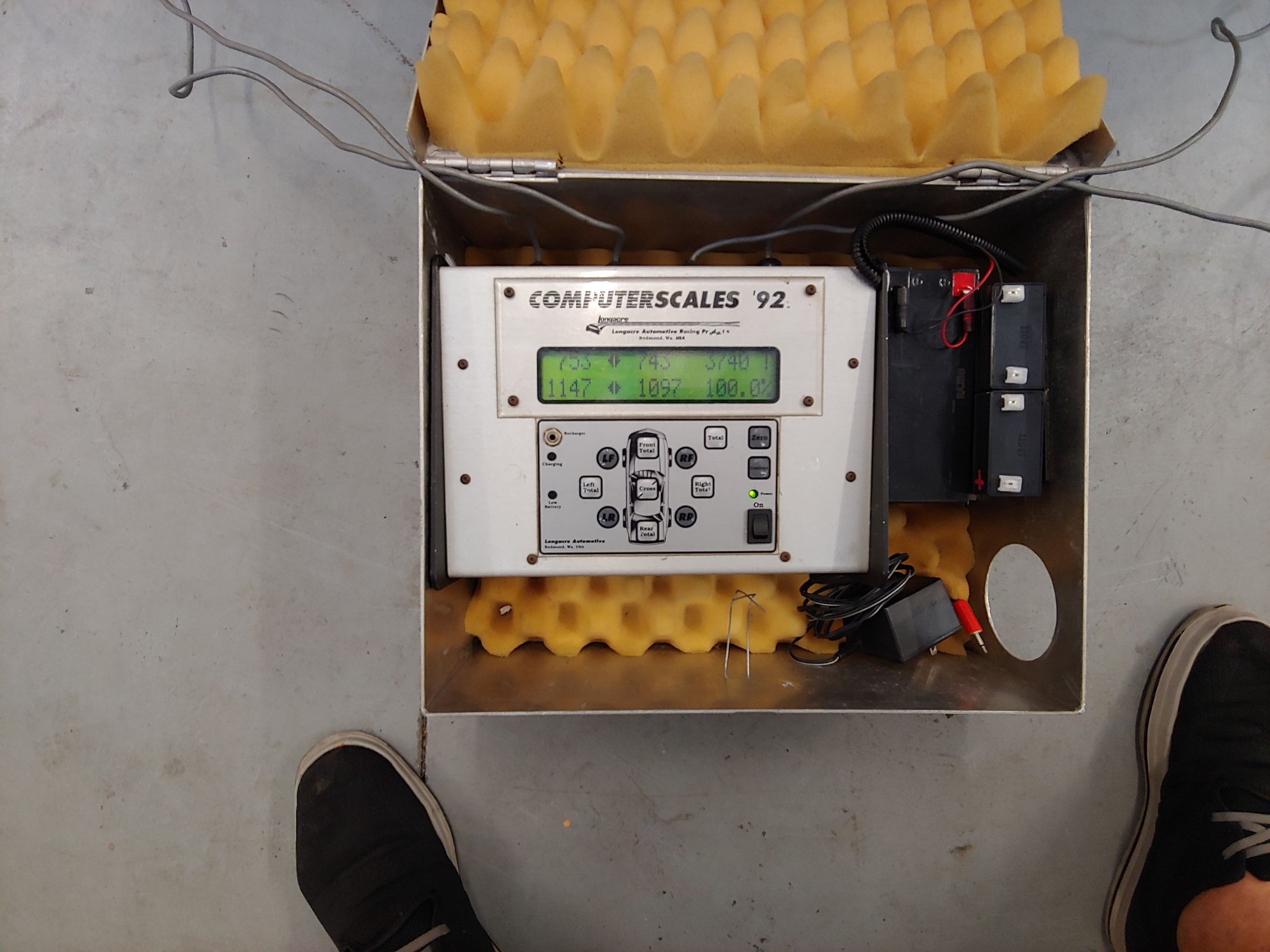

We then gathered our 4 corner weights after we made sure the car was settled down to current ride height.
We then placed the scales under all 4 wheels, and before you "uber" tekno geeks freak out, yes the scales are marked front left or right rear, that did not matter as long as the scales wire leads were plugged in the correct order.
We then recorded our findings for the beginning base line and are now ready to put the new shocks in, but that will be another day this week.

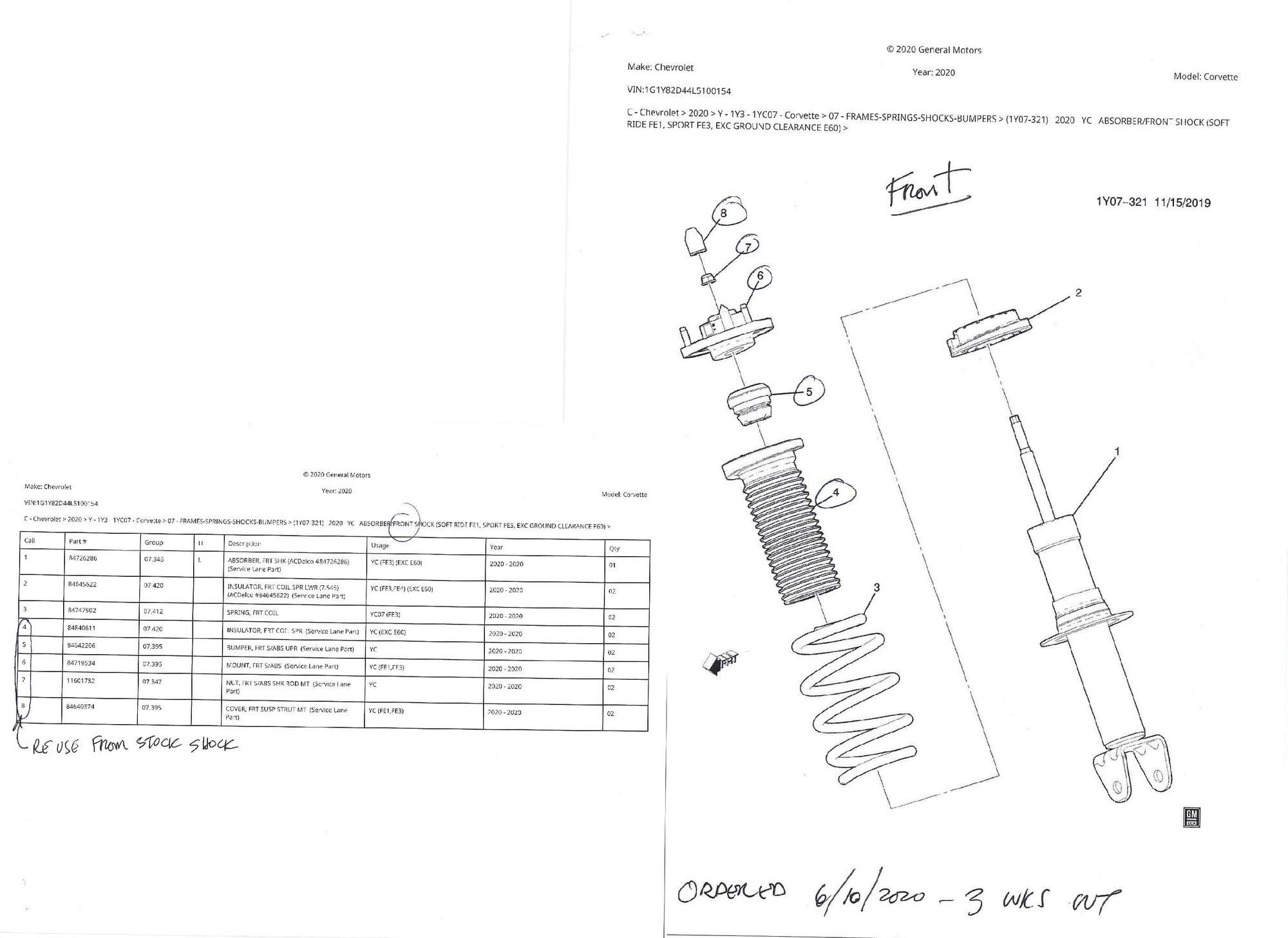

Originally Posted by Jason8416
I would like more info as well. My C8 does not have the front end lift nor the z51 package so I will be doing the same. Do you have the part numbers by chance? Thanks
You only need to buy the parts that are not circled, these are a direct bolt on, you just need to re-use the parts you don't buy from the FE1 shocks to make the FE3 shocks bolt on.

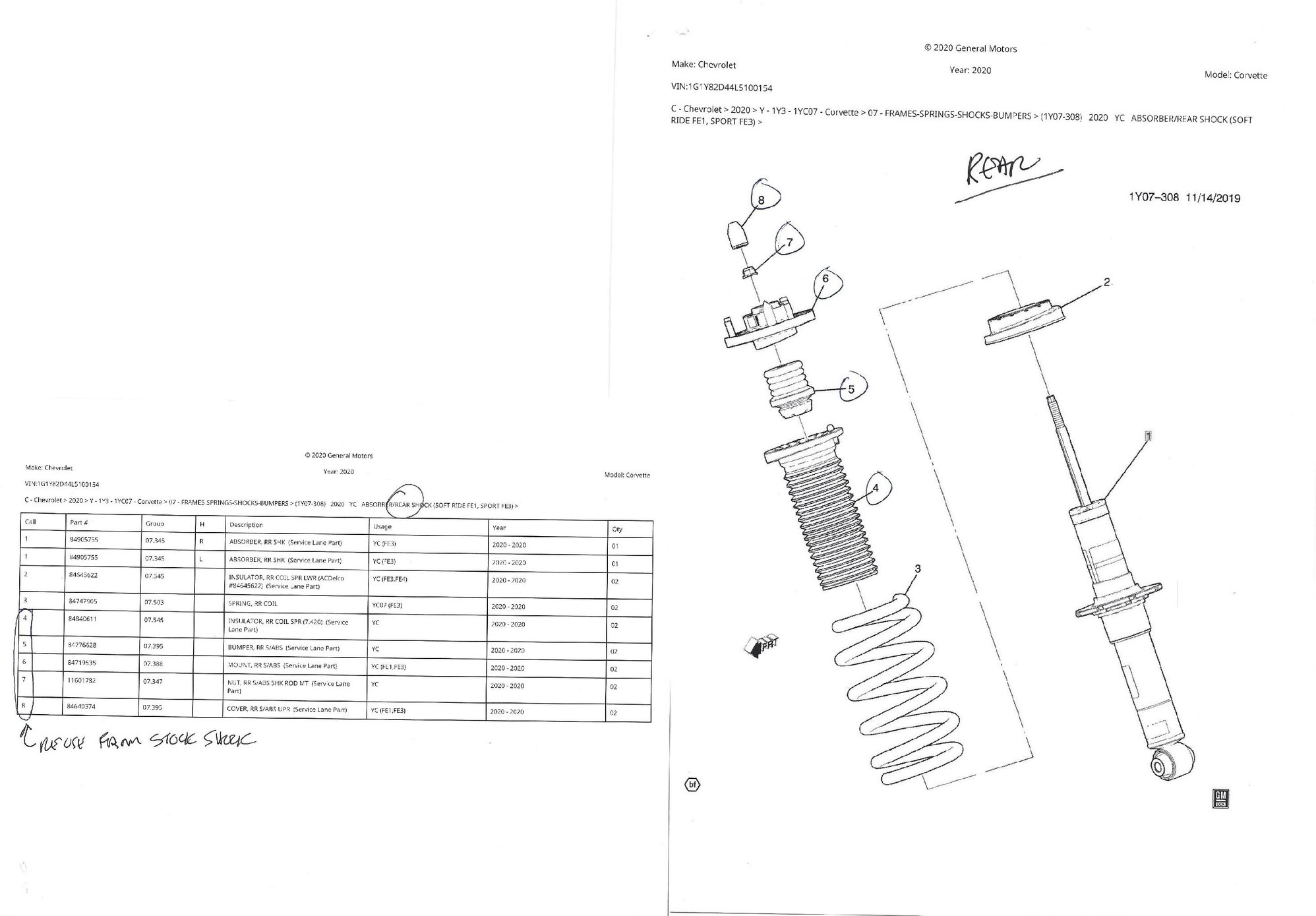

Same for the rear as well
This should be the part numbers

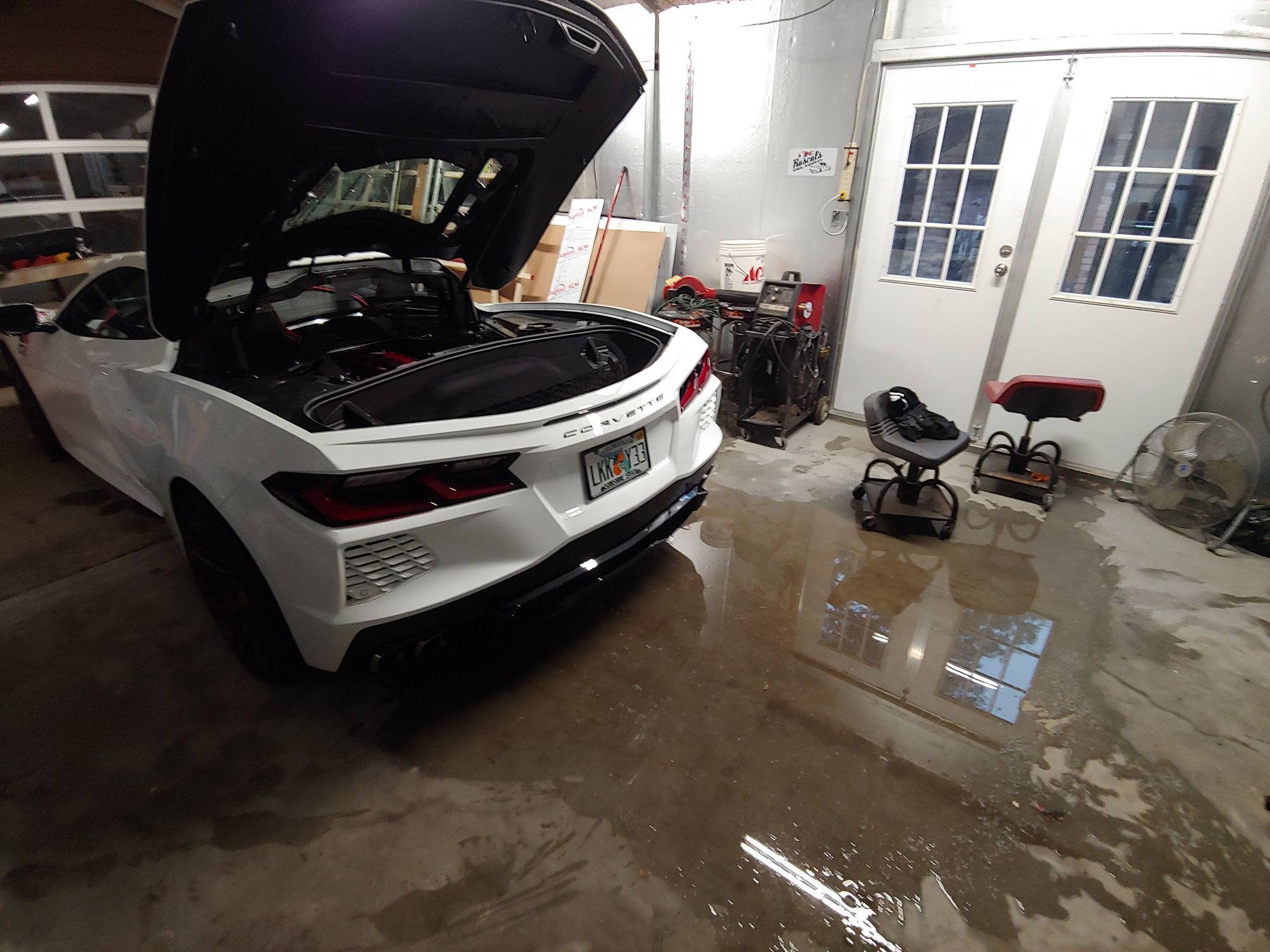

Garage flooded from record rains tonight... So no progress on shocks tonight..., try again on wednesday

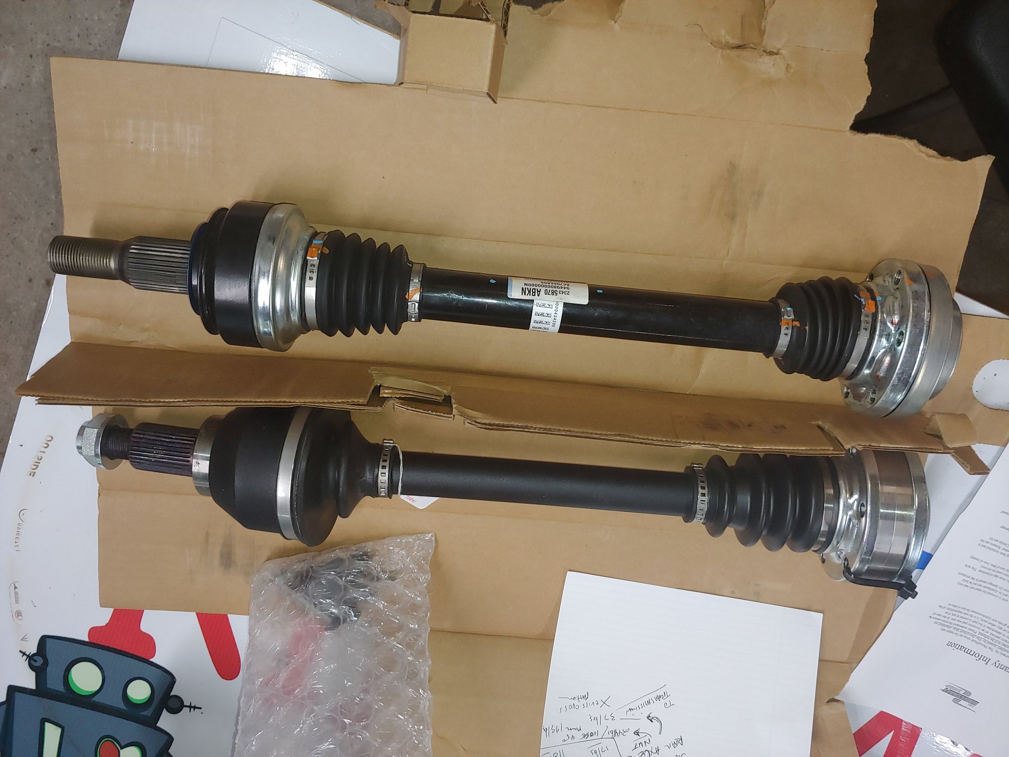

While we are in the rear changing the shocks out, decided to upgrade the rear axles.... New 1400hp axles are way, way beefier, hope that preventative medicine works out

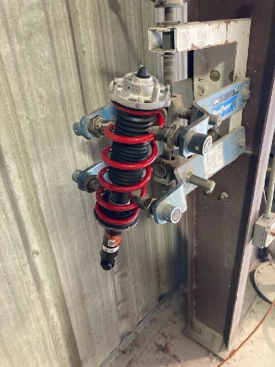

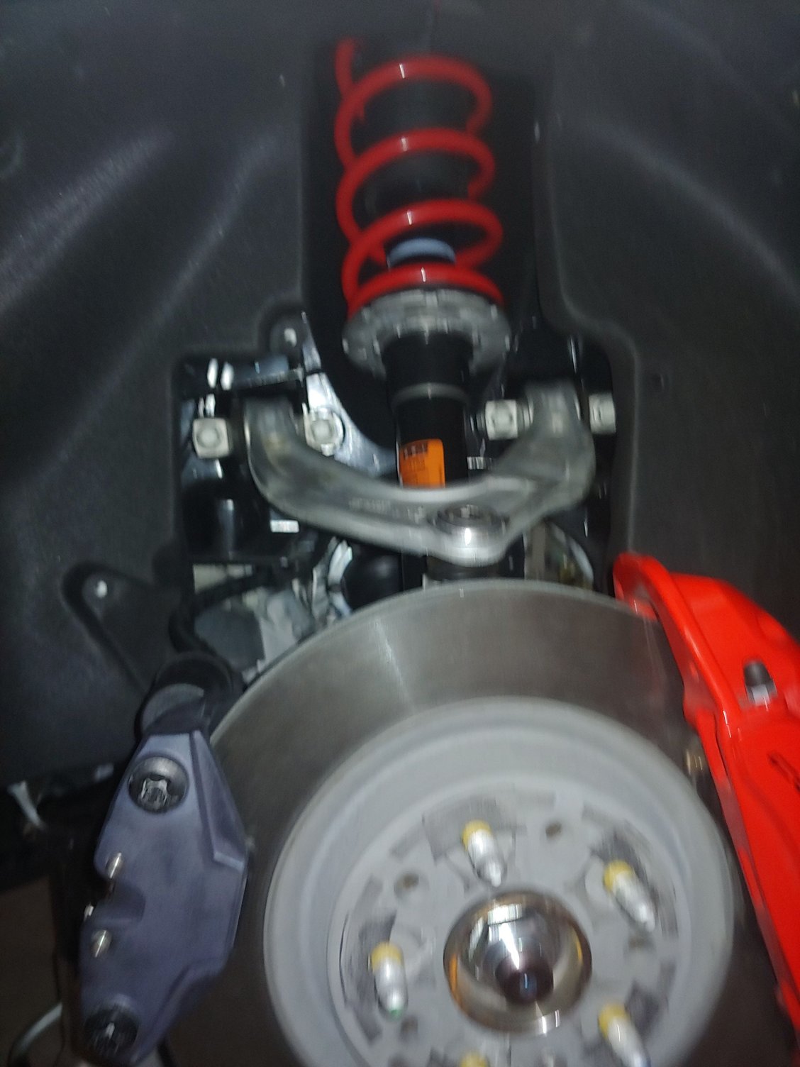

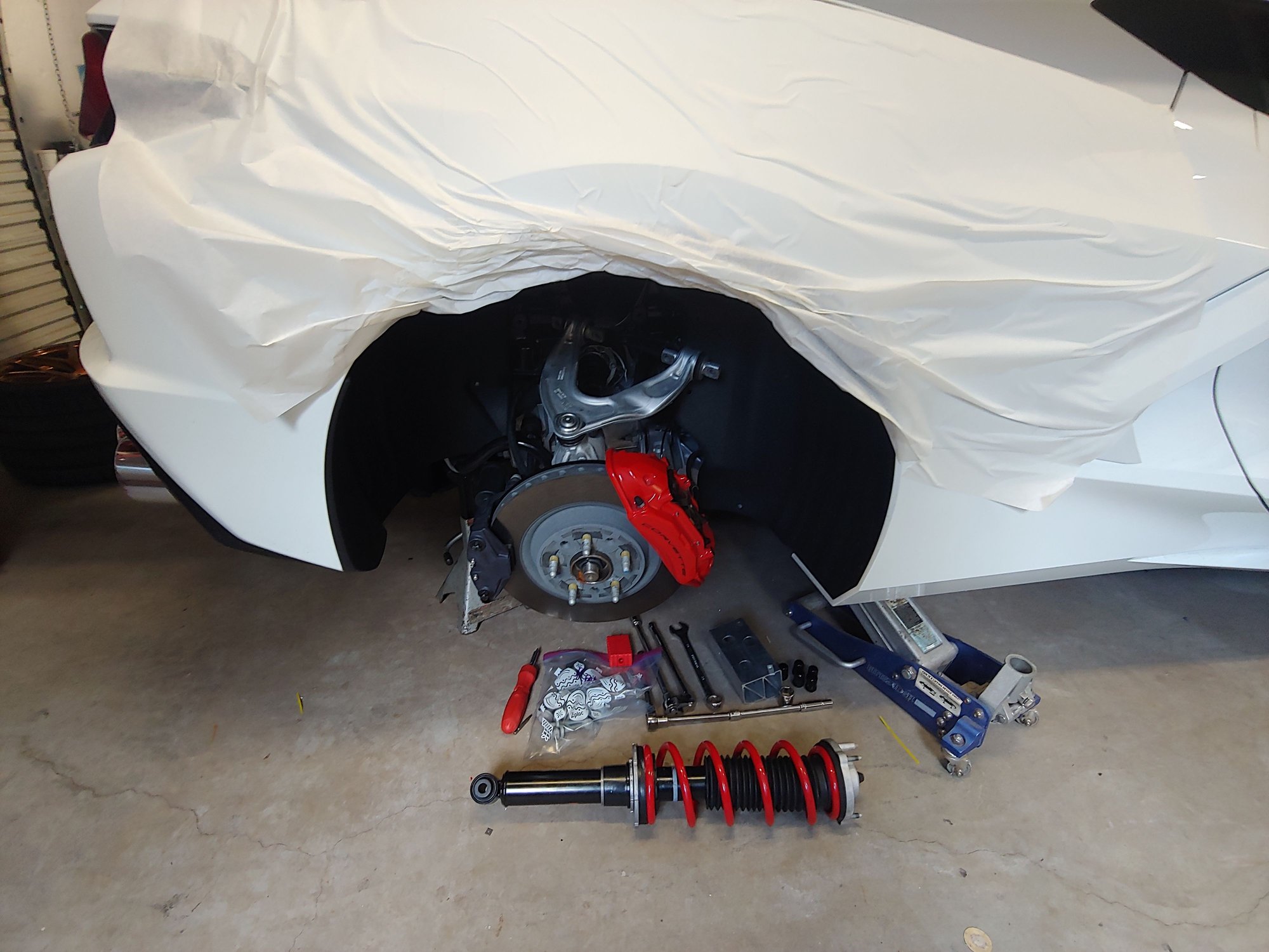

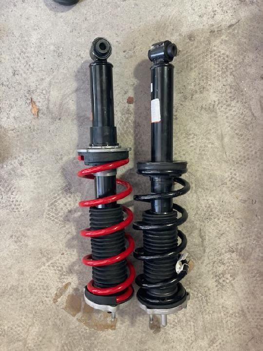

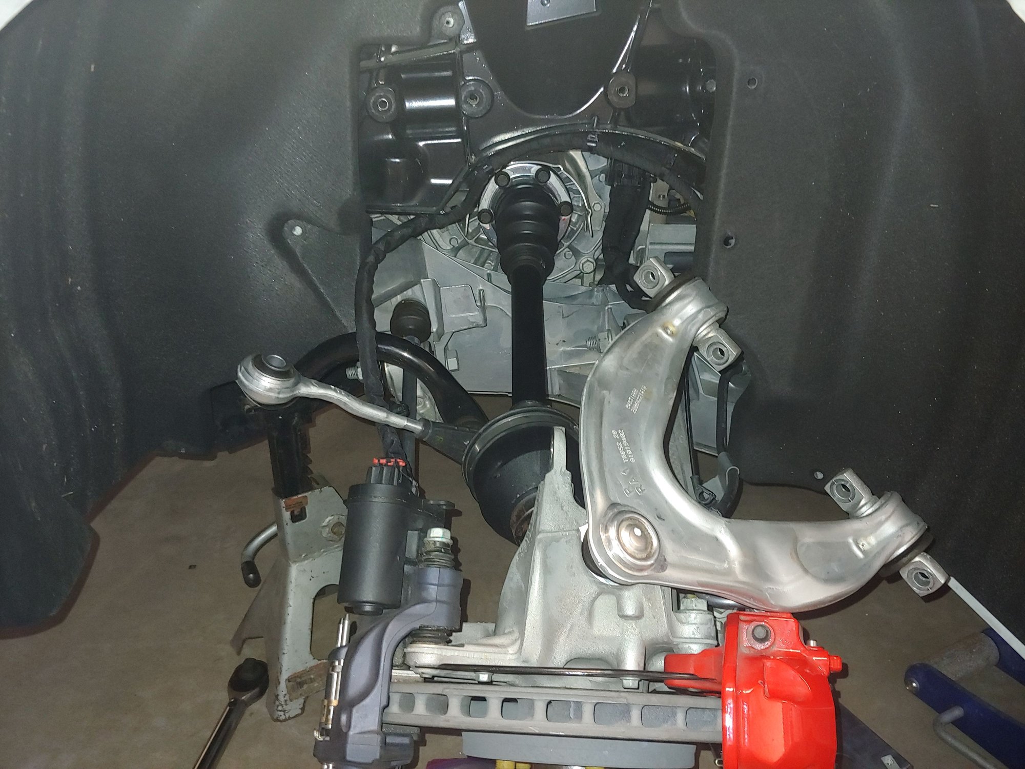

Getting the rears swapped out... Finally
Basically same shock except for the threaded body and the soring rate... I assume the shock is also a little bit different for the FE3 as far as valving? The FE3 shock is the red springs
Using the spring compressor made it alot easier to take the stock FE1 shocks apart and put the FE3 shocks together

Got one rear shock bolted in and all torqued up. Axles went in with no issues. Should have other shock in and
move to the fronts in the morning

I got my parts from a local chevy dealer... they are all installed as of tonight, we will go test them out on Saturday afternoon, but until I get the car re-aligned, we wont' be doing any high speed runs or long distance driving, so after Tuesday, I'll have a better idea of how everything went.... The main thing we learned is you better make sure that the shocks are set correctly for the ride height before you bolt them in... because they are not going to adjust at all while they are installed in the car unless you have a spring compressor and really strong forearms!!

unlike conventional coil over shocks aka QA1's or JW or BC coil over shocks, these GM FE3 coil overs have the rubber isolators top and bottom, and they will restrict the movement of the collars so severally that you basically cannot adjust them without taking them out of the car... that is kind of a bummer.
