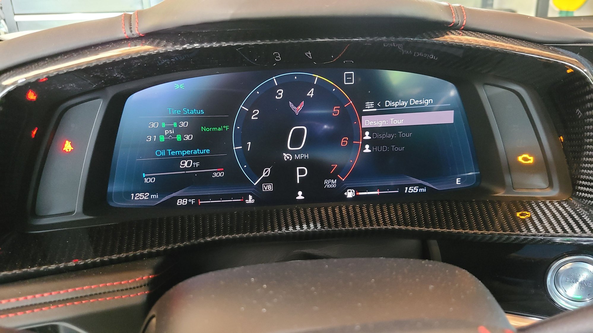

My C8's front digital display is stuck in touring mode even when I turn the dial to other modes like track or sport. The small indicator at bottom of display changes to the mode I dial into but nothing else changes on the display like it used to when I changed to different modes. Is this something that has to do with a setting that needs to be changed or an electrical problem?

There's a setting in the display pages that keeps the display the same, regardless of driving mode...

In your Display Settings - > Change it back to "Linked to drive mode"

Thank you Walter Sobchak, it worked. It really makes a big difference when someone knows what they'er talking about.
