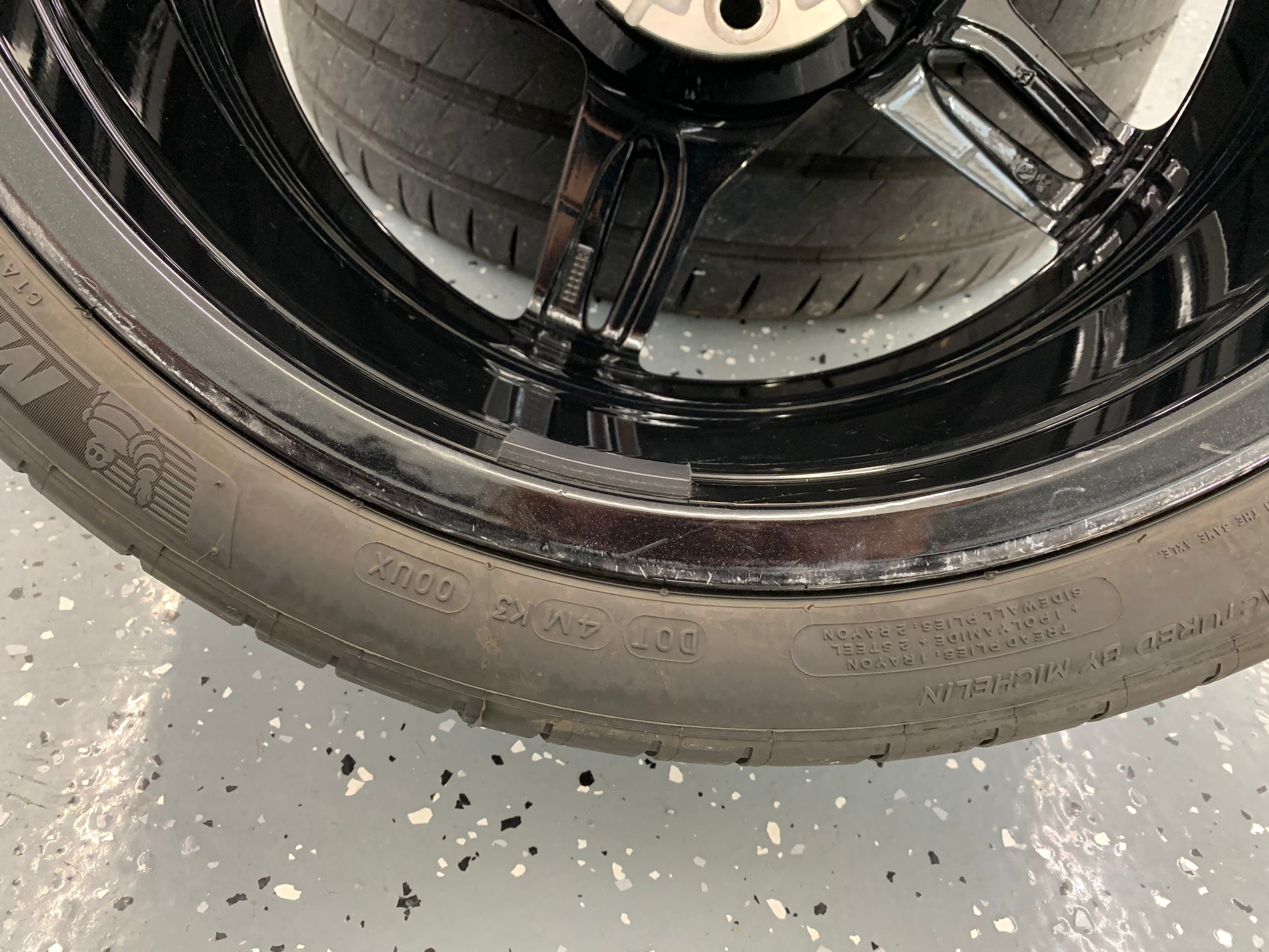

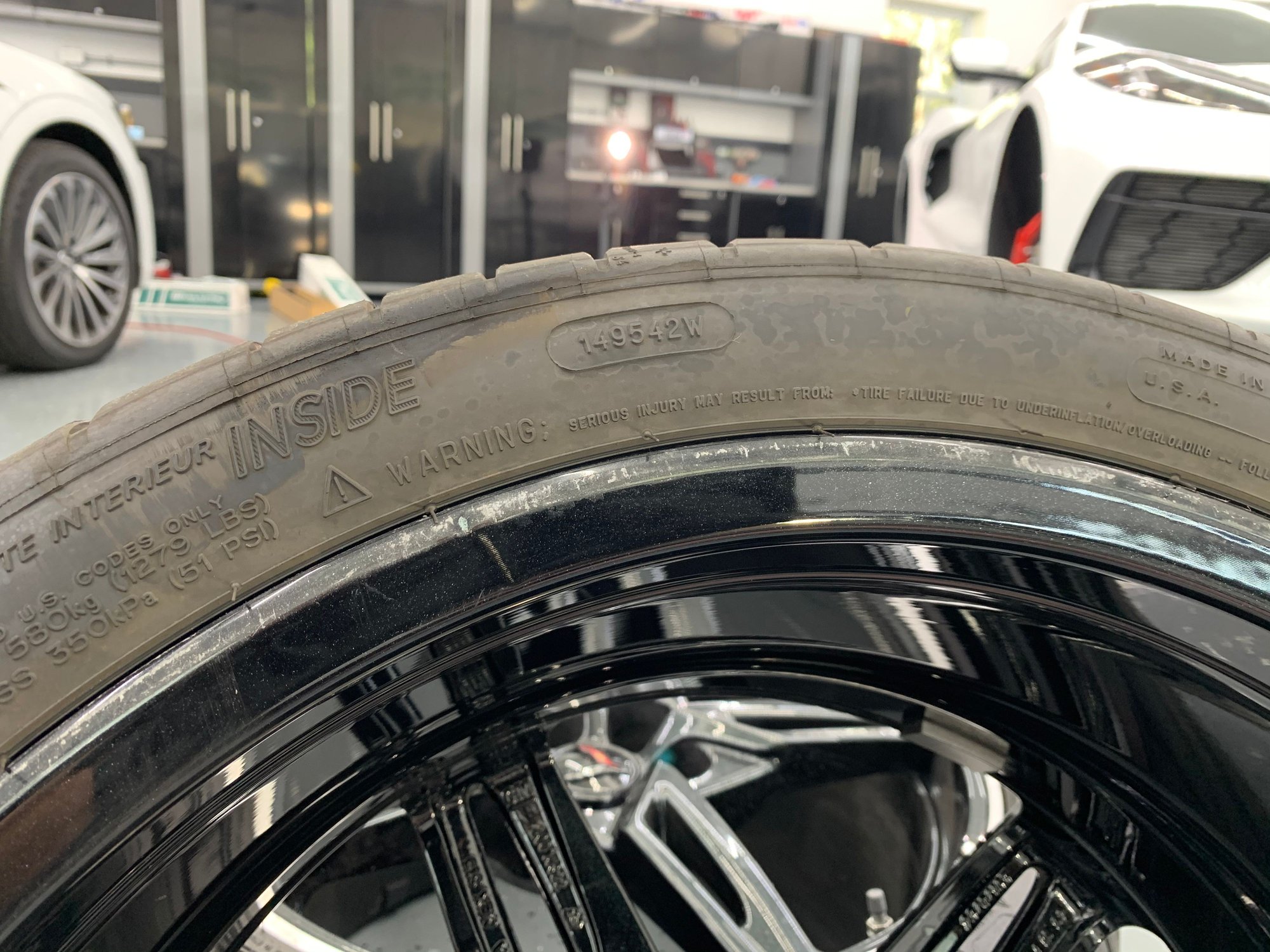

While having my new C8 Ceramic Coated, the detailer advised me that all of my wheels (Carbon Flash Metallic) had significant “...marks on the outer rim of the backside of the wheels. Obviously can’t be seen from the front, but they’re there.” How could this happen on a brand new C8? Does quality matter on a $93k C8 when the defects r out of sight? Would u buy wheels from after market wheel manufacturer if the outer rim of the backside of their wheels had these marks?

Seems as if they were kicked around like a hockey puck before the tires went on.?
The scratches go in all directions.

Carbon Flash "painted" wheels, as per chevy site. Must not be sturdy paint.

That's awful. My 9-year-old oem wheels don't even have any scratches or marks on the inside of the wheels. Unfortunately, they're most likely going to say you didn't bring it up when you took delivery (who checks out the inside of their wheels before signing the paperwork) so you can't prove you didn't drag them around your garage for fun & cause the scratches.

These tires have a good lip on them that would have prevented me from “dragging them around for fun”. These rims were scratched up before the tires were mounted. Just like 19/C7Z indicated, “They we’re kicked around like a hockey puck before the tires were mounted.”

If it was on the front, or bent/gouged on the back, ok. It was probably done mounting the tires.

My car had the same issue; front wheels only. I documented it at 65 miles (pulled off the OEM wheel/tire assemblies to confirm fit of my track set). Told my dealer who found the same issue on another car that was pending delivery. Dealer had the flange area refinished; I was satisfied with the fix.
GM outsources the mounting/balancing to a third party but IMO it should be caught at installation at the assembly plant. My dealer is pretty tight with the appropriate GM quality team and I believe that it was raised as a quality alert.

Had the same issue. I originally thought the scratches when all the way thru to the aluminum but the white scratches are in the clear coat. When you scratch clear, it turns white.
Used a little 1000 grit sand paper and rubbing compount and about 90% better. Not perfect but its acceptable now on the back side.
