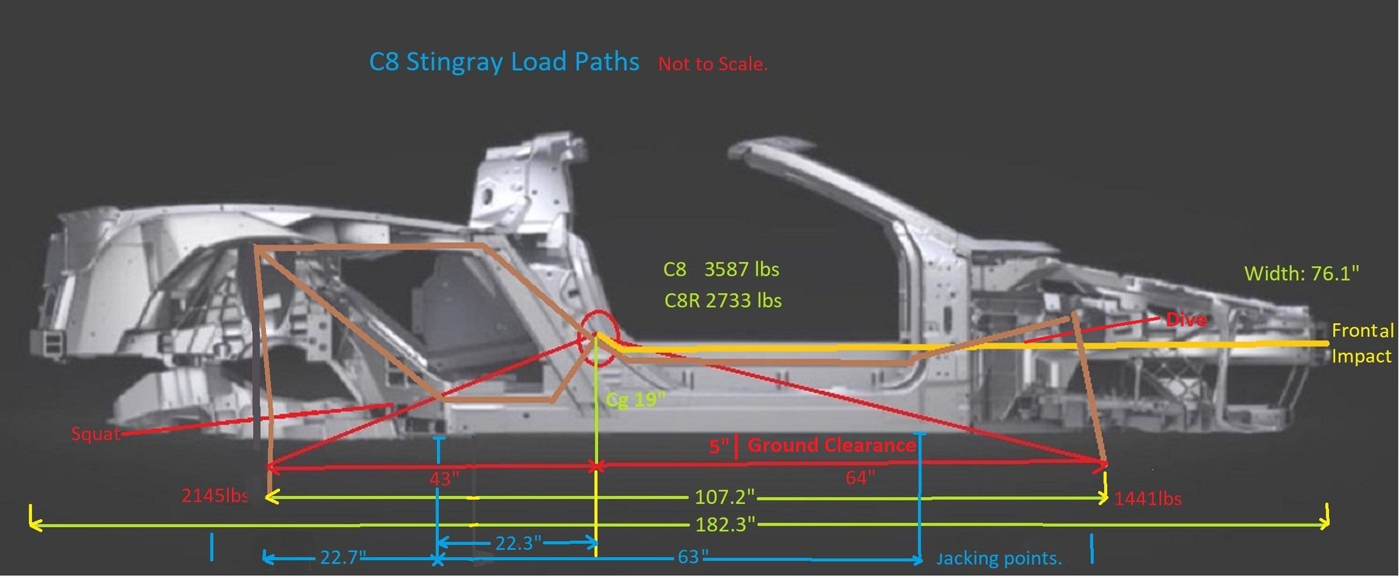

Out of curiosity, what are your thoughts? You obviously have a difference in opinion. Do you know if anyone has measured/calculated the dynamic caster at full compression (where you would likely be under heavy braking just prior to turn in)? It would be interesting to see what the outside tire's camber is when the tire is turned with the suspension under full compression. Starting with 1.75 degrees of static negative camber, I gain 2.1 degrees of negative camber (outside tire) and lose 2.8 degrees of negative camber (inside tire) with 10 degrees of turn and 3.2 inches of compression (splitter on the ground). My point (respectful opinion) was that if the nose rises from the condition I just described (due to acceleration squat), it will take out 2+ degrees of camber. If you are still in the turn, that is bad. If you have all of the C8 suspension pick-up point measurements, you could use a suspension analyzer program to get the data. I remove the coilovers and use sort-of a poor man's pull down rig, degreed turn plates, camber/caster gauge, and a bump steer gage to get my data. As an aside, the angle (in or out) of the steering arms is not the only thing that defines Ackermann. Moving the rack forward or back also produces changes. I run my rack on slugs so I can move it for adjustment - probably not possible with the C8 however.

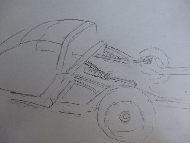

This car was designed by fools. Caster angle gain is the result of anti dive geometry. I don't ever use anti dive or squat geometry. It introduces too many binding forces. God knows what it does to bump steer with all that Monkey motion going on.. There are other ways to control pitch. Despite severe anti dive geometry on this car, the pitch changes are unacceptable. Magnaride is not active, it reacts dynamically only. Heavy and expensive also. Squat geometry actually actually makes thing worse for nose dive. A smaller flywheel lowered the engine yet the Cg was raised because they placed the heavy coil springs (and Magnaride shocks) in that dumb *** casting structure way too high. What a clumsy structure, my God. That Cg heads skywould under braking and the transfer is increased to the front. Mid turn, the platform is horizontal longitudinally and on exit, the dive/squat geometry adversely changes the pitch in reverse to the braking. What front and rear geometry transitions are taking place. Golly.
Turn in uncovers other serious design problems. The short rear axles and provision for front drive requires A arms that are too short. 3' neg camber for track settings is because there is insufficient camber gain in roll. Can't imagine what lat.and long. roll couples are. No wonder Michelin had to provide a 'special' structured tire for this car. Who wants to screw around so much preparing your car for track days.
A simplified lighter stronger and more efficient structure.
Stock structure engine far back

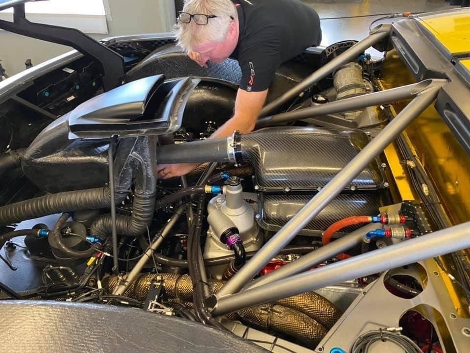

Designing & selling an aftermarket suspension kit that will lower CG and improve handling would be a great goal. Wondering how the C8R is dealing with these issues... Any information available on the C8R?

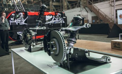

For comparison, here is a link to a view of the Audi R8 rear suspension:
https://images.app.goo.gl/XFzX3w14HmoRcfN88 . .
Here is another R8 view:
https://images.app.goo.gl/X4WLU6aEXjCrJ2nf6

Originally Posted by Jacques Albrecht
Many thx for the link B Stead... This is a monoball kit that is available (pre-order) for the 2020 C8. Designed for the suspension for better car control.
LG MOTORSPORTS C8 Monoball Control Arm Kit.
I'm not familiar with the company or their products. Has anyone dealt with them? On the surface, the kit looks to be well machined.
Complete kit for 8 control arms.
We've been around since the late 80's. We're not currently racing but most years have been compromised of a shop, a parts company and a race team. Monoball control arm bushings are eliminating rubber bushings at connection points that deflect under cornering loads. I've driven about 30 miles on the street with prototype monoballs/sway bars on the car it was perfectly compliant but the steering felt unbelievably more sharp, connected and precise. We've made this product for C5/C6/C7 so we are familiar with the product but on the C8 we put a huge focus on fitment to make sure it's a smooth process for the end user. We still plan to install the into the arms for the customer at no additional cost because while it seems straightforward and easy there's a number of ways a pretty capable customer can mess these up trying to press them into the arms. Here's a picture of the car running at COTA and an old pic of the ALMS car and you can see a Corvette Racing car in the background.
