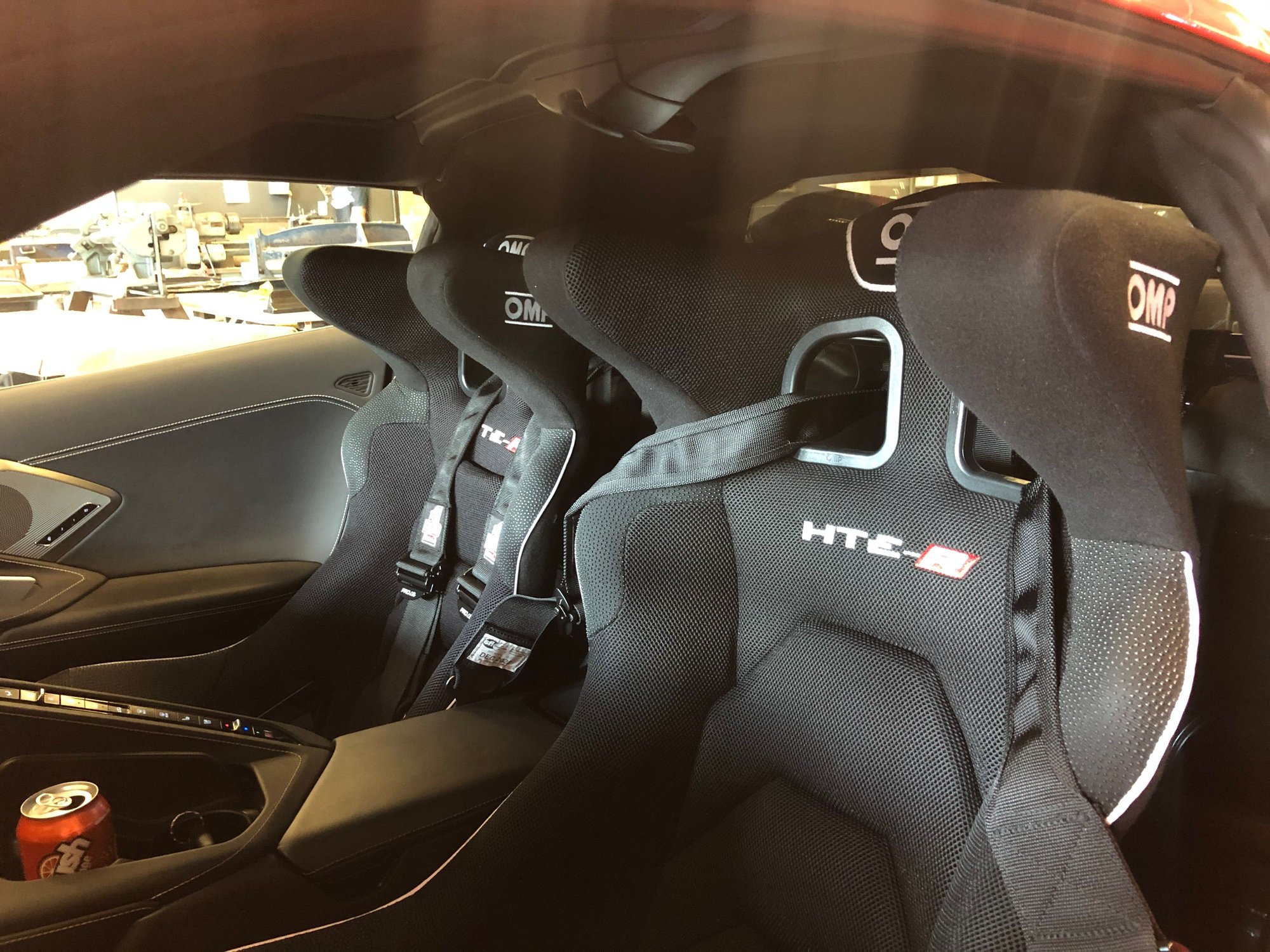

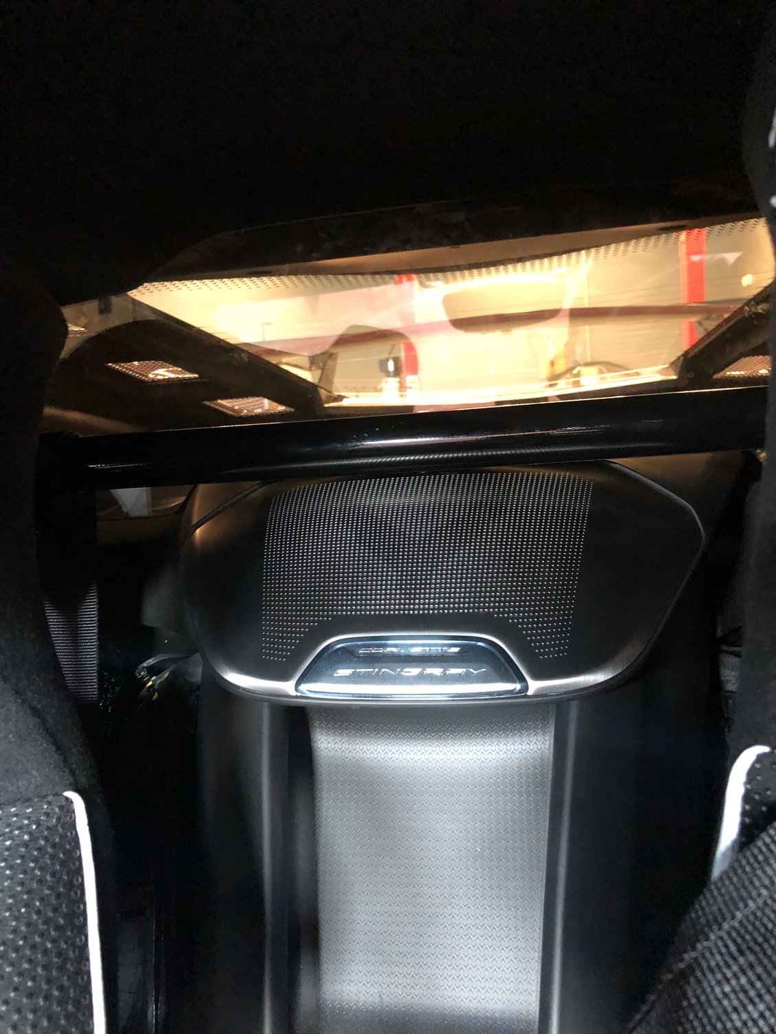

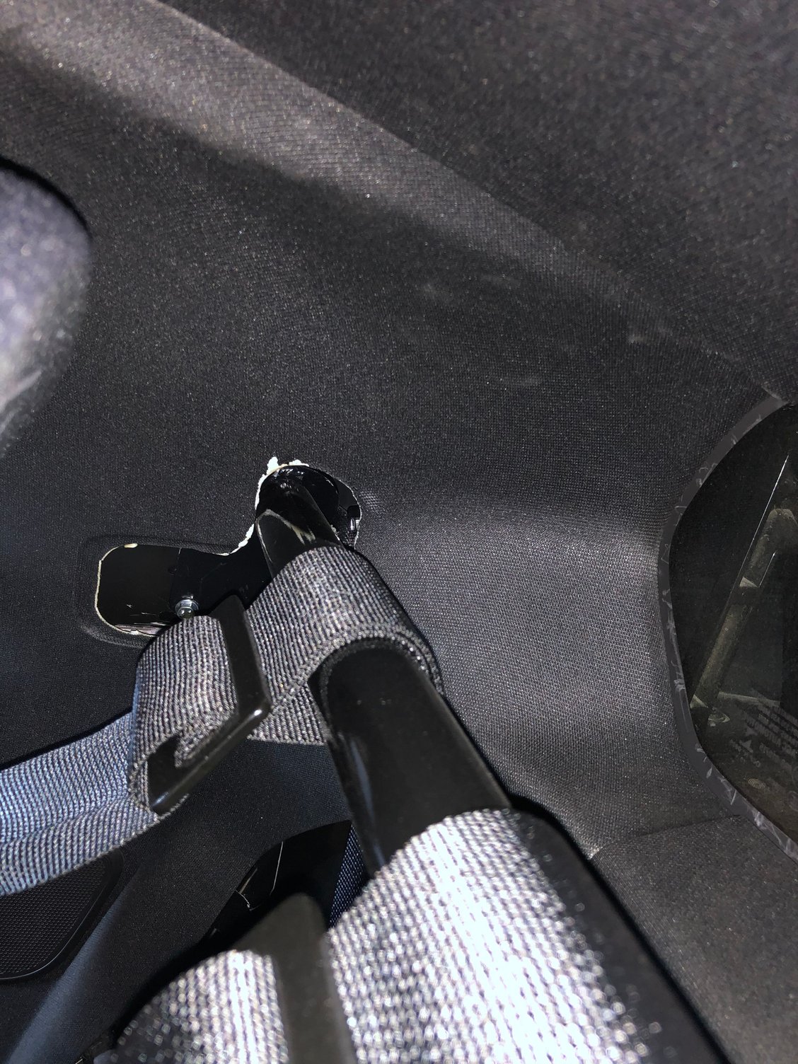

Originally Posted by Rob Willis
Guessing this might be a bit more difficult to develop with the new layout?
It wasn't bad. Took us a few hours start to finish to make one for our car from scratch.

Originally Posted by pistolpete817
Dane@LGmotors Pictures? Price?
Same as C7 450. Cuts can be a lot cleaner, this was done in the night before a test day.

Originally Posted by Poor-sha
Are those the HTE-R XL or regular? What seat bracket did you use? Asking for a friend
I ordered XL's and driver seat definitely is but the passenger feels like a regular. OMP L Brackets & Sliders. Built a low pro mounting bracket in house. I'll post a pic when I get my phone fixed, shattered the screen karting last night.
